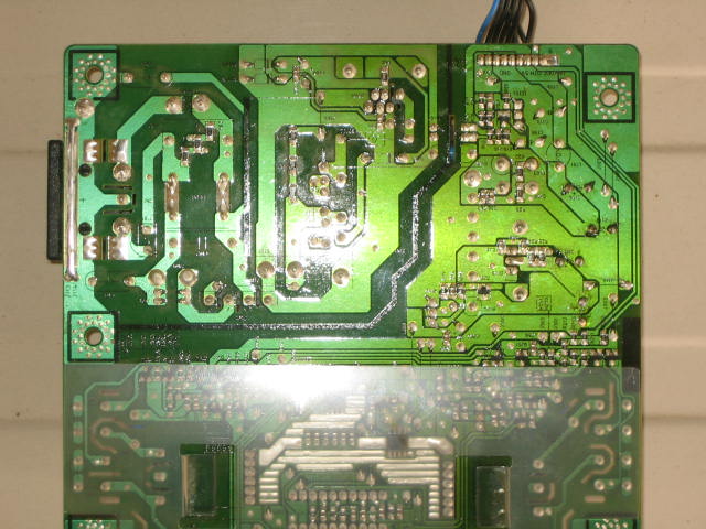

    Dear Brothers,
    This is another monitor Samsung Samtron 74V it came in with two capacitors bad, the capacitors has been replaced but the problem now is that the backlight is always on when I power off from the panel, unless I put it off from the mains before the screen goes off.
    Tama

    Check your work. It is most likely a bit of solder shorted to another path when you replaced the capacitors.

      This morning, when put on the monitor it flash with back lights on and went off.
      I have checked the solder which I did but all look good.

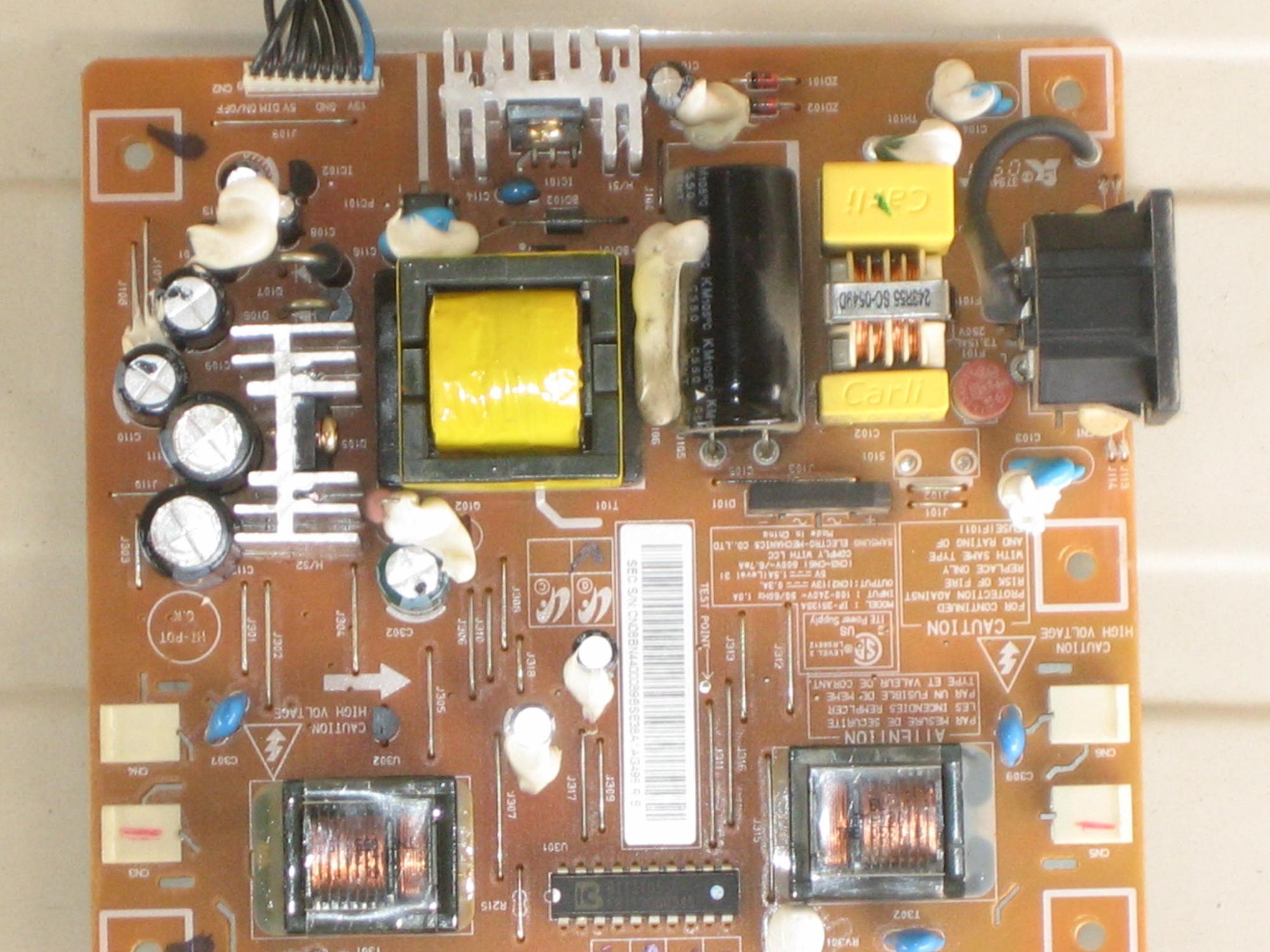

        Sounds like possibly "2 Seconds to Black"
        https://www.badcaps.net/forum/showthread.php?t=10419
        Most on the forums here recommend replacing all of the capacitors on the power supply board (with exception of the large capacitor). If two of them were showing signs of failure, some of the others may be failed and not showing it, or on their way to failing.

          Thanks for your help; I will try to replaces all the capacitors as you said and let you know the out come of.

            Bad capacitors is just one of several causes of "2 Seconds to Black." Others include bad ccfl's and / or wiring to them, bad transformers, etc. They are listed in detail in the link from my last post. Make sure you are replacing the capacitors with good quality low ESR capacitors, anything else will either not work or fail quickly. A list of good quality low ESR capacitors can be found in the following link:
            https://www.badcaps.net/forum/showthread.php?t=2280
