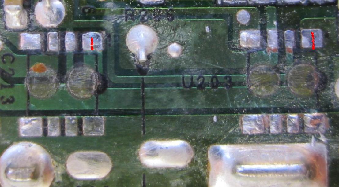

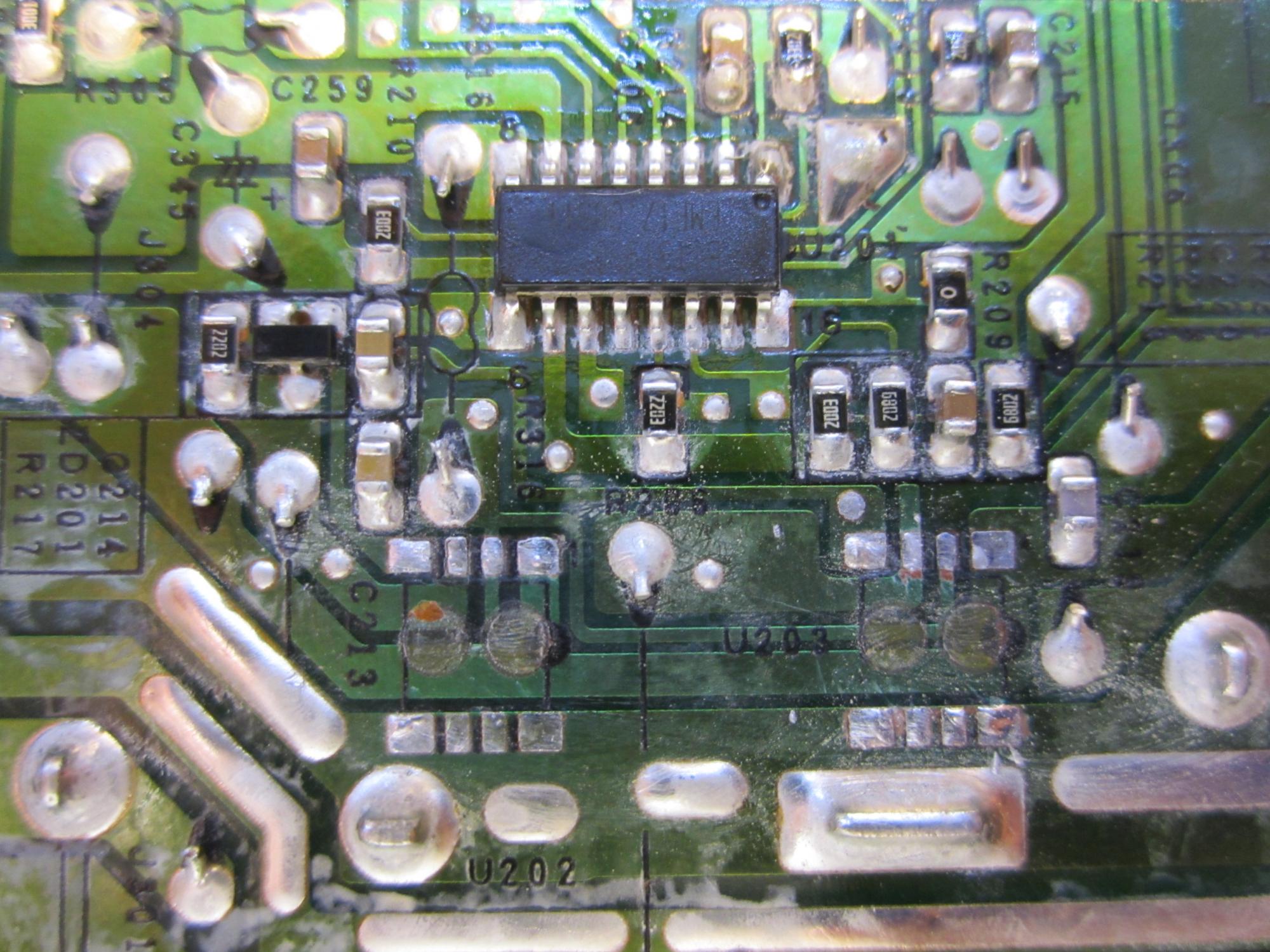

    On this board what is the orientation of the two 8-pin MOSFETs (U202 U203) below the 16 pin IC? Where does pin 1 go?
    Thanks,
  • retiredcaps
    • Apr 2010
    • 9271
    Re: MOSFET orientation
    The black half moon dot is your indicator to lining up the chip. On your replacement chip, there should be similar notch. If not, pin 1 is marked in red.
    Of course, doublecheck the datasheet for confirmation.
      Thank you I appreciate the quick reply,
