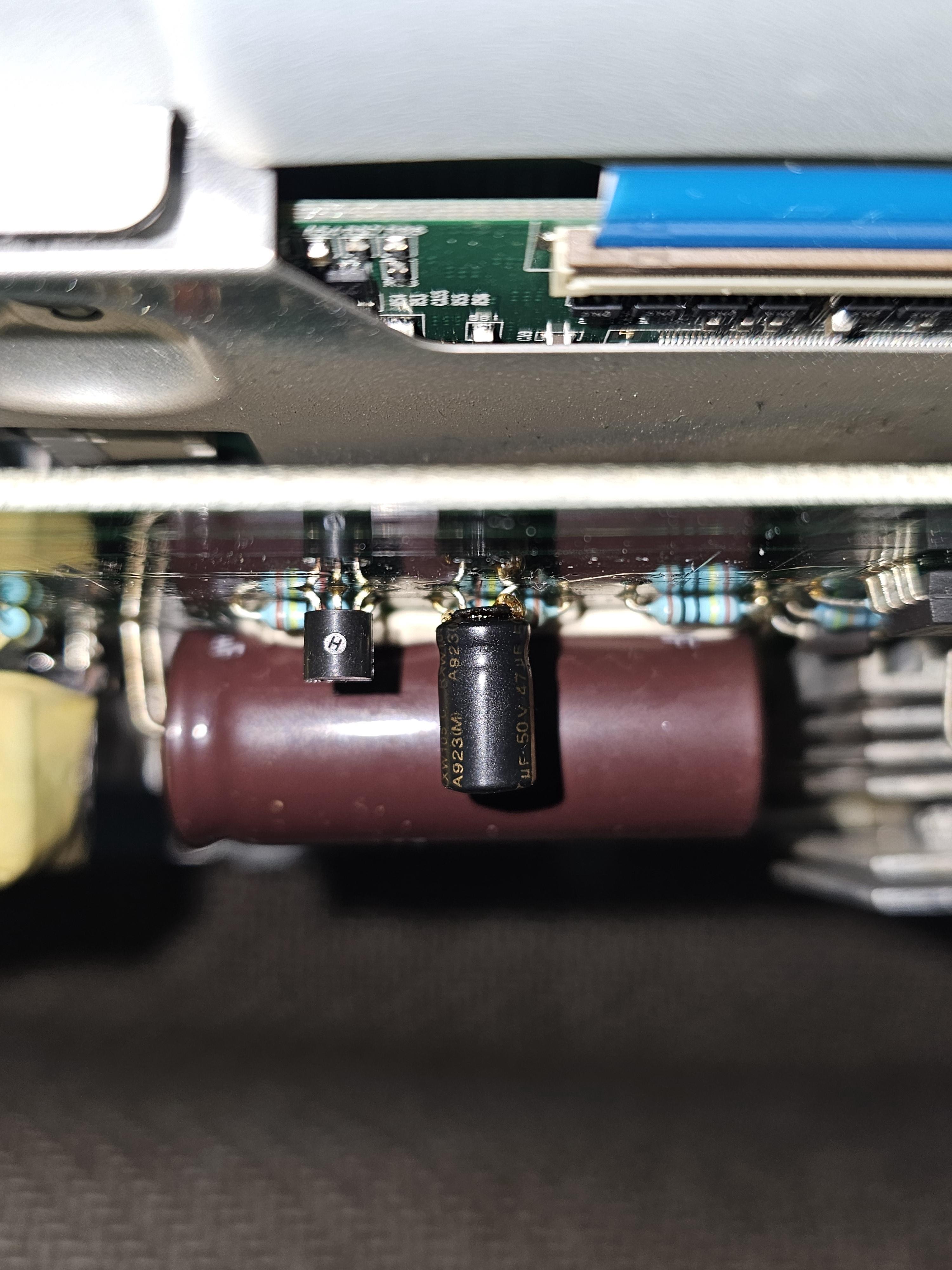

              Hi, have same monitor it was working normally until I open it to clean with brush, nothing special and it was a bit dusty from inside. No bad caps or any burns, and when I assemble it it won't turn On at all, no green light no anything...Not sure if problem is in flex cable that connects front buttons or something else...Don't have multimeter to measure.

                EDIT:
                Now when I was looking on the downside of caps I found that on PSU section one cap leaked, could only that cap be the cause of monitor not to power on ?

                  #108
                  Yes, it could be.
                  The capacitor costs nearly nothing ( 5 for 1 € )
                  You should try to change it ( or make it done by someone who could

                    #109
                    I will replace them all, I already ordered rubycon/nichicon low esr caps, don't know why they didn't put low esr on power supply... That leaked one is lelon they are reeealy garbage caps just like capxon, and hopefully after recap it will work. I really didn't expect dead monitor after just going with brush a little to clean dust of everything (monitor was never opened) I didn't even disconnect any of boards or anything like that and when I assemble it completely dead. First I was thinking of that flex cable for buttons, but it's not garbage and can't damage just like that I was really carefully when I disassemble the monitor didn't stretch anything or force anything. So my only suspect was that cap and one that is near I think same values, it got funny color just like this one but it didn't leak.

                      #110
                      Monitor fixed. It was caps on PSU, I replaced them all with quality ones rubycon/nichicon, and one mosfet died probably because of one really dead(burned) capacitor.
