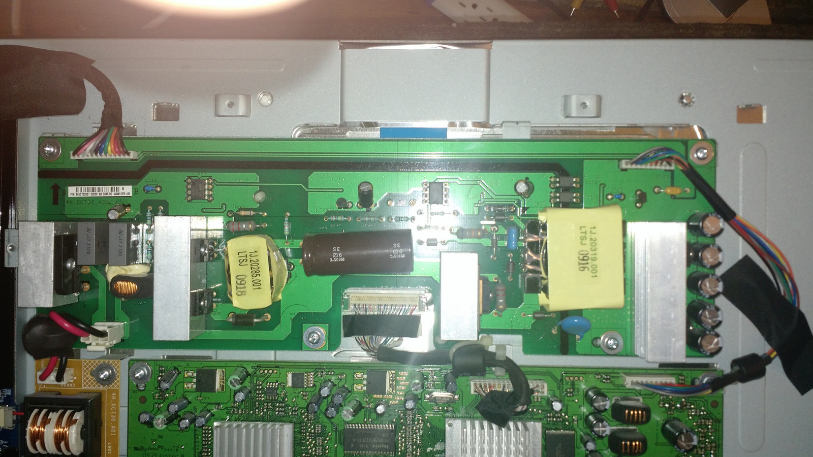

hey, I cleaned up the power supply board (there was a lot of dust at the end, I have this monitor bought at its exit on market, 2008 september so it's 9 years old and It's normal to find some dust solidificated)...then I tried to give current and the power on button LIGHT ON!
I was happy to see that so I decided to reassembly all and now monitor works perfectly! I'm so happy, this was the first time that I tear down my Dell and I succeded in my mission!
I'm so happy now, vertical lines appears like it do lately but after about ten minutes they disappear and the monitor works perfectly!

I am also trying to repair a Dell 2408WFPb. I have the same problem as mentioned in one of the previous posts. A led light that blinks one time and the monitor won't turn on. The power supply is OK, because CN701 has about 24V on the output. The reason that the inverter board doesn't power on is simple. The first black wire on CN701 is the ON/OFF signal and it's 0V.
I started to suspect the mainboard and I found a way to power up this board. It seems like there are two main sections on it. Each section has a big chip, a crystal and a voltage regulator. First, I measured the section at the side where the power supply cable comes in. The crystal has a perfect sine wave and the voltage regulator shows a perfect 1.8V. But there is no voltage on the second crystal and voltage regulator.

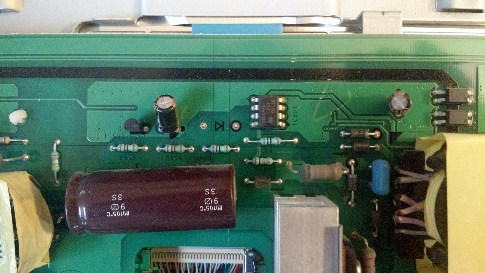

bicycle's schematic is helpful, but my board might be slightly different, u601 is a NCP1203 for instance. An odd note- -D608 is missing, but so is the same diode on Sparrow's pictures. The schematic doesn't show CN702 which goes to the lamp high voltage supplies. is there a on/off control wire going over there?
Power on LED flashes when AC applied. PSU output at CN701 is 23 volts, Vcc for U601/6 is 15v, U601/1 adj= 0.99v, u601/2 FB is 1.00v. All good. A bypass capacitor on one IC on the main CPU board is 2.5volts. The opto isolators IC652 and IC602 appear to be off, U652/4 is 15volts, U602/4 is 1.00 volts, suggesting power is not commanded off?

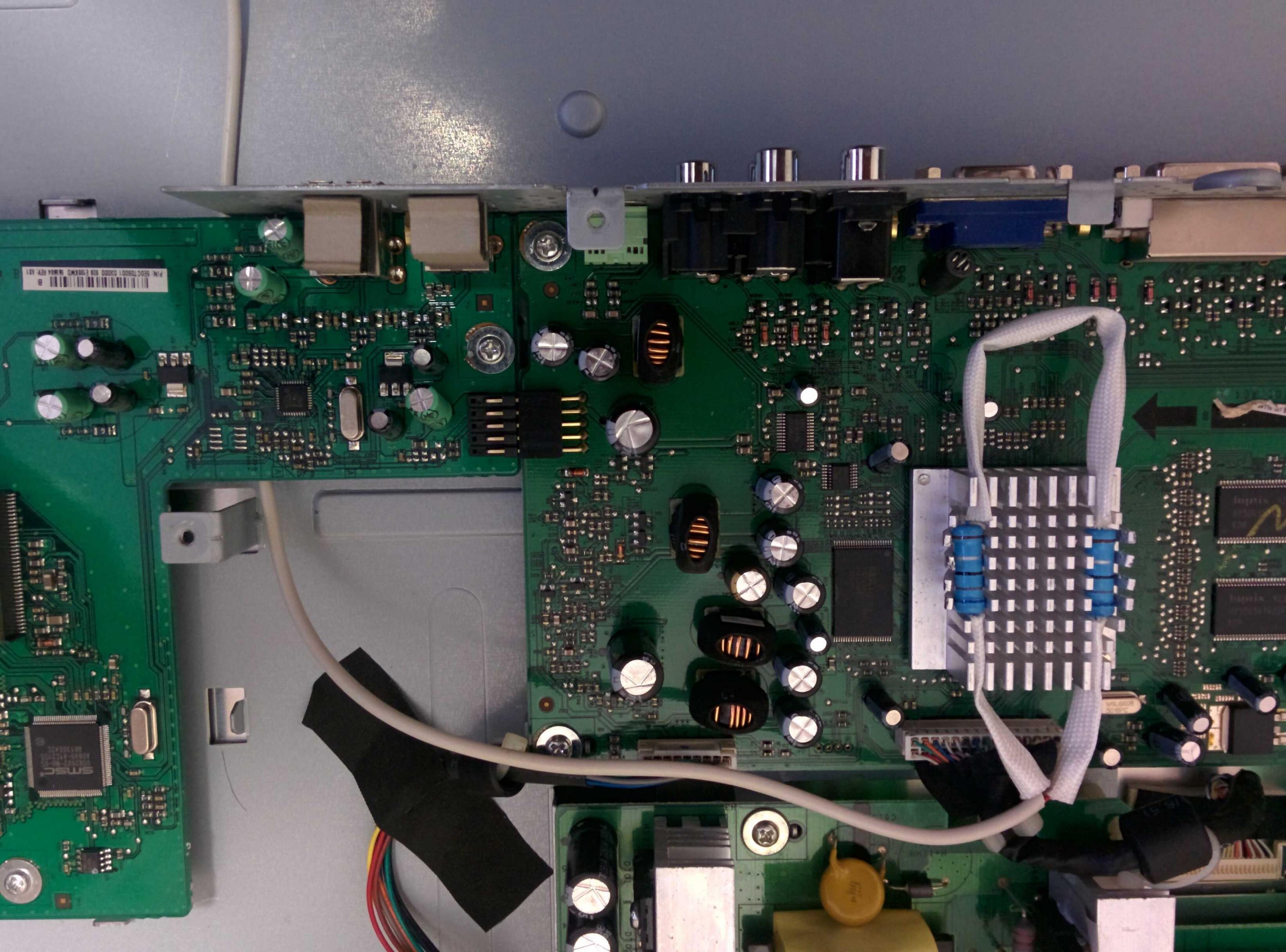

Hack uses two resistors powered by a USB 5V source to heat up the heatsink of the BGA chip. The basics of the USB heater design are:
• 2 X 3W, 6.8 ohm connected in series to USB source
• Heat resistant sleeve where it contacts the heatsink
• V = I X R, therefore that current in the circuit is about 0.37A, below the 0.5A specification of a USB port
• Heating power = V X I = 1.8 watts between the two resistors, so I chose 3W rated resistors for adequate safety margin
The implementation was as follows:
• Old USB cable, but doubled up the line to reduce line resistance (Data+ and Data- cable used for power and neutral respectively)
• Heat sleeves to resistors, between resistors and also from resistors
• When circuit is soldered, do a trial with a 5V source to confirm that resistors heat up
• Outer heatsink fins bent outwards to create space for resistors. Resistors in contact with heatsink and just held in place by friction.
• Ensure no bare wire contact with heat sink
• USB cable routed under boards
• Cut made in right protective stainless steel cover and also screen back cover to allow access for USB cable
• I would strongly recommend to connect power to the USB cable to confirm that the heatsink is being heated up before reassembling the monitor
I attach some photos to show final implementation. To use it, either connect the "new" USB to a 5V source (a phone charger works) for a few minutes. I find that 2-3 minutes is all that is required on mine. Alternatively, power up the monitor - despite the screen not lighting up, there is power to the USB ports which can be used to heat up the heatsink.
Then power down the monitor at the mains and reapply power to the monitor and it should fire up. The reapplication of power is a necessary step as just heating the heatsink with power turned on to the monitor will NOT light up the screen
