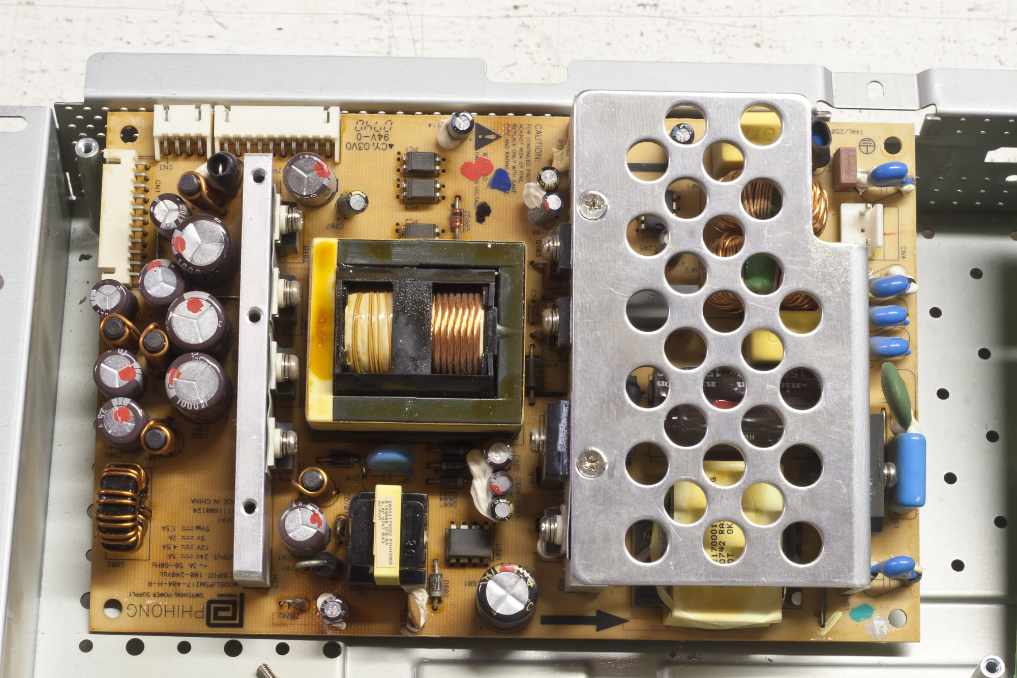

    Hello. I have read a few posts here about it and of course I have the same problem. The other models I read about are a different model and Pics show the Power Supply Board to be a bit different. I have had the same problems as the other posts for a few years. Worked fine for several years then Every time I turned off the Monitor it took 15 mins to start once powering up the CPU. Then Progressively it took up to 3 or even 3 hrs to power up. Around August this summer I decided to just leave it on all the time and not power it off since it was a Headache to get it to power back up. Well about a week ago got home around 10:00 PM and the CPU running but Monitor was out. The Amber and or Blue Light to show if power is on iss not blue anymore. Here is how it goes. When the Monitor was acting up it would only flick an amber light if one connected and disconnected the HDMI line coming from the Video Card. Every once in a while in the past once connecting and disconnecting the HDMI it would make the power come on or make the blue light come on and remain on. Now " No Power at all after waiting hours..... but the light will still flicker to amber if one disconnects and Reconnects the HDMI line to the Monitor. From all I read I am assuming it is the Capacitor, or the Fuse.. Now I am a Handy Person on all aspects but Never Studied capacitors and so on. lol Anyways I am a lil Lost but willing to Replace a Capacitor or 2 or 3 if needed. I have a Multimeter and a Soldering gun. I dont know where to start based on my Power supply board and or Logic Board. I did take some pics. I have Large files if needed but will posts some 2000 x 1400ish as requested by Admins. I did notice my Logic Board has a Large heat spot on it but all caps seem to be OK or at least not swollen at all. On my PSB there seems to be one of them that has not really swollen like I have seen some in the past somewhere...lol But it is a lot more bulged than the surrounding ones. Any Input will help. Thanks. Manny
        This sounds like symptoms of dried up caps with high ESR. As the caps warm up, the ESR drops and allows the circuit to work. This is very similar to
        https://www.badcaps.net/forum/showthread.php?t=11329
        The OP found 3 dried up caps with an ESR tester.
        Since caps don't always bloat when they go bad, the standard recommendation from members is to replace ALL the electrolytic caps on the power board with the exception of the largest filter cap which rarely, but not never, fails. Use something like Panasonic FM series caps.
        If you also follow the above thread, you can use your multimeter to see if 5V standby is present on your board or not.

            • EdPenn
              • Oct 2016
              Re: Hanns Spree 28" Monitor ( HF289H ) Will not Power Up
              Hi

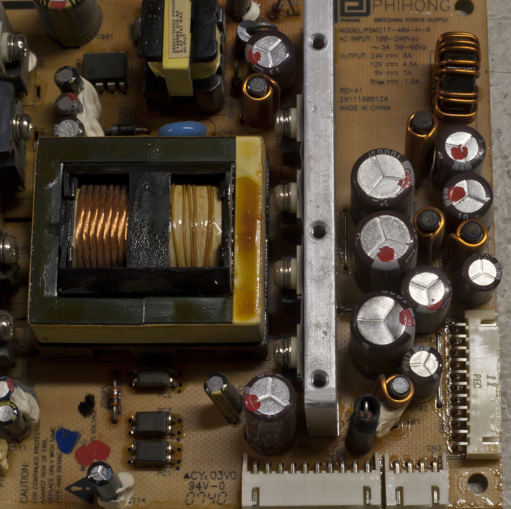

              I used one of your pics of the PS on HF289H and added info on caps measured with ESR meter.
              The pic #1 info has all the values measured on the board with all caps replaced.
              It was dark screen, no LEd before. Now is OK.

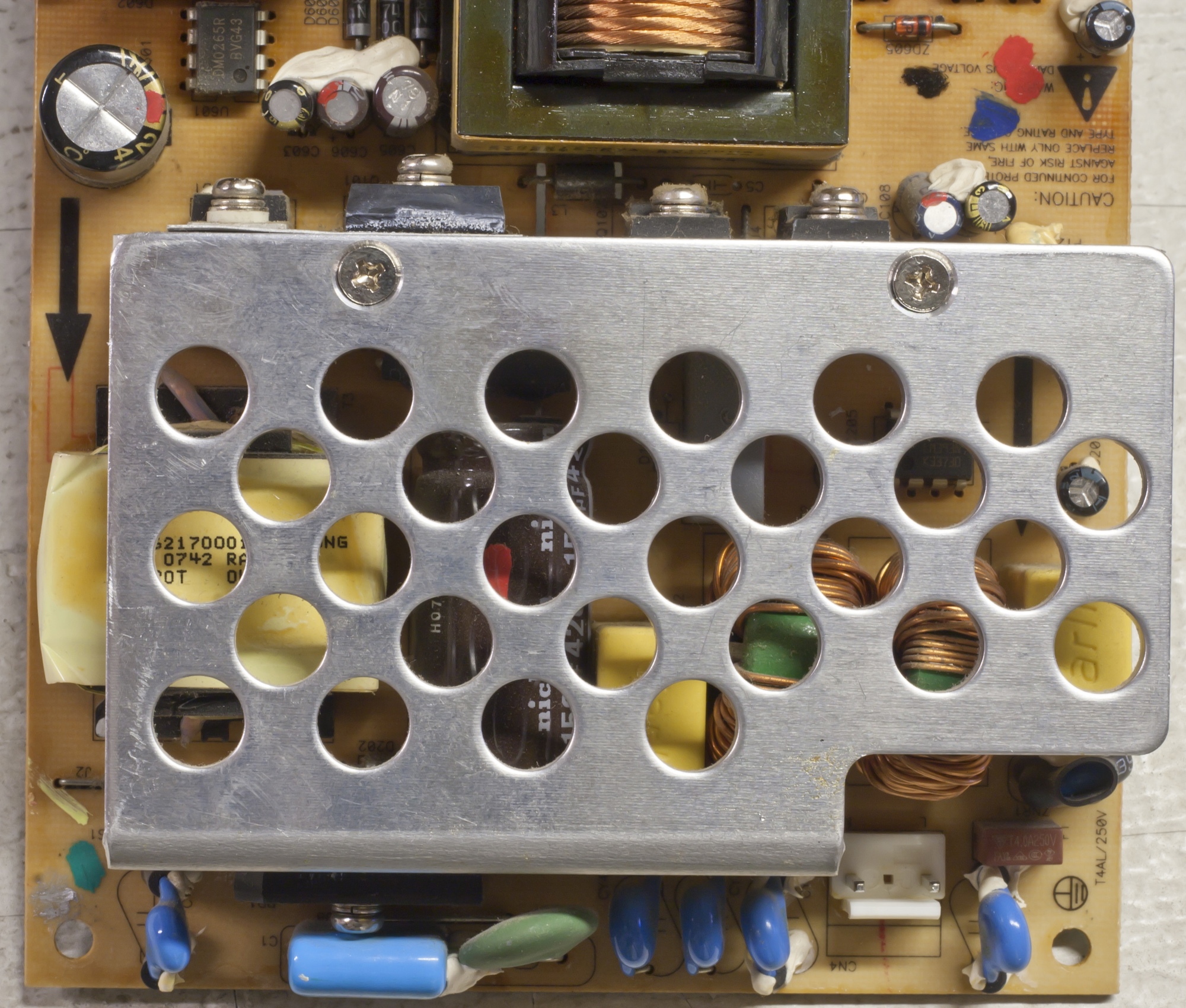

              The pic # 2 info has values measured on another bad board.
              It was yellow LED not starting up.
              I replaced just one cap which looked totally out of specs (C603) and now I get blue LED.
              I measured all the caps removed from board # 1 and it looks like all the 22uF 35V caps are problematic.
              I will replace all the caps but the board already works.
