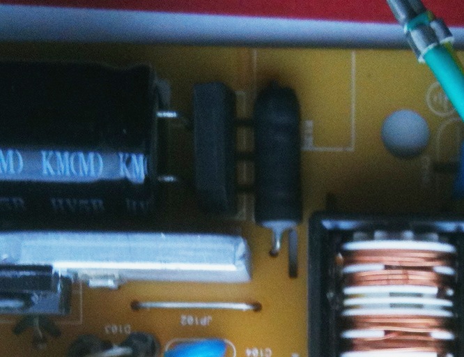

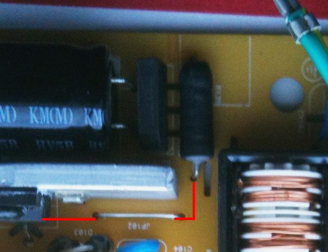

      Hey guys so after reading a few threads about how the PSU works to get a little better understanding and some clues on what to check, I decided to test the start up resistor and it was shorted! Desoldered it to double check and yup it's reading 0 ohms. Would this cause my problem?
      Here's a cropped pic of it's location. I'm curious, why is it covered in what looks like heat shrink? If I replace it, should I do the same?

        Re: Someone explain this? Emachines monitor
        I don't *think* that's a startup resistor. If those fail they typically go open circuit anyway. I don't know what a shorted startup resistor would do but I think it would cause more problems than just random shutdowns.
        Going by the blue colour, it could be a fusable resistor (which would explain the heatshrink) - is the part designation FRxx?
        You would really need to take the heatshrink off and check the colour codes before you decide it's shorted. It may in fact supposed to be 0 Ohms.

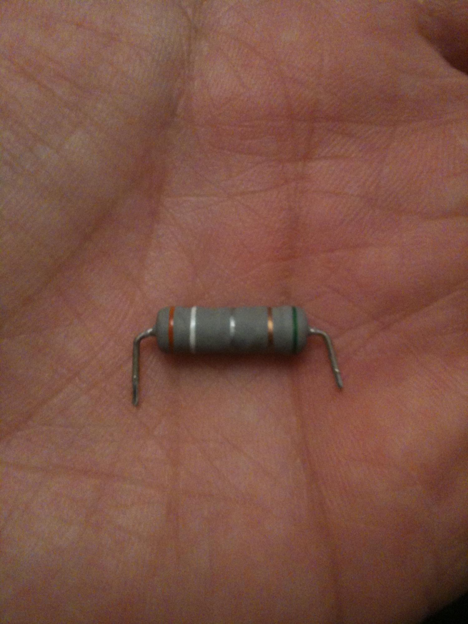

          Part designation is R135
          I removed the heatshrink and it does have a color code. Included a pic.
          Also one lead from it on the CB is linked to one lead of a transistor (Power FET?) attached to a heatsink through a jumper (drew a line to indicate this in second pic)

            That is an interesting code...
            Assuming it's Red-White-Silver-Gold-Green as I interpret it, that seems to imply an 0.29 Ohm resistor with 5% tolerance and the green probably some temperature coefficient or other rating.
              Also one lead from it on the CB is linked to one lead of a transistor attached to a heatsink through a jumper (drew a line to indicate this in second pic)
              if first colour red then its 0.29 ohm
              if brown then 0.19 ohm
              if orange then 0.39 ohm
              your meter wont read this because its a part of ohm
              I think they call it a current sense resistor

                #47
                Hmm so probably not shorted then?

                  #48
                  I would say that, they burn and crack open when they fail hence that covering
                  you can test it with esr meter but as I said, I would think its ok

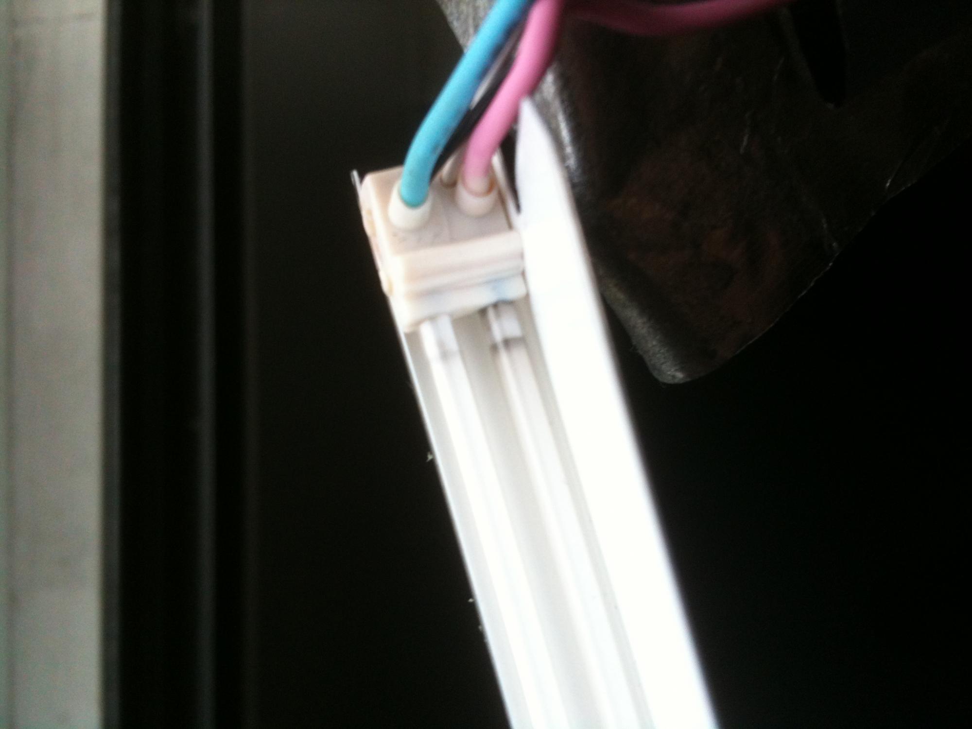

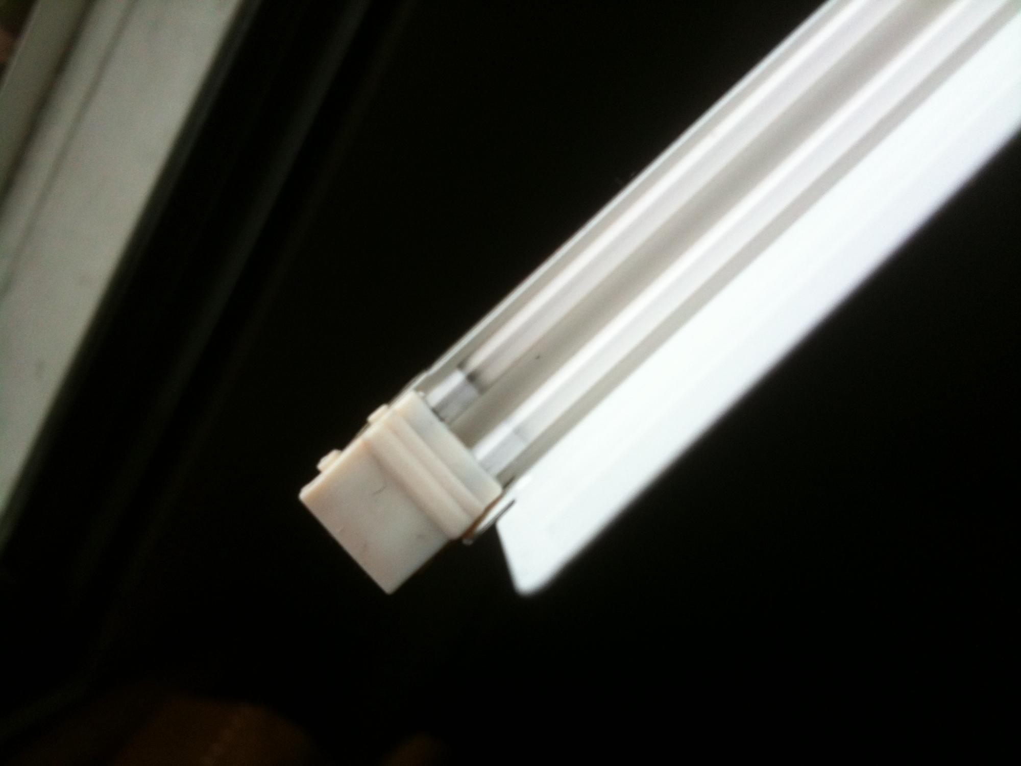

                          Went ahead and disassembled monitor to get to the CCFLs. Figured at this point I might as well check the connections and at same time gain a learning experience.
                          The connections looked pretty good and solid to the lamps, but I noticed blackened ends on a couple while the others were light grey, possible bad lamps? I included pics.
                              Black on the ends always indicates old lamps, which can cause problems - although the black is not as prominent as on some I removed that were lighting up pink instead of white (pink indicates they are really stuffed!)
                              -David VanHorn
                                The lamps are one thing, but don't forget about the wiring. It could be frayed internally or burnt to a crisp at the ends. The rubber ends hide that. See
