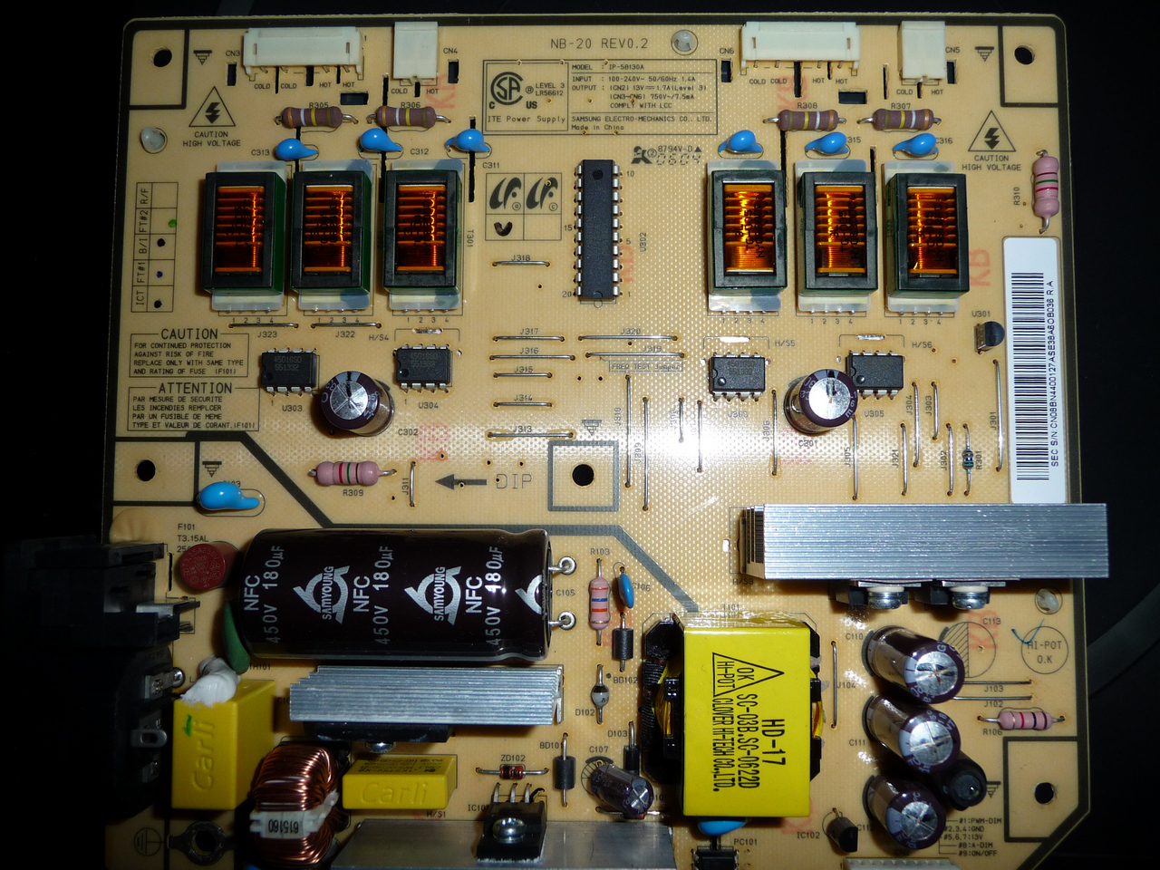

    Hi Badcaps users,
    I recently was given a broken Samsung 215TW that I'm about 90% sure has bad caps on the power board. When the monitor powers up, the blue power light appears, but the picture only comes up after warming up for a few minutes. When it does appear, it's super dim. After a few more minutes, it will get brighter but flicker like crazy then the picture will completely cut out entirely.
    I searched on google to see to if I could find any reason for the problem, and I stumbled upon this super helpful forum. I read the thread located here which explained a lot but I still have a few questions.
    I took out the power board and placed it in a known working Samsung 215TW. The good monitor would power on, with the blue light, but no picture. It never had any picture appear after waiting a few minutes, not sure why, but it seems that board is the issue.
    I unfortunately didn't have time to put the known working power board into the non-functioning monitor to see if it was just the board and nothing else. So for now I'm assuming it the power board and not logic board with all the input connections.

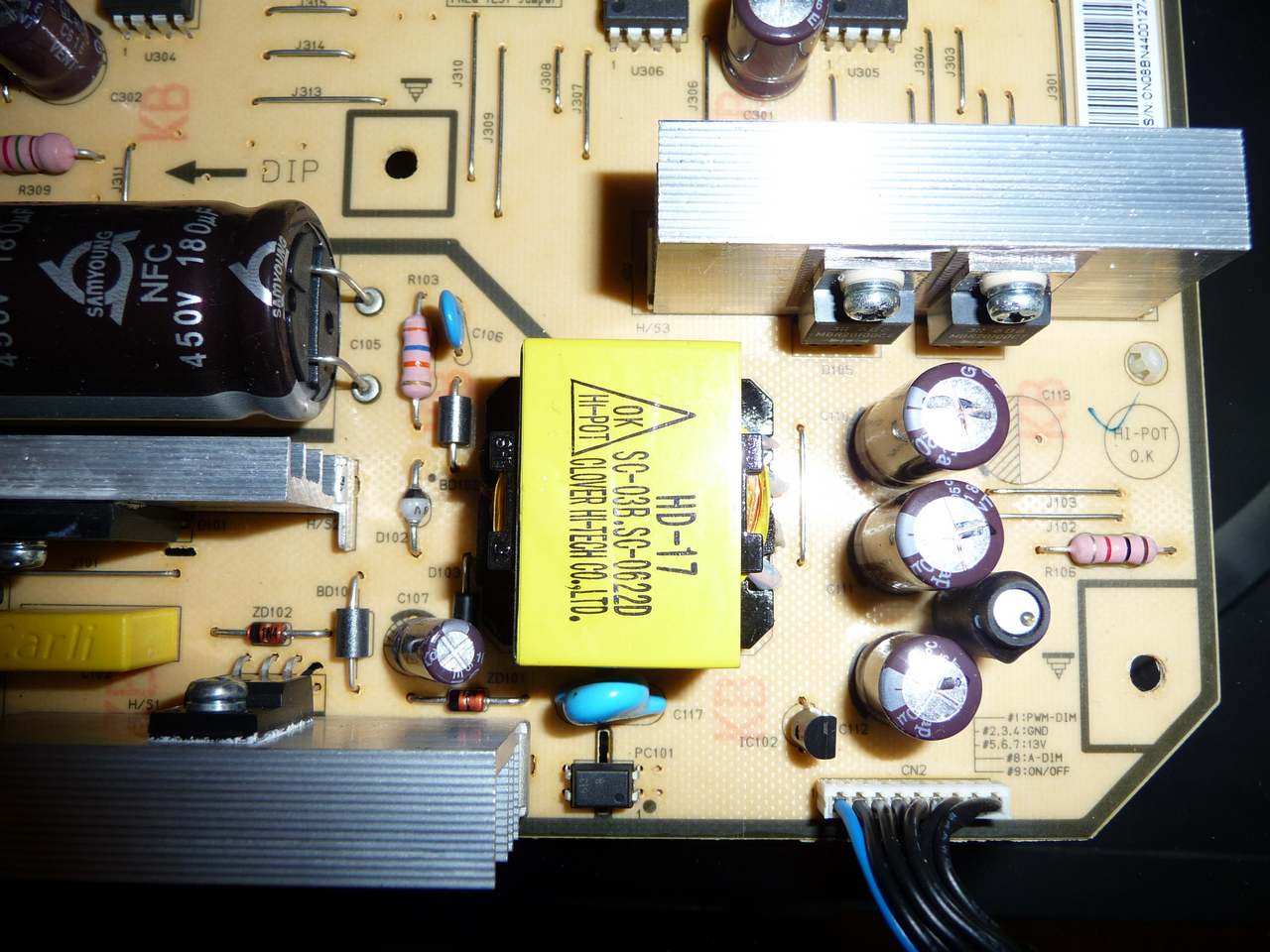

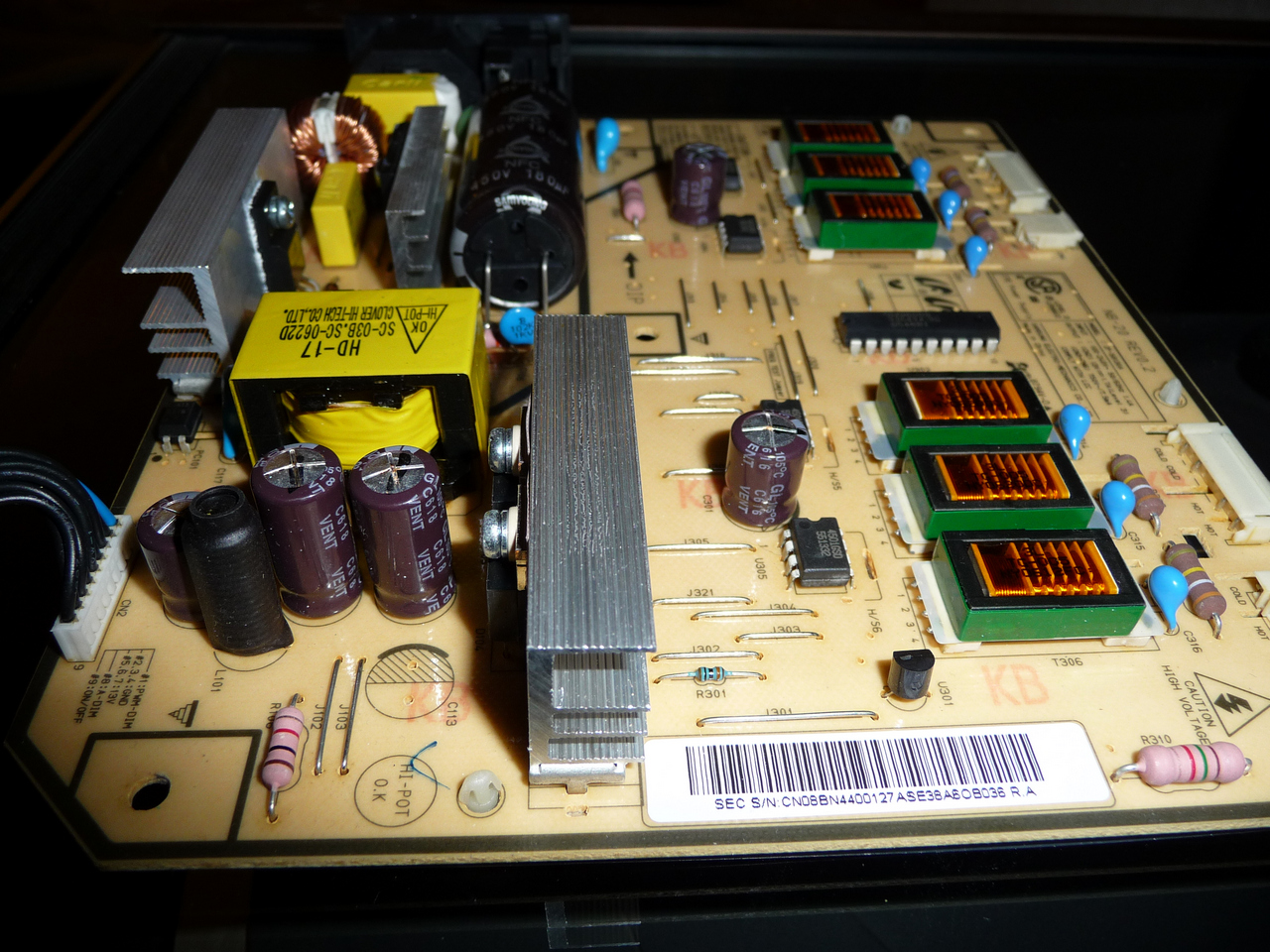

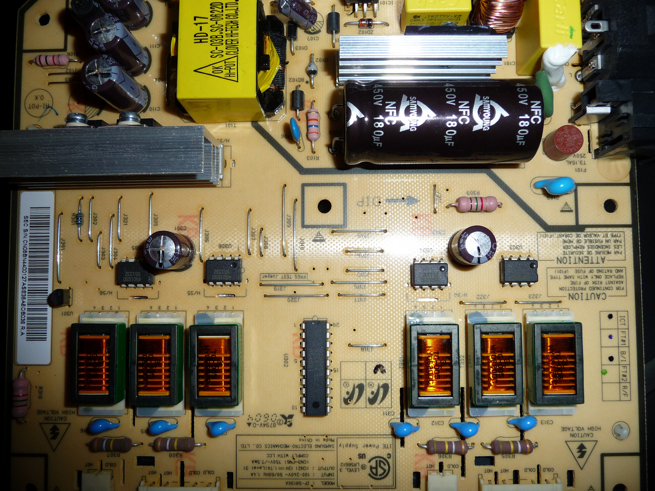

    Anyway, taking a look at the 6 brown caps, it appears that all of them are bulging. So I plan to replace them with better caps, but I'm a completely new to replacing bad capacitors. I don't know which brands would be good to replace it with. I know Digikey has a lot of selection for cheap capacitors, but it's a bit overwhelming.
    I know that I need the following caps but other that info, I'm not sure what what type, or what brand to purchase.
    1x 47uF50V
    2x 820uF25V
    3x 330uF25V
    1x 180uf450V?
    Also, I'm not sure I need to replace the larger. Can anyone give any suggestions?

    1) Great pics. It helps a lot.
    2) Thanks for doing some research.
    3) The largest cap rarely, but not never, fails. The largest cap doesn't undergo the same stress as the other caps. Most here leave the largest cap as is.
    4) To order from digikey, do this (to pick Panasonic FM low ESR series).
    In the search field, click on in stock. Then type "820uF 25V fm" into the field. Make sure the diameter and height dimensions fit.
    Do the same for the other caps. If FM is not available, replace with FC.
    5) If you want verficiation, post your list and someone will verify.

      6) It looks like the original caps are Capxon GL. Capxon has a terrible reputation for making capacitors.

          Yeah, that's what I've been reading on various forums. Seems like samsung has terrible Quality Control because of using cheap caps. It's too bad because the picture quality is stunning on the working 215TW. Hopefully with the replacement caps, the broken one will too

              So I finally got around to ordering replacement caps. I ended up taking the advice from retiredcaps and ordered my caps from Digikey and used the Panasonic caps for replacing all the Capxon caps except for the largest one. I bought the following caps:
              Qty Part# Manufacturer Part# Unit Price Total
              2 P12391-ND EEU-FM1E821L 0.75000 $1.50
              3 P12386-ND EEU-FM1E331 0.51000 $1.53
              1 P10321-ND EEU-FC1H470 0.34000 $0.34
              I got some help from my father who had a professional soldering kit, including the oh so useful solder sucker, which made replacing the caps a breeze. It took about 20 minutes to remove and replace all the caps. Once the caps were replaced, I reassembled the monitor and now it's working great! No more flickering image
              Thanks for the advice retiredcaps!
