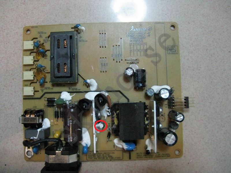

    I've got a dead power board from a Westinghouse L2210NW monitor that has a DAC-19M020 power board. I am trying to identify the voltage and capacitance of the capacitor circled on the board in the attached picture. Unfortunately it is dead so I can't measure it and the silicone they used to secure it to the board has eaten away the capacitor ID information printed on the side. I believe tha capacitor ID on the board is CE101 but that is hard to read as well. Any help would be appreciated.

    I don't know for sure,but about every delta board that I have seen,where a single cap is used in that general location has been a 50v 47uf or a 50v 22uf.

      I found this manual on a Chinese website and answered my own question. Apparently it is a 35v 33uf 5x11 cap made by Man Yue, Rubycon or Nippon Chemi-con. I hope someone else can make use of it.
