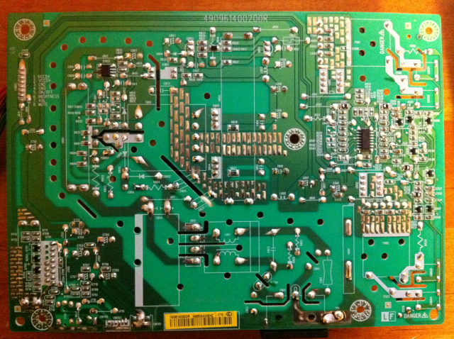

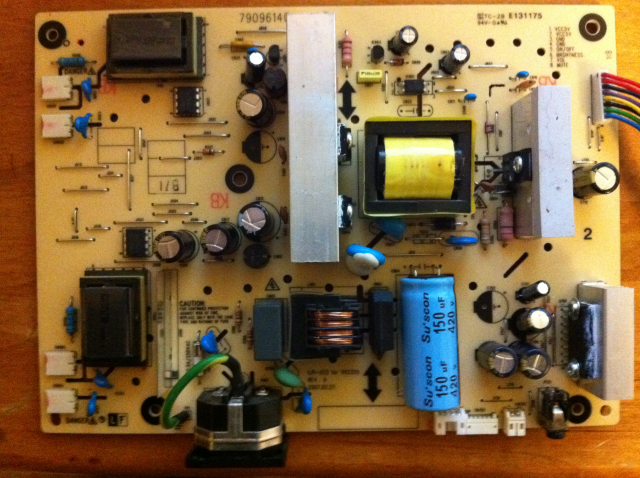

                      I have the same problem, except did not notice any "pink". (someone else was using it at the time)
                      Yesterday, Monitor went blank, pushed power button, came back on. Went off again, same thing. Then went off several times in 10 min, then stayed on for a few hours. Turned it off, went to bed, this morning would not come on, not even power light.
                      Yes this is a Viewsonic VX2255WMB.
                      Here are pics of board.

                        Re: Viewsonic VX2255WMB screen goes off
                        Ok please can you re attach the pics as jpgs.
                        First - no power - off 5 minutes -unplugged can you test the fuse near the mains socket
                          sorry here they are, caps all look good.

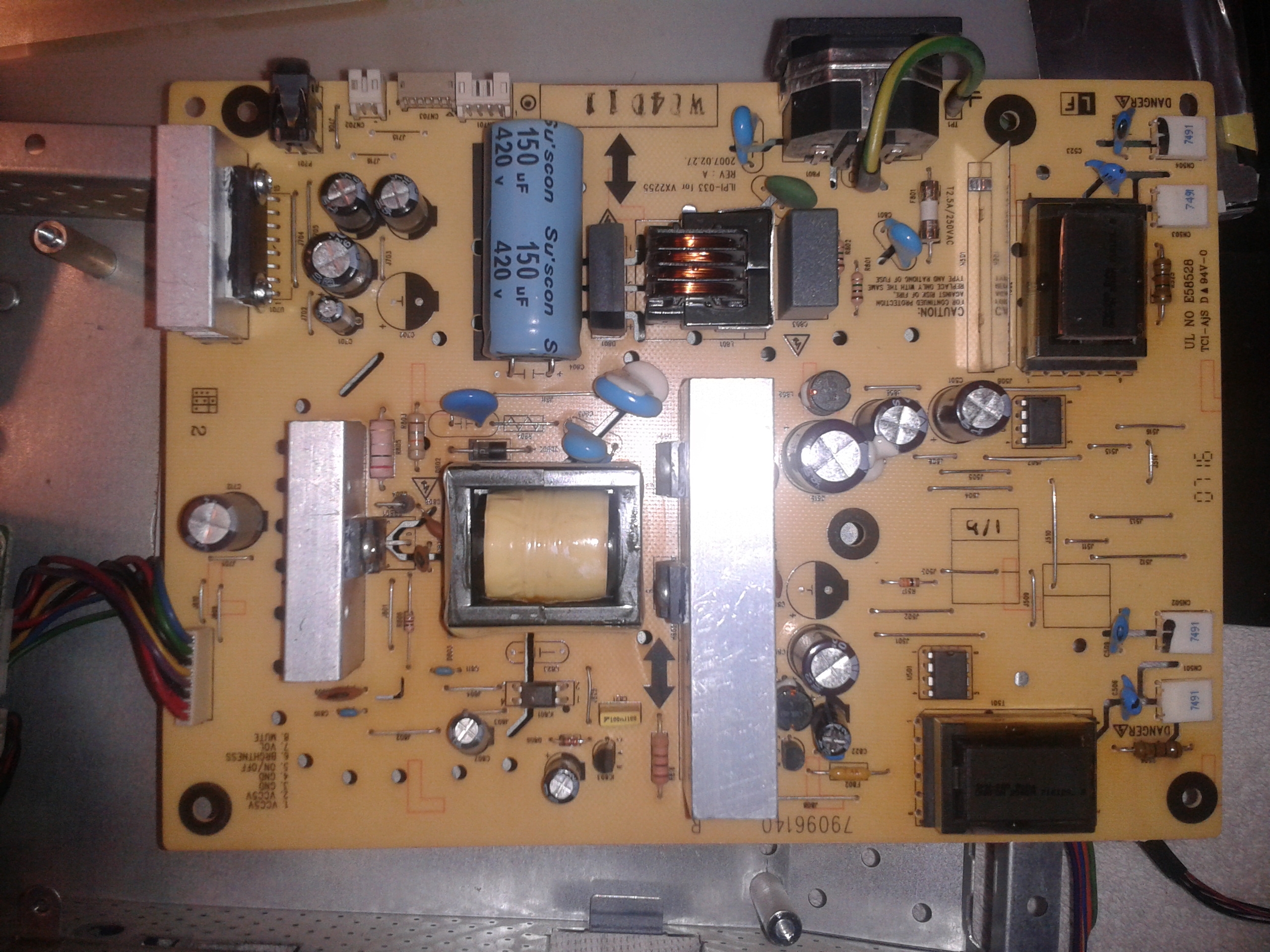

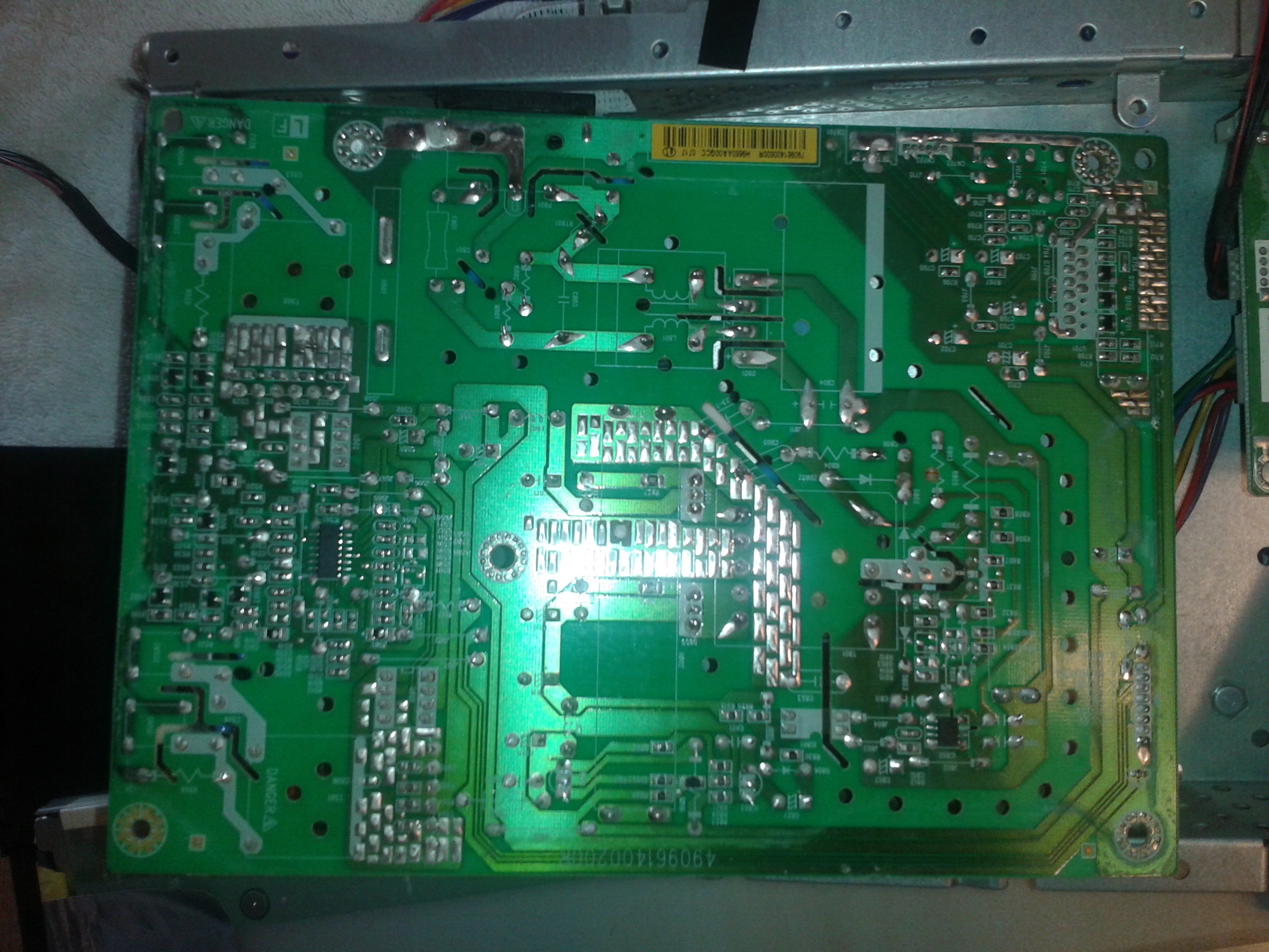

                              here are right ones
                              • jetadm123
                                • 2169
                                With the monitor unplugged, try checking the main fuse, F801, below the power connector. You should read approx. 0 ohms on your meter. If the fuse reads good, plug in the monitor and measure the voltage across the the large blue 150uf cap. Be careful as it's high voltage. You should read approx. 165VDC.
