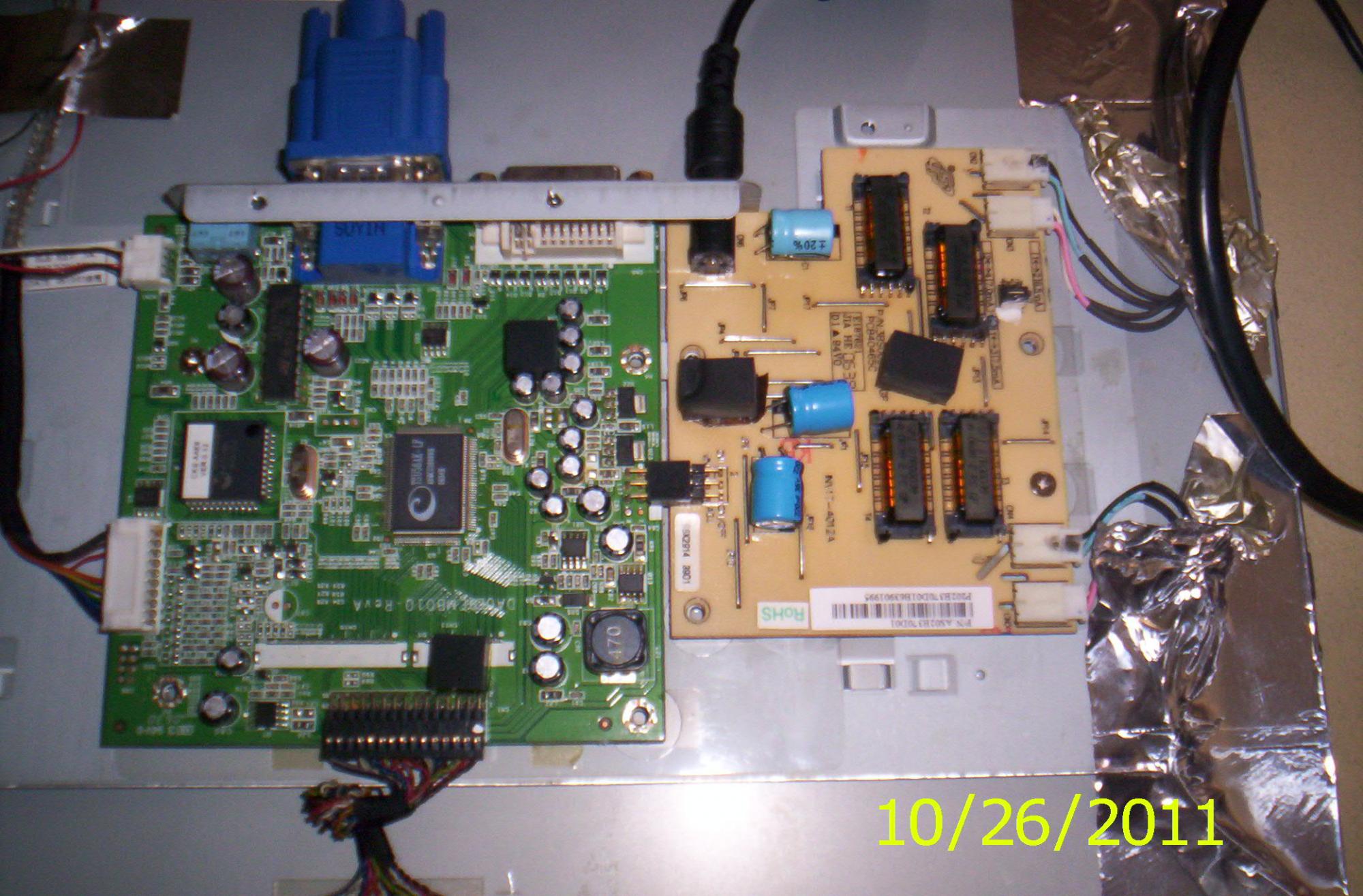

    I have been trying to find who manufactures these monitors. The tech tell me they don't know, but bring it in and they will look at it.
    My problem is : the screen is black,power light on.
    caps have been replaced.
    If I can get a schematic I can do a better test.
    Any help would be appreciated.
    Tony

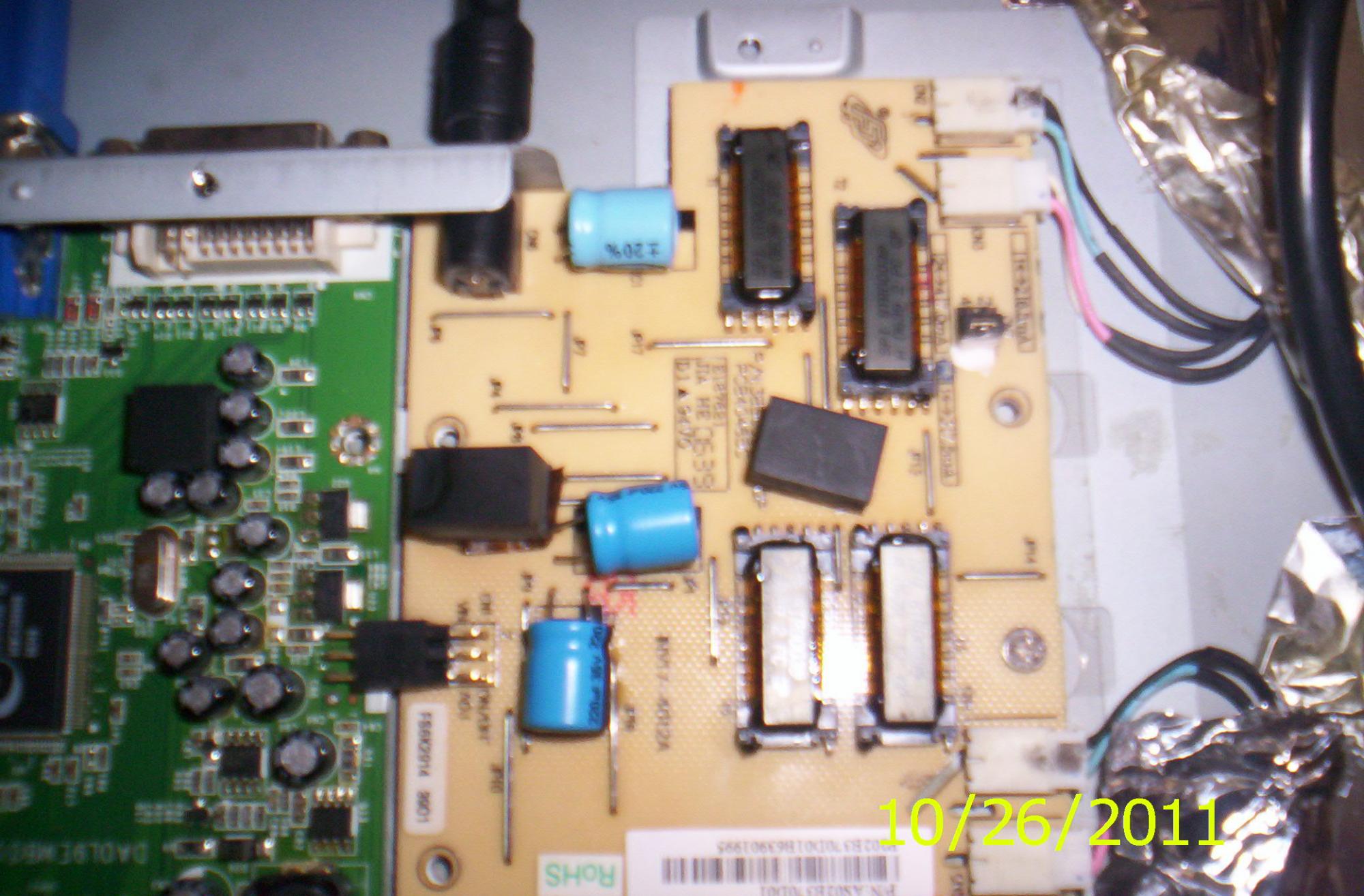

    1) There could be a fuse in the inverter area which would explain the black screen.
    2) There could be shorted fets in the inverter area.
    3) Post pictures of your boards using the manage attachments button so they are hosted here. Please do not post pictures inline as they slow down the loading of pages.

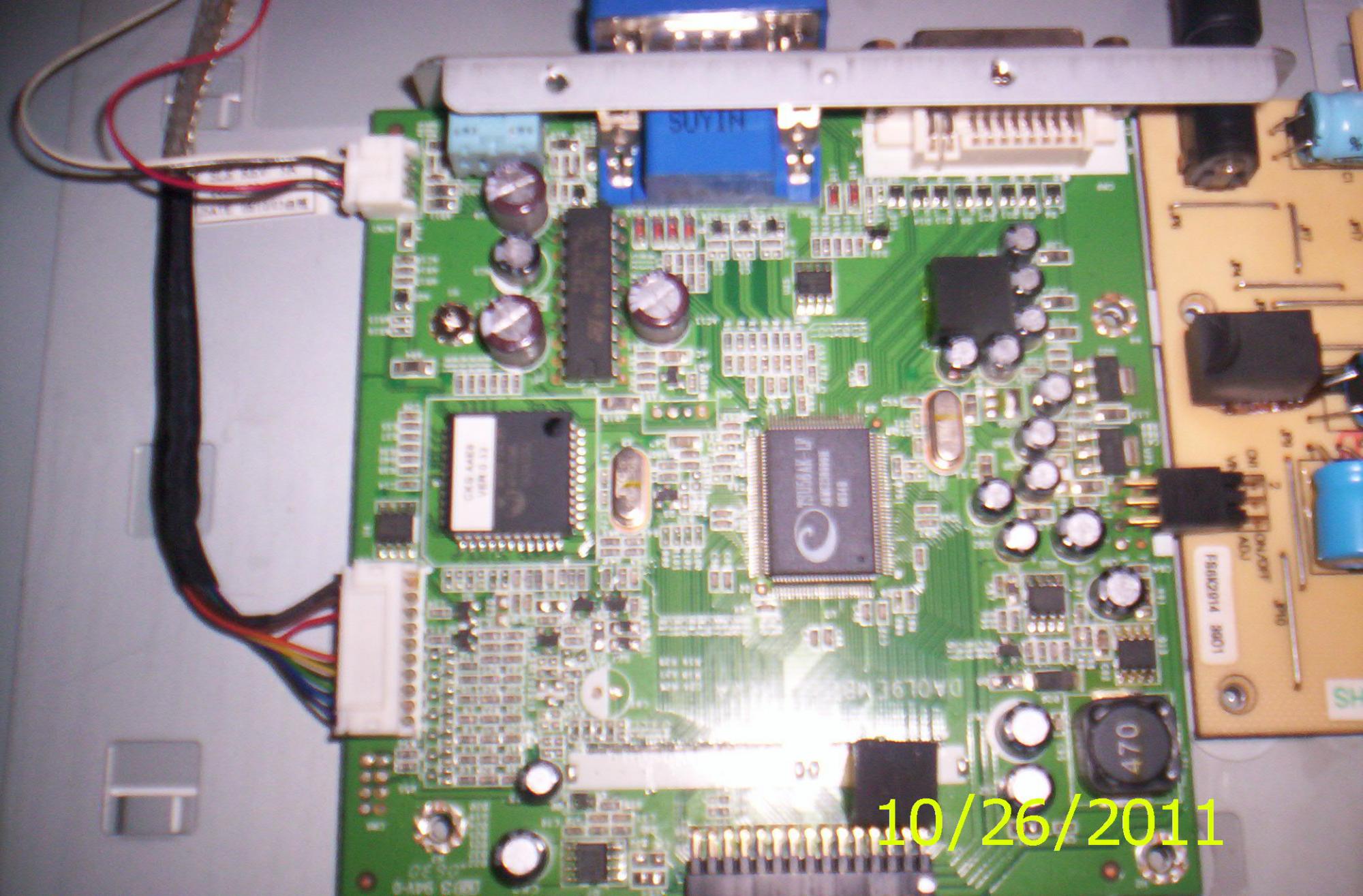

            pictures.
              Re: Staples SP7106
              85c GP Xicons/Lelons??? How about some FMs, FCs, PWs, HEs, maybe HDs?
              How does the soldering on those jumpers and transformers look?

                Re: Staples SP7106
                Mm. It's one of those external PSU things. Have you tried a different power brick? Also check the output of all regulators on the logic board. The regulators are the 3-leg devices with a tab on the top side, in your first pic there's two of them right next to the connector that joins the two boards.

                  Re: Staples SP7106
                  Yours looks just like mine on the power side. My main board does not have the DVI connector. I opened my power supply but nothing looked bad. I had tested it for proper voltage. I bought a second new power supply just to keep on hand. My problems are the same with either of the power supplies. I tested the inverter transformers and found two of them were bad. I had replacements so I went ahead and changed them out. Still did not get a picture. I changed the caps on both boards, but that did not get it going either. I have about given up on mine. Looking more and more like a parts monitor. I have done a pretty in-depth search for a Service Manual without any luck.
