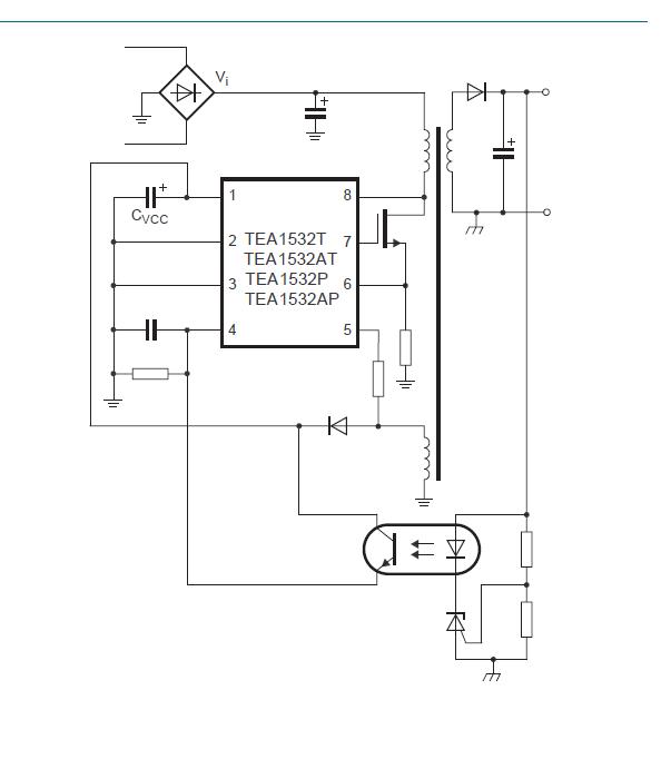

                              I looked at the PS primary section, it looks like the resistor or something is bad on the board on the left of ZD102.
                              One thing that does not make sense is that he is getting about 9vdc at pin 1 VCC PIN, since this VCC is generated from the aux winding of the transformer which will keep the SMPS IC running after it gets the kick start voltage on pin8, once it starts, it does not use voltage from pin 8 any more, but it will be using the VCC from the aux winding, so for it to have 9v at pin 1, the aux winding must be putting out the voltage which mean the SMPS is running, unless pin 8 is shorted to pin 1 internally.
                              I will be waiting to find out the outcome of the problem.

                                  In the mean time, can you check the continuity between pin 8 and pin1, that may explain why you are getting 9v at pin1 to see if it has shorted or leaking internally.

                                      Ok I did a continuity test between pins 1 and 8 and it was not shorted. I then powered the board up and tested from the ground tab to pin 8 and I was only getting 36 volts is that normal?
                                        #59
                                        Re: Acer AL2216W Repair Question
                                        38V is not right, it should be the same to what you read on the large main DC filter caps. See the app note how the TEA1532 is used.
