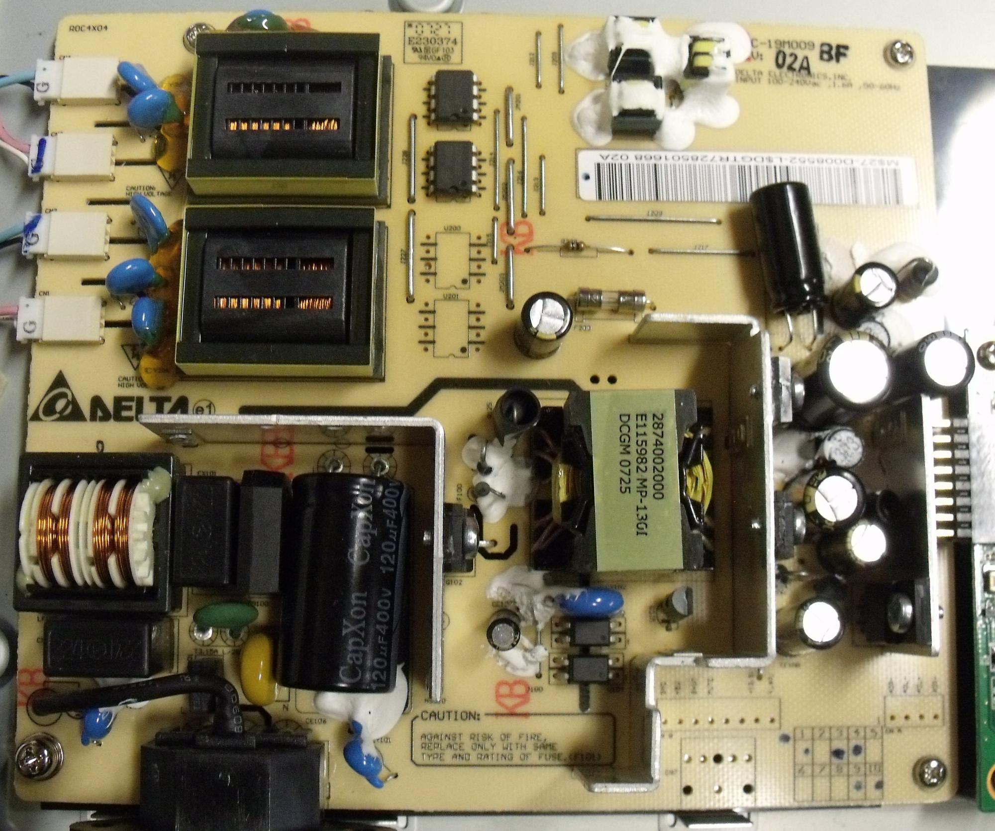

    Re: Acer AL2216W Repair Question
    Incase anyone is wondering, the problem I'm having is that whenever I turn the monitor on, it takes 5-10 minutes to actually power on, flashing the Acer logo multiple times until finally staying on. And when it is on, it lets out a faint buzzing sound.

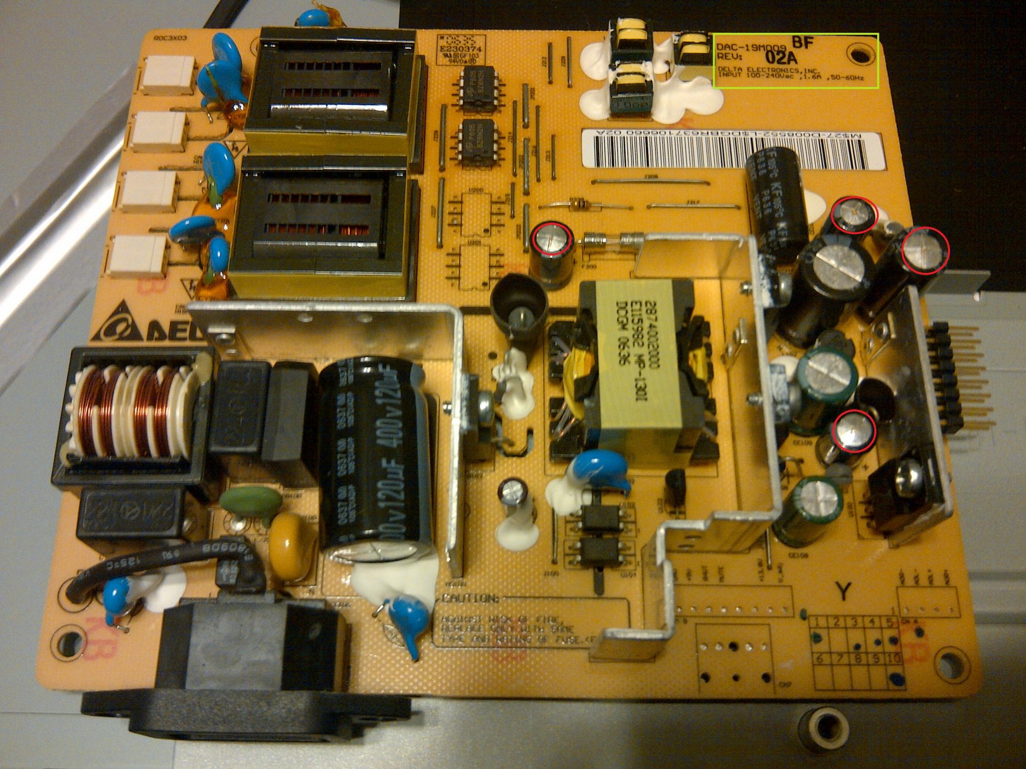

                    • jgust25
                      • Nov 2011
                      Posting on recent related topic- hope that's alright.
                      I have an AL2216W that is experiencing similar issues as the others I've searched for on this forum:
                      - Plugged in to known good sources, and does not find signal.
                      - Powered on gives green light, and shortly goes to orange after "not finding signal"
                      I disassembled the monitor and got a picture of the board, and I've circled what I believe to be the bad caps in red. Board looks good overall, no burns and no scratched runs on the back. No picture of the back, but if it's required I can get one.
                      I assume the next steps are to hit up digikey and purchase some replacement caps and go to town and see what happens... I just wanted to come here first to make sure I'm not missing anything.
                      • retiredcaps
                        • Apr 2010
                        • 9271
                        Correct. Those are the ones that are obviously bad.
                        Since 4 of the 9 (not counting the big one) are bad, most here will recommend that you replace them all. Capxon are very poor quality caps.
                        Capacitors (C designation on the PCB board) die from age, heat, and shoddy build quality. Capacitors DO NOT have to be visibly bloated in order to bad. They can be out of tolerance uF (a 1000uF measures 20uF) and/or have high ESR (ohm). A multimeter will be insufficient to test for ESR. For that you need an ESR tester which costs between $50 and $300.

                        • PlainBill
                          • Feb 2009
                          • 7034
                          A few points.
                          This board has 10 electrolytic caps; 4 are obviously bad. The 120uF, 400V one seldom has problems. It is strongly recommended you replace the other 9 if you are planning on using this monitor for a few more years.
                          When selecting caps, make sure you are getting low ESR caps such as Panasinic FM or FR series.
                          PlainBill

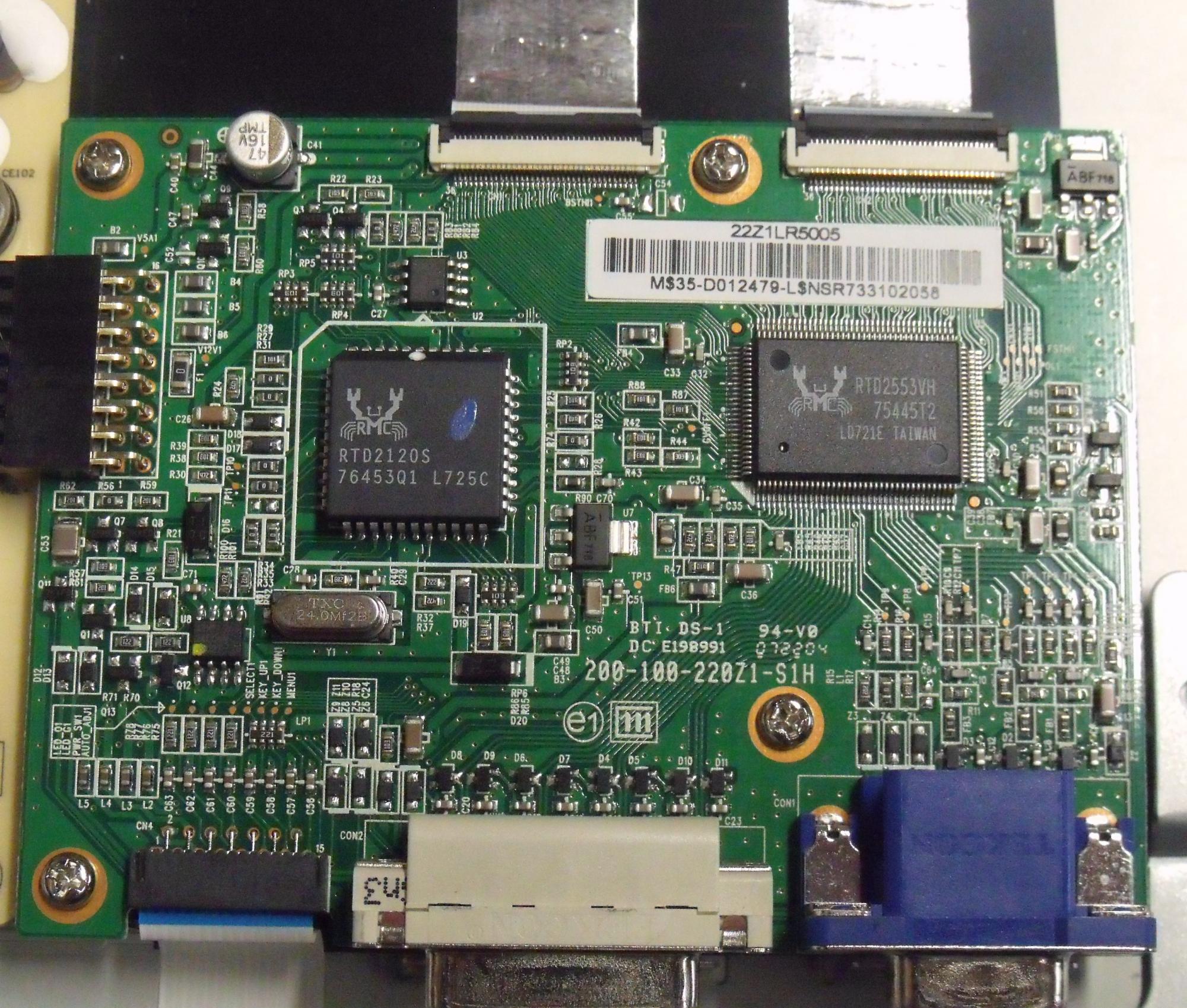

                                    • trains58554
                                      • Apr 2012
                                      • 55
                                      Ok here are the pictures of the power and logic boards.
                                      • jetadm123
                                        • 2169
                                        Since it sounds like you're getting no power, with your meter set to 200VDC measure across the leads of the large 450V cap. You should read approx. 120VAC x 1.414= 170VDC. BE CAREFUL! You're dealing with high voltage. Avoid having your probes come in contact with the heatsink above the cap.
