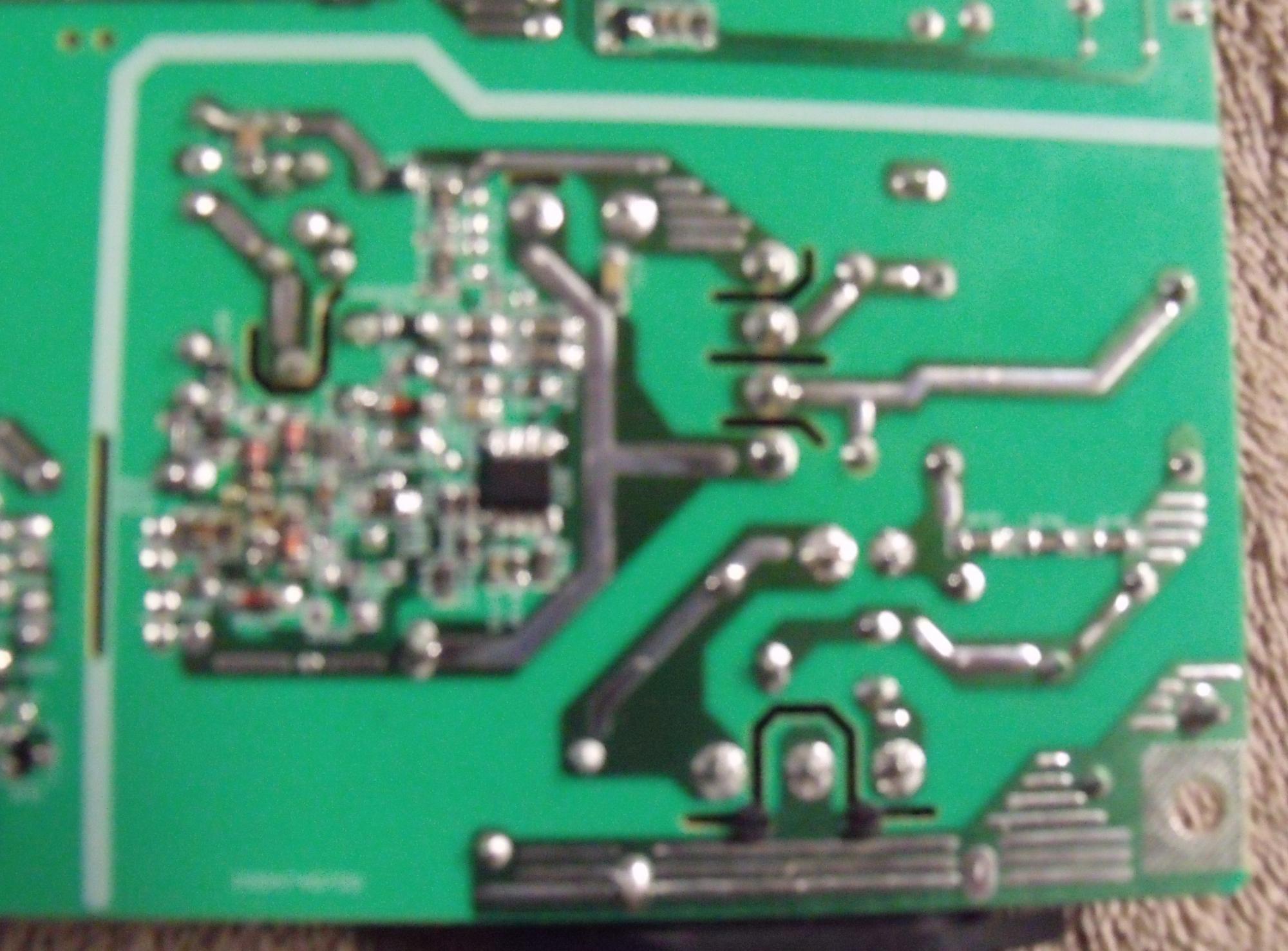

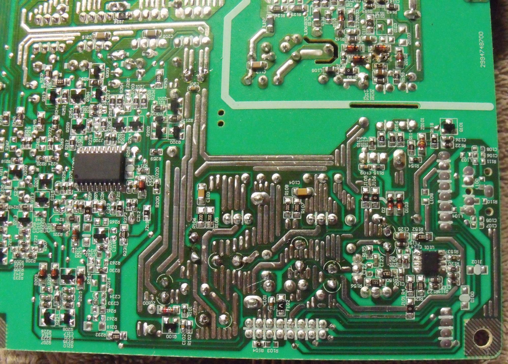

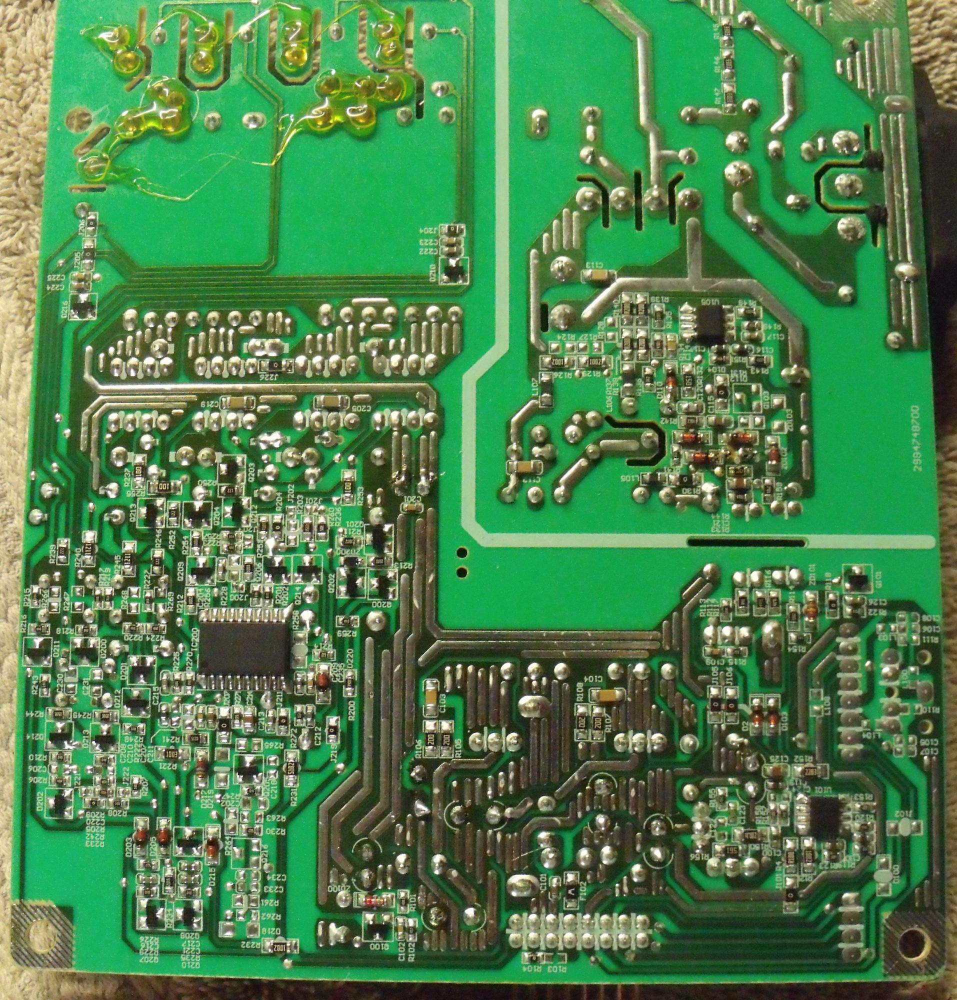

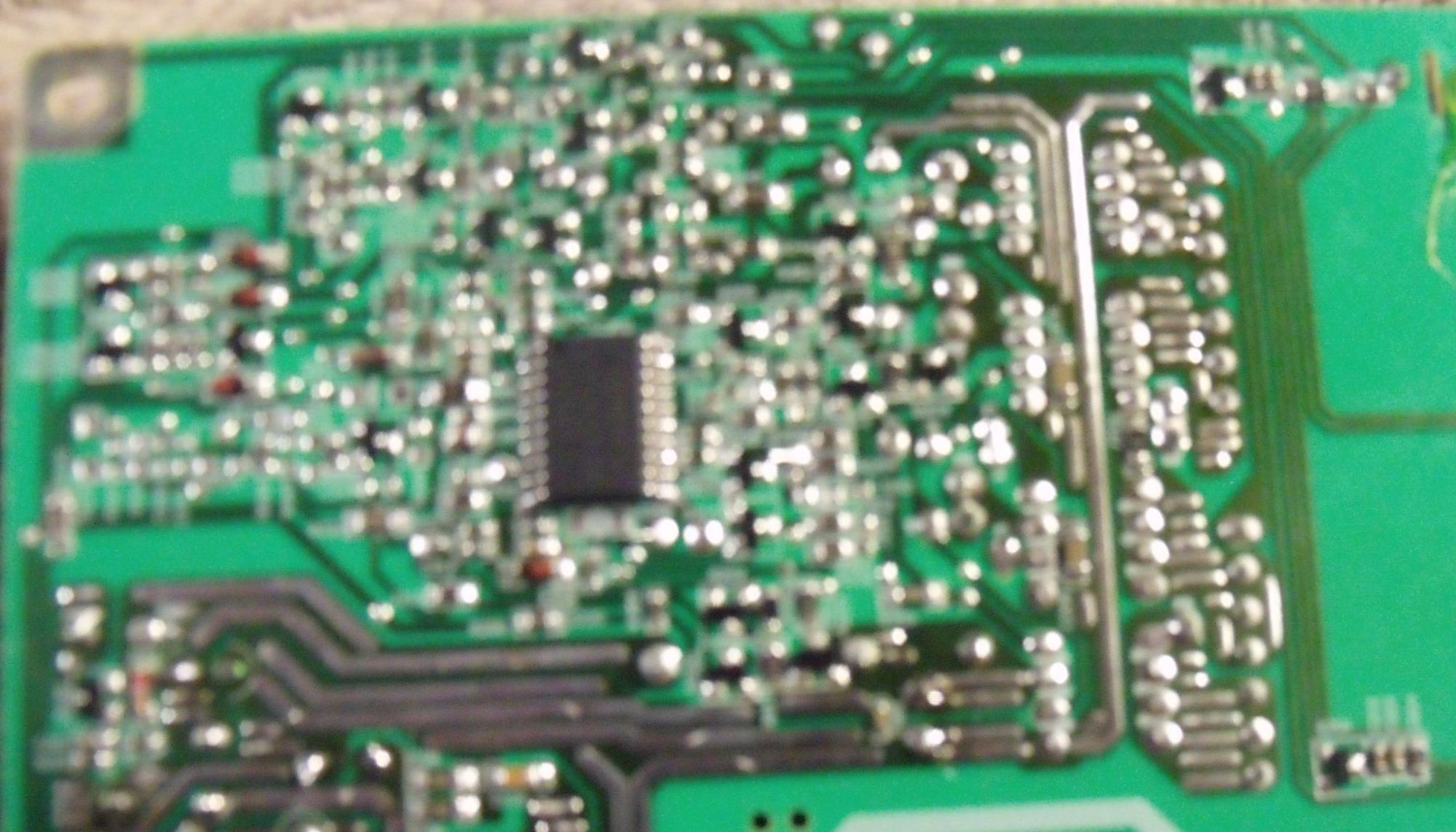

    You should observe the polarity when doing this Red probe to positive leg black lead to negative. In your photo looks like negative is on the right.
    Just to check - when you did the 5v test you did have the boards connected?
    Also in the pictures the boards are on a metal frame? If they are fixed in their normal position that is ok but do not turn on if they are resting on anything conductive.

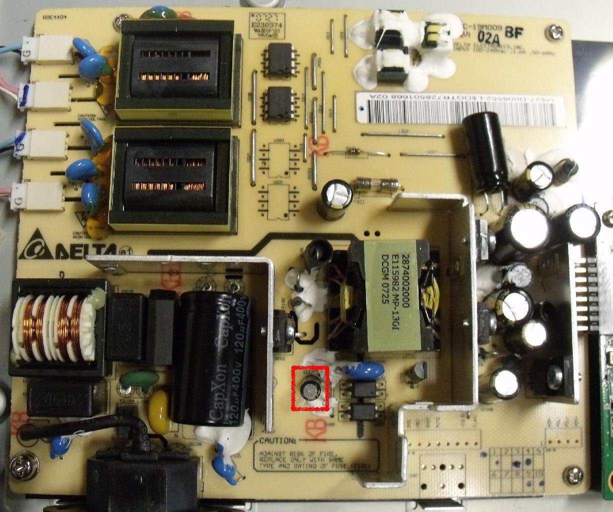

        Delta board. Jetadm123 knows this board very well.
        I circled the startup cap. It is probably 22uF 50V.
        1) What is the DC voltage across this capacitor?
        2) Is it steady or fluctuating?
        3) On the backside of the board, there is a 8 pin IC (probably U102) that is the SMPS. What is the part number?

        • jetadm123
          • 2169
          Re: Acer AL2216W Repair Question
          After you perform retiredcaps suggested measurements, two things have come to mind:
          1) You are not getting 5VDC, but are you getting 12VDC?
          2) Most of this series of Delta boards have a fused 5V output. IIRC, the fuse is something like F101 or F102 and it's a surface mount component on the bottom of the board with a "M" or "W" (depending on how you look at it) stamped on it. Check to see if it's open. Also, a good focused photo of the bottom of your power board would be helpful. There may be other surface mount fuses and it wouldn't hurt to check them as well.
          • trains58554
            • Apr 2012
            • 55
            @retiredcaps,
            The voltage was steady at 38 volts.
            as for the 8 pin ic on the back. u101 LM393 I believe that one is hard to read. U105 is EA1532A
            @jetadm123,
            nope no 12 volts.
            I checked the fuse with the w on it and the others that look the same and they where all still good.

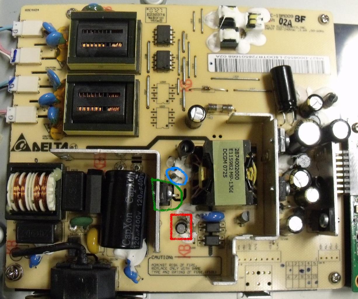

                                        #39
                                        Originally posted by trains58554
                                        Ok we are getting somewhere now. I have the small cap soldered in again. Now When I turn the power on to the monitor the light flashes orange for a millisecond then off. I still did not see the q102 or the f100 if we still need those values I will look again.
                                        See diagram. Green is Q102. Blue is F100.
                                        What is the DC voltage reading across the small capacitor after resoldering?

                                        • jetadm123
                                          • 2169
                                          #40
                                          If you look at your first photo of the power board, look to the left of the startup cap. Q102 is the transistor mounted on the heatsink. If you look a little higher, you'll see F100.
                                          What exactly was wrong with the startup cap?
