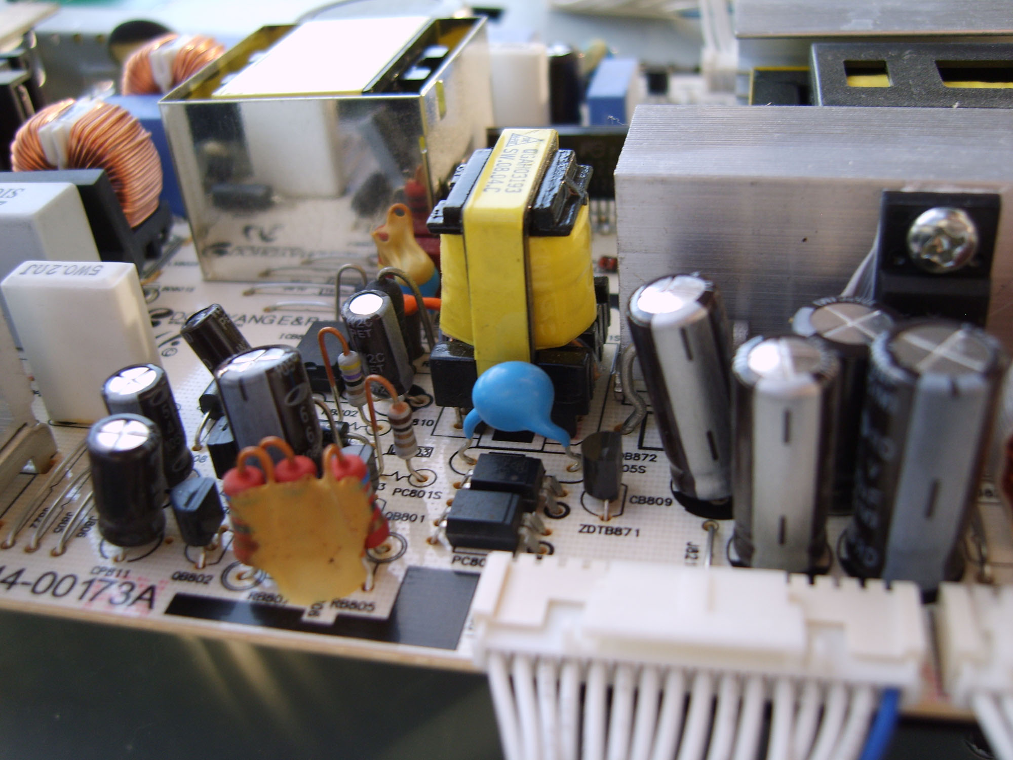

    My monitor has experienced a major malfunction. The screen will randomly freeze, and then get uncontrollably brighter and brighters. Sometimes I can use ctrl+alt+del to snap it out, but now it starts rotating the same four screens over and over again. It will switch from dark, to white, to blue and to red-gren-blue-white stripes.

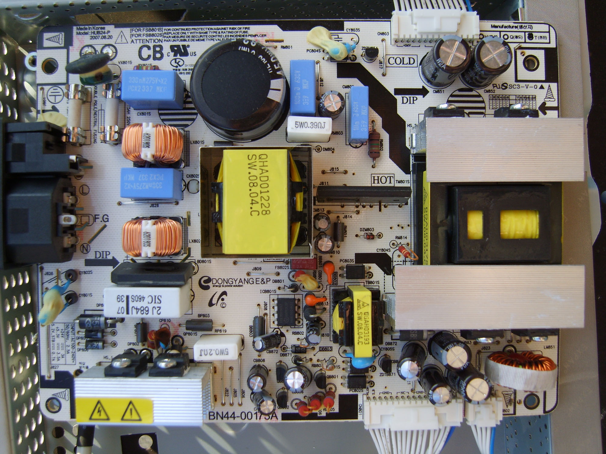

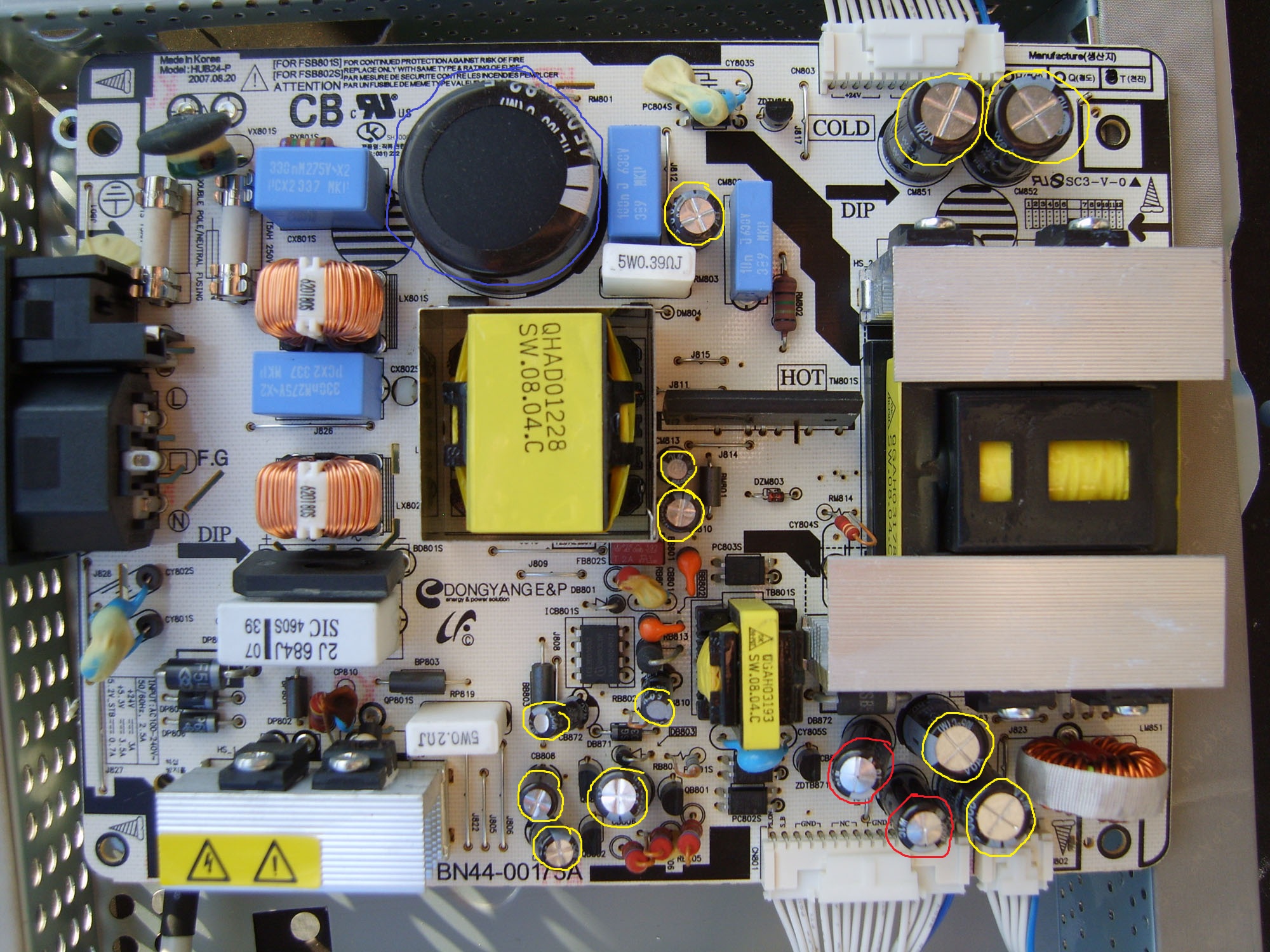

        Sorry for the ridiculous delay in getting these images. Just started a new job and things have been hectic.
        Anyway, I have some even closer shots of the boards done in sections should you require. Please let me know.
        Thank you again for your attention and help!

          1) The pics you supplied are excellent. Clear and focused. I wish more people could do the same when asking for help.
          2) You have at least 2 domed/bulged (I'm sure you can determine which 2 are obviously domed) caps by connector CN801 (bottom right hand corner). At minimum, I would replace all 4 in that section.
          3) There are 15 electrolytic caps in total. Since this is a nice big monitor, most here would recommend replacing all of them except the largest one which rarely, but not never, fails.
          4) Capacitors (C designation on the PCB board) die from age, heat, and shoddy build quality. Capacitors DO NOT have to be visibly bloated in order to bad. They can be out of tolerance uF (a 1000uF measures 20uF) and/or have high ESR (ohm). A multimeter will be insufficient to test for ESR. For that you need an ESR tester which costs between $50 and $300.
          5) PCBONEZ talks about how to choose the right series at
          https://www.badcaps.net/forum/showpo...47&postcount=3
          6) If you don't want to do all that work in step 5, then choose Panasonic FR, FM, and FC caps (in that order of preference) from digikey following PlainBill's ordering instructions at
          https://www.badcaps.net/forum/showpo...33&postcount=2

            Excellent pictures. I've marked one of them up and attached it.
            Two caps circled in red - obviously bad. The must be replaced with low ESR name brand caps, such as Panasonic FM series.
            Caps circled in yellow. The recommendation is to replace them with low ESR name brand caps such as Panasonic FM.
            Cap circled in blue. Replace if you wish; it is unlikely it is bad.
            Shucks, retiredcaps beat me to it.

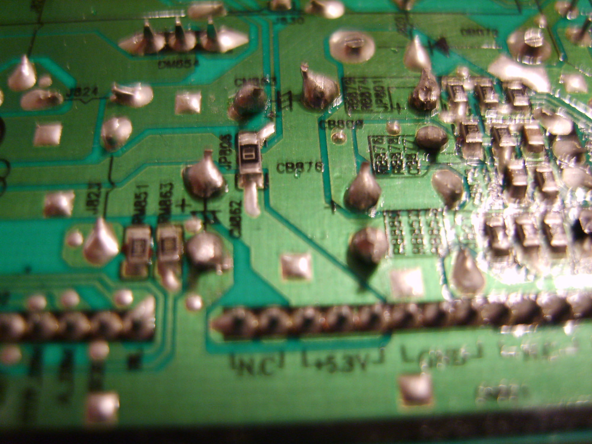

              Also this monitor has problems with the resistors burning up. The three that are suspect are the ones just right of the BN44-00175A. I believe they should read 68 Ohms as per this megathread ...
              https://www.badcaps.net/forum/showth...=245b+resistor
              Since you have the monitor open, it is best to test them now and compare them to the color band as per
              http://en.wikipedia.org/wiki/Electro...r_and_inductor
              Even if they are good, you might want to pre-order spares along with the replacement caps to save on future shipping.

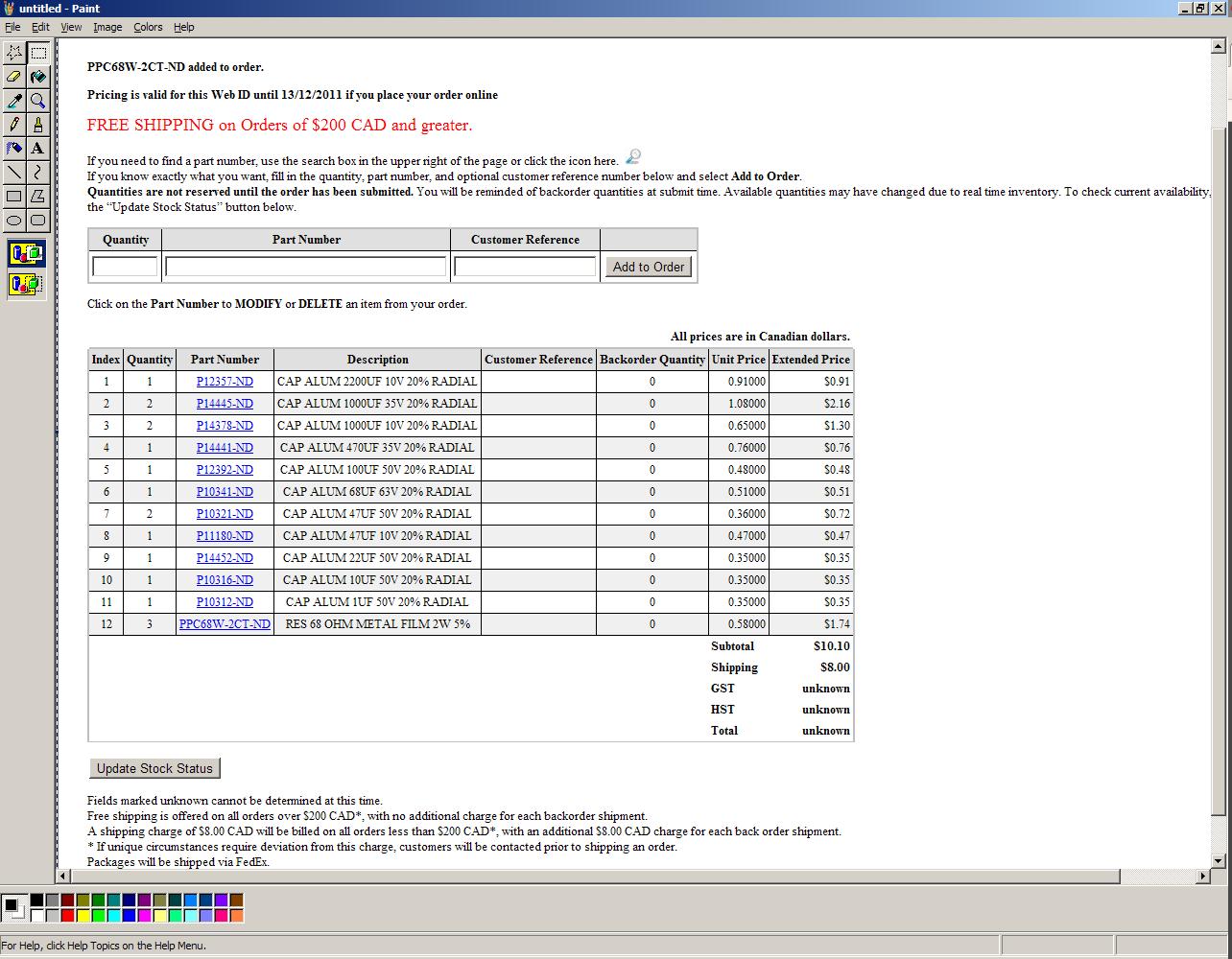

                      I was looking at getting one of those capacitor kits sold on ebay. I messaged the seller, and these where the ones he said came in the kit:
                      1 - 10V 2200uF, Panasonic FM
                      2 - 35V 1000uF, Panasonic FR
                      2 - 10V 1000uF, Panasonic FM
                      1 - 35V 470uF, Panasonic FM
                      1 - 50V 100uF, Nichicon PWM
                      1 - 63V 68uF, Panasonic FC
                      2 - 50V 47uF, Nichicon PWM
                      1 - 10V 47uF, Panasonic FC
                      1 - 50V 22uF, Panasonic FM
                      1 - 50V 10uF, Panasonic FC
                      1 - 50V 1uF, Panasonic FC
                      1 - Resistor uF-3 2w (That triple resistor that often fails in this model monitor)
                      Cost to me would be 16.95 US + 6.95 shipping (I'm in Canada)
                      I don't understand the mixing in of the Nichicon capacitors with the Panasonics... Maybe he doesn't have the equivalent Panasonics on hand.

                        you can find out that ordering on your own will save you a few dollars and you get all Panasonic caps.
                        I did it just to see what the markup was. Keep in mind that the ebay seller is making much more because he buys in bulk whereas this is only quantity = 1 or 2.
                        1 1 P12357-ND CAP ALUM 2200UF 10V 20% RADIAL 0 0.91000 $0.91
                        2 2 P14445-ND CAP ALUM 1000UF 35V 20% RADIAL 0 1.08000 $2.16
                        3 2 P14378-ND CAP ALUM 1000UF 10V 20% RADIAL 0 0.65000 $1.30
                        4 1 P14441-ND CAP ALUM 470UF 35V 20% RADIAL 0 0.76000 $0.76
                        5 1 P12392-ND CAP ALUM 100UF 50V 20% RADIAL 0 0.48000 $0.48
                        6 1 P10341-ND CAP ALUM 68UF 63V 20% RADIAL 0 0.51000 $0.51
                        7 2 P10321-ND CAP ALUM 47UF 50V 20% RADIAL 0 0.36000 $0.72
                        8 1 P11180-ND CAP ALUM 47UF 10V 20% RADIAL 0 0.47000 $0.47
                        9 1 P14452-ND CAP ALUM 22UF 50V 20% RADIAL 0 0.35000 $0.35
                        10 1 P10316-ND CAP ALUM 10UF 50V 20% RADIAL 0 0.35000 $0.35
                        11 1 P10312-ND CAP ALUM 1UF 50V 20% RADIAL 0 0.35000 $0.35
                        12 3 PPC68W-2CT-ND RES 68 OHM METAL FILM 2W 5% 0 0.58000 $1.74
                        Subtotal $10.10
                        Shipping $8.00
                        GST unknown
                        HST unknown
                        Total unknown

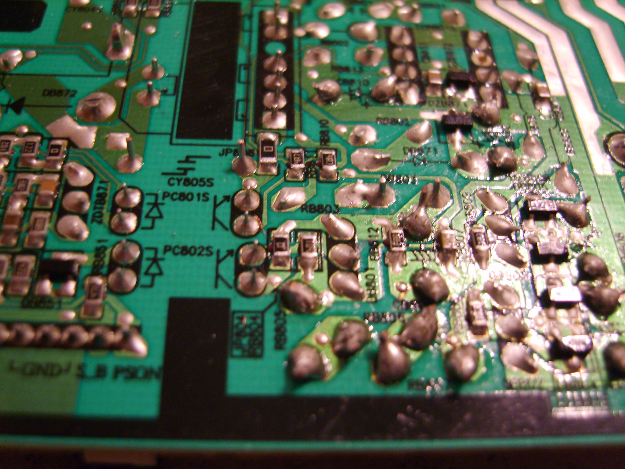

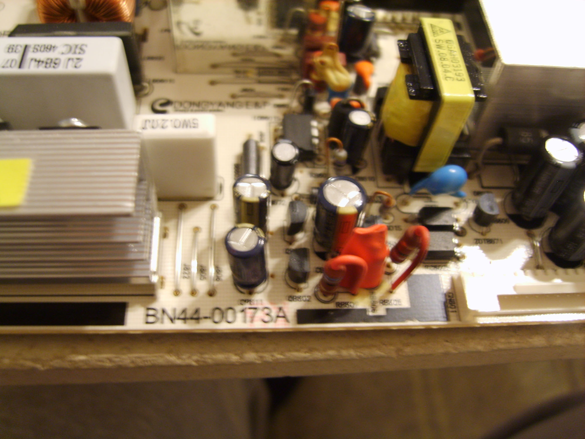

                                I forgot to add, the three resistors on the bottom that everyone recommends to replace are all stuck together with this weird yellow gunk. I tried to gentle wobble the resistors, but this stuff has a death grip on them. What is it and how do I safely remove it so I can replace the resistors?
                                • retiredcaps
                                  • Apr 2010
                                  • 9271
                                  Re: Samsung Syncmaster 245B - Screen freeze -> screen flash 4 diff colours
                                  That was new white glue when assembled at the factory to hold the components in place. After time and heat it turns color and can be conductive.
                                  You can use whatever (exacto knife?) to remove it and when you replace the resistors just install them that so they are not touching. You don't have to replace the glue, but I think you can use silicon caulk to hold them in place to ensure they don't touch.
