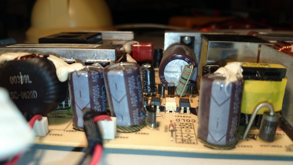

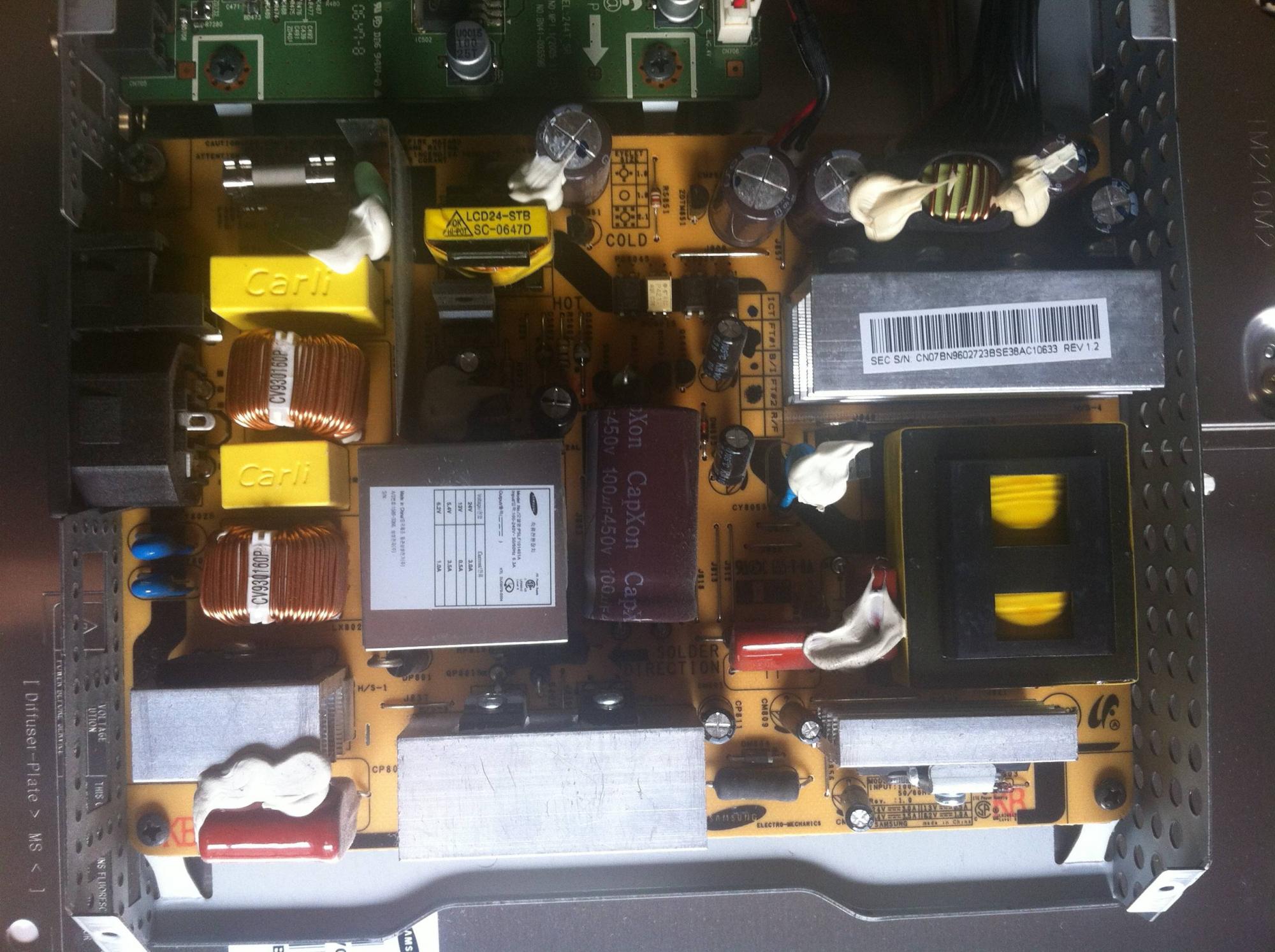

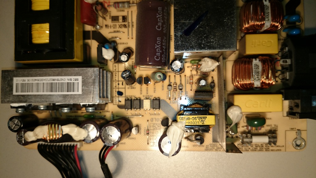

      Sure here are some pictures from earlier before the fix. top view still shows original caps, will take a couple more new pics when I get time later to take it apart again and replace the remaining.
        Re: Samsung 244T Troubleshooting
        Thanks - cant just see what I wanted to see - never mind - i guess you have checked the Big cap for bulge at the end. There will be a small start up cap on the primary {hot}side , but there are a few on this board and I cant see which -it is often a 47uf50v or 68uf50v but you should catch it if you replace all.
        There is quite a bit of solder splatter where you have soldered - you should clean it off (old toothbrush) in case it gets moved and causes a short.

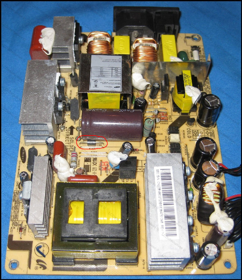

                What the element B801? What are its characteristics and the name?
                  https://www.badcaps.net/forum/showthread.php?t=39740
                    #29
                    Highlighted in red.
                      #30
                      OK cant really see it - if it is D801 then it would be a diode.
                      If definitely B801 then it could be a ferrite bead. You can only really test them
                      for resistance - if it is open it is dead. I dont think they often go bad.
