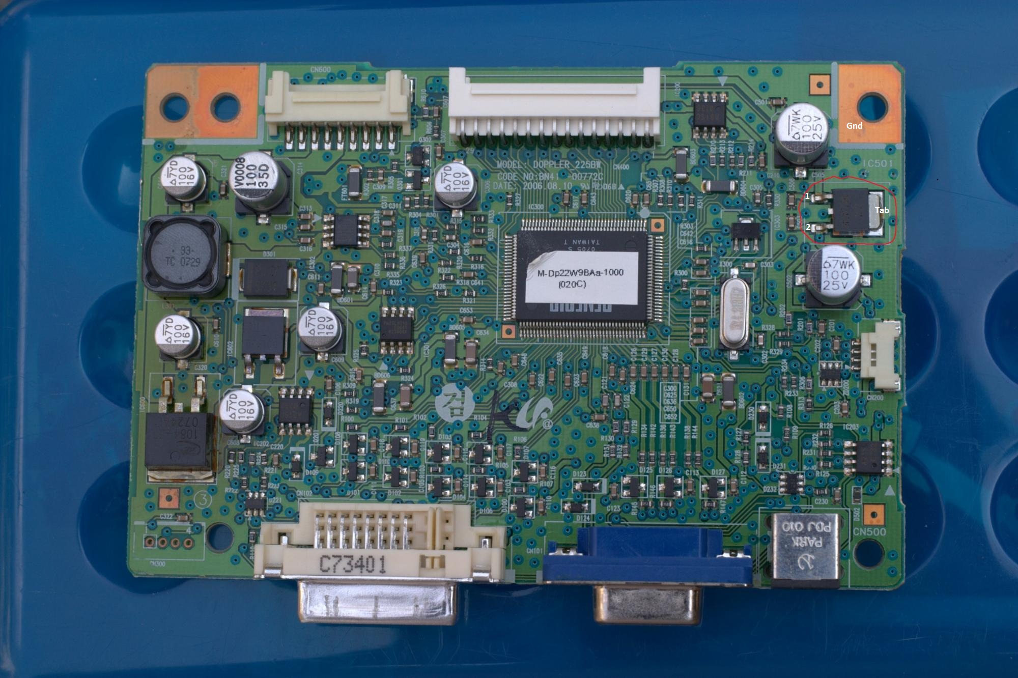

    First off the help on here is awesome. That being said I think I have a bad component on my dvi/vga board and i'm wondering if someone
    can help me figure out what.
    I have a Samsung 225BW monitor. The blue power LED comes on but no images is displayed. I swapped the vga/dvi board from a working monitor and an image displays.
    None of the caps on the power supply show signs of degradation.
    Here is a picture of the board in question.
    Any thoughts as to what I should be looking for to troubleshoot this further?

    There are a few points to check. At about 2 O'Clock is a 1084-33 LDO regulator. Check the output voltage. At about 3:00 there is a similar regulator; this is a 1.8 volt regulator. At about 8 O'clock is IC 501. What is the part number of that?

      IC501.. To make sure I have the right PN. It's the item circled in red?
      If so that PN is Ji7i 78012at4s(?) not sure about the last two digits.

        That's the part I'm interested in. What are the voltages on the three pins?

            Those numbers don't add up. Note the attached picture. Use the copper mounting pad just above it as ground. What are the voltages on pins 1, 2, and Tab?

                You are seeing what I would expect. Note there was a typo in your first report. You said there was 13.8 volts in, 12.02 volts out and a difference of 1.057 volts between input and output.

                    Not really. The best option would be to find a used signal card on eBay.
