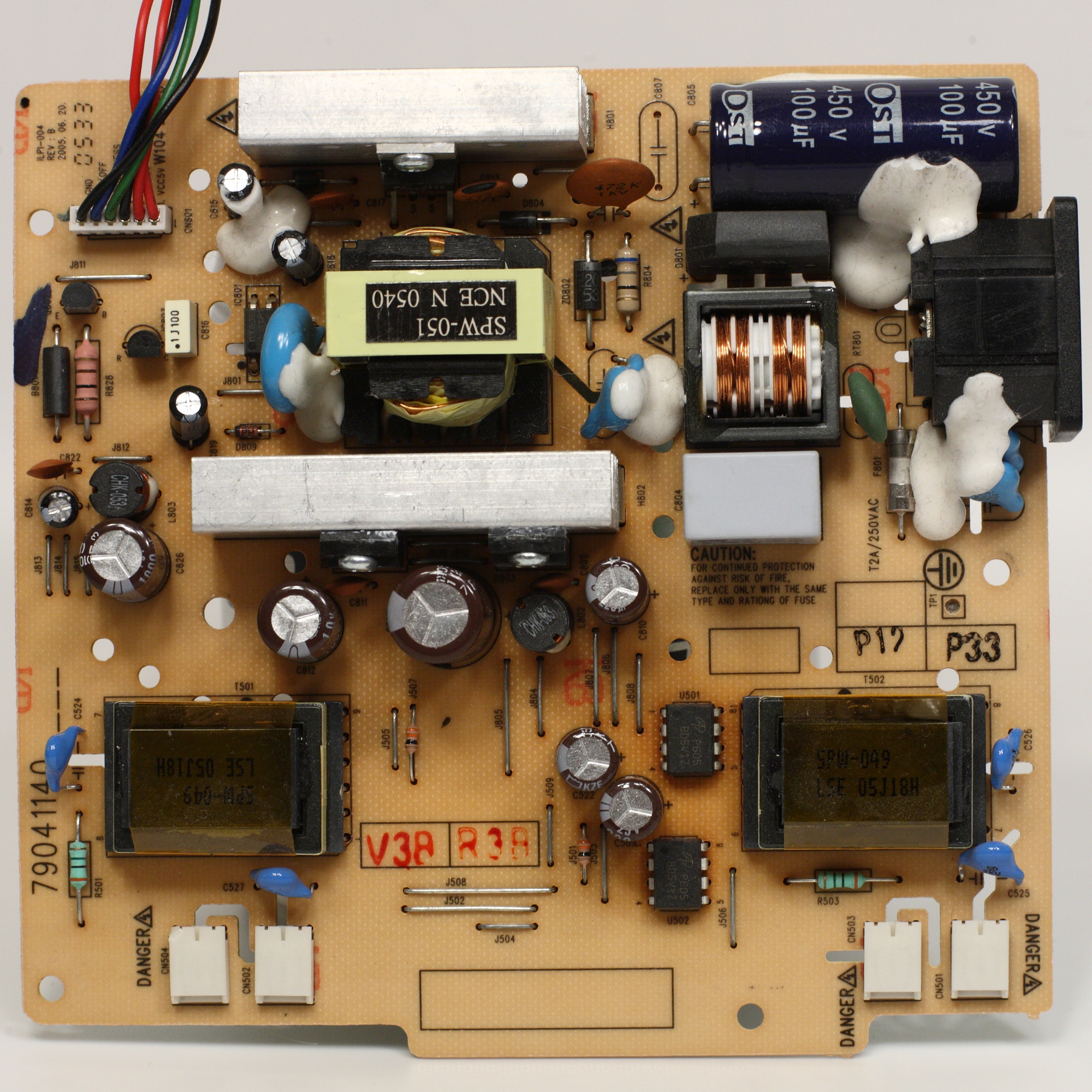

    I have 9 Viewsonic 19" VA902 monitors that I am recapping. I first disassembled them and found bad caps in all of them. I put in a Digikey order for enough to fix them all. I was very meticulous in keeping the LCD screens of each one with the original display controller board. Two nights ago I removed all the bad capacitors from the PSU board, but left one in-tact for an example to reference while I put on the new caps. Today I got the order in and started to recap. After 3 montiors back together, not a single one works properly (1 the backlight is not coming on [likely a loose connection or something], but the other two are green and flickering). I can still see my desktop on it, but all the pixels have a green tint. What have I possibly done wrong. Before disassembly I confirmed all the monitors exhibited the two second power-off symptom of bad caps, and none of them had any kind of bad tint to them. Please advise.

    The power supplies are not individualized for each monitor, so some other problem is occurring. Your technique is good - keep one 'reference' board.
    The fact that there are three failures indicates some sort of common problem, either soldering technique, handling, or the components you installed.
    As a first step, check the location and orientation of the caps you installed in one board to those in the 'reference' board.
    Next, list the value, voltage, brand, and series of the original caps, and the same information for the replacements, and post it here.

        The old caps were all Su'Scon brand (I'll have to check the series later) with the following ratings:
        (1) 25V 1000uF
        (3) 25V 220uF
        (2) 10V 1000uF
        I replaced all of them with Nichicon VZ series caps of the same capacity. All polarity is correct. I will take pictures sometime tonight, or early next week and upload them (front, back, and ribbon cable to the LCD). My power supply board looks considerably different than the one depicted in the old VA902 thread. Also, I realized this morning that my reference board is gone, so I think late last night when I did the fourth one, I accidently installed it into one of the monitors with the old, busted caps still on.

          Nichicon VZ is a general-purpose series, not low ESR.

                  Order and replace the caps with low ESR.
                  You have 4 monitors one has no back light and 3 with strange colors.
                  Try a different VGA cable, or at least Bend and flex the old one see if the color changes.

                    Take the unmodified power supply / inverter, hook it up to a signal board, LCD panel, and VGA cable that exhibited the greenish tint. If it has a greenish tint for the two seconds, the problem is NOT the power supply.
                    The flickering DOES indicate a problem with the inverter or inverter supply.

                      Thanks for the help guys. I have ordered new caps for all the monitors (United Chemi-Con KZE series). Should be in next week, I'll repost when I get them in and installed. Should have been more diligent before making the first order.

                        Just to follow up, the United Chemi Con KZE caps have worked wonders since September. I have fixed (13) VA902B monitors, and six other makes/models since then. I have been credited with saving my company thousands of dollars. Thank you PlainBill, jsog and alexanna for your help.

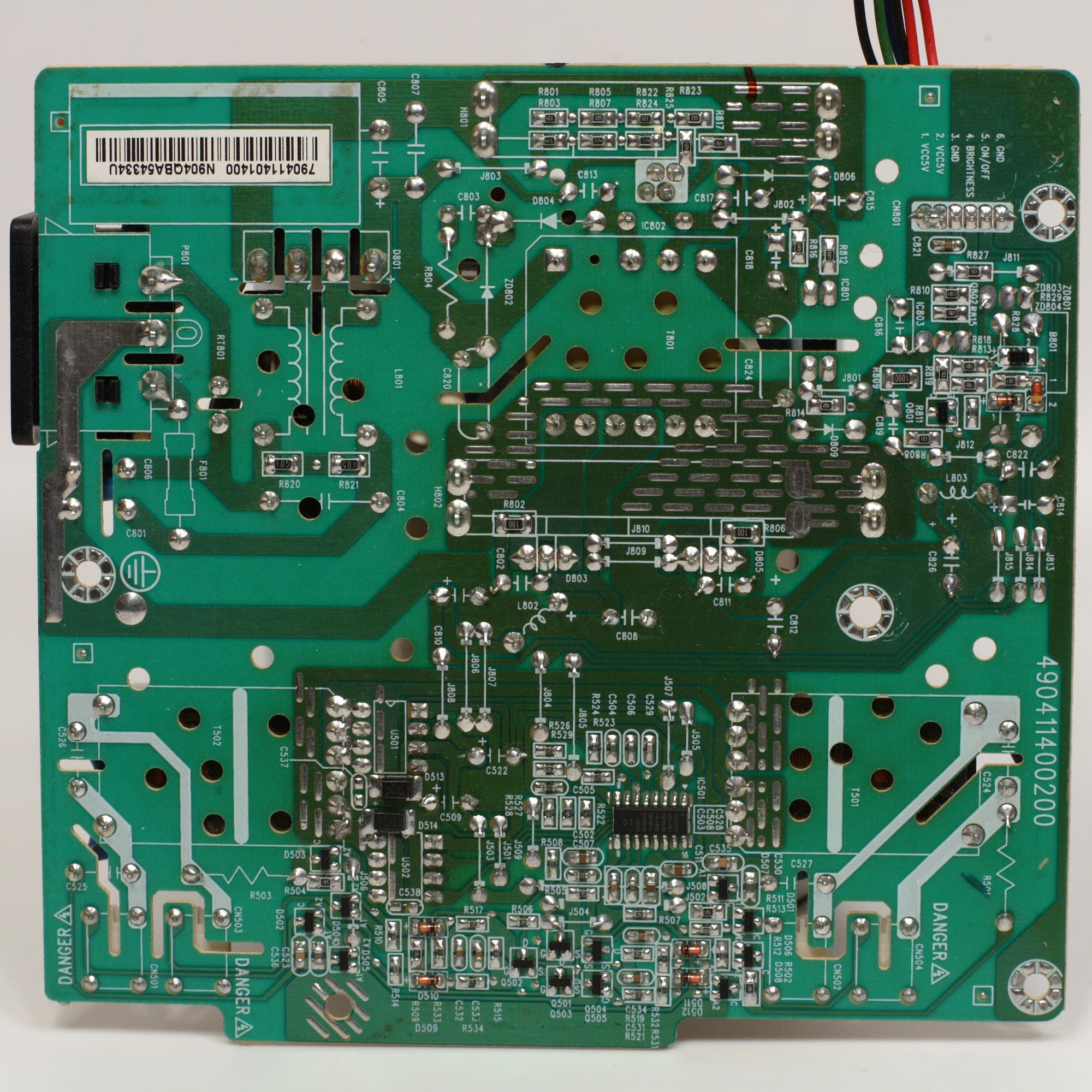

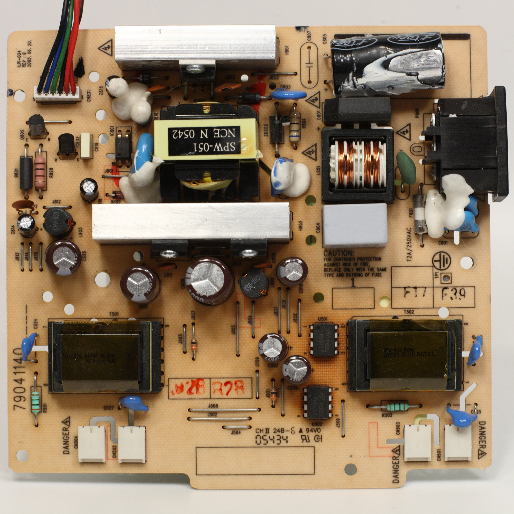

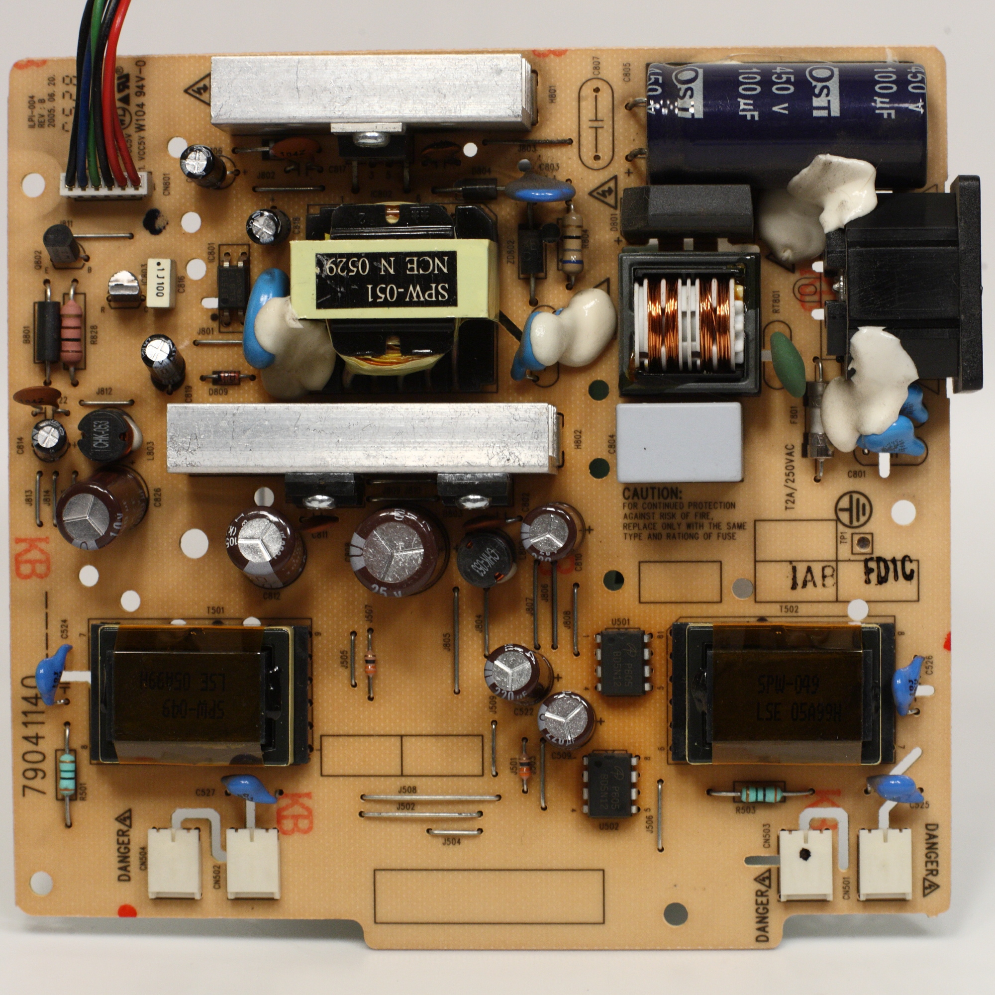

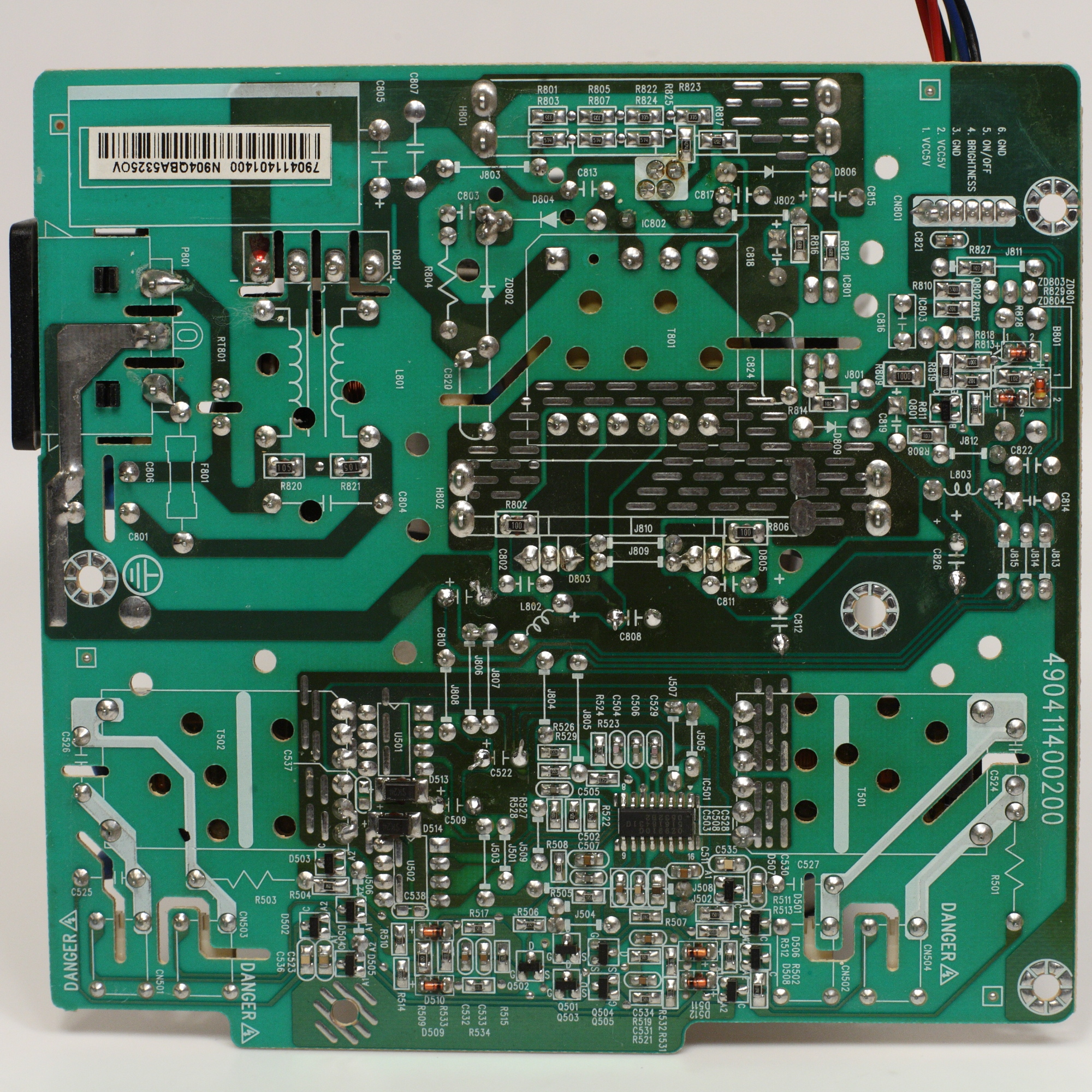

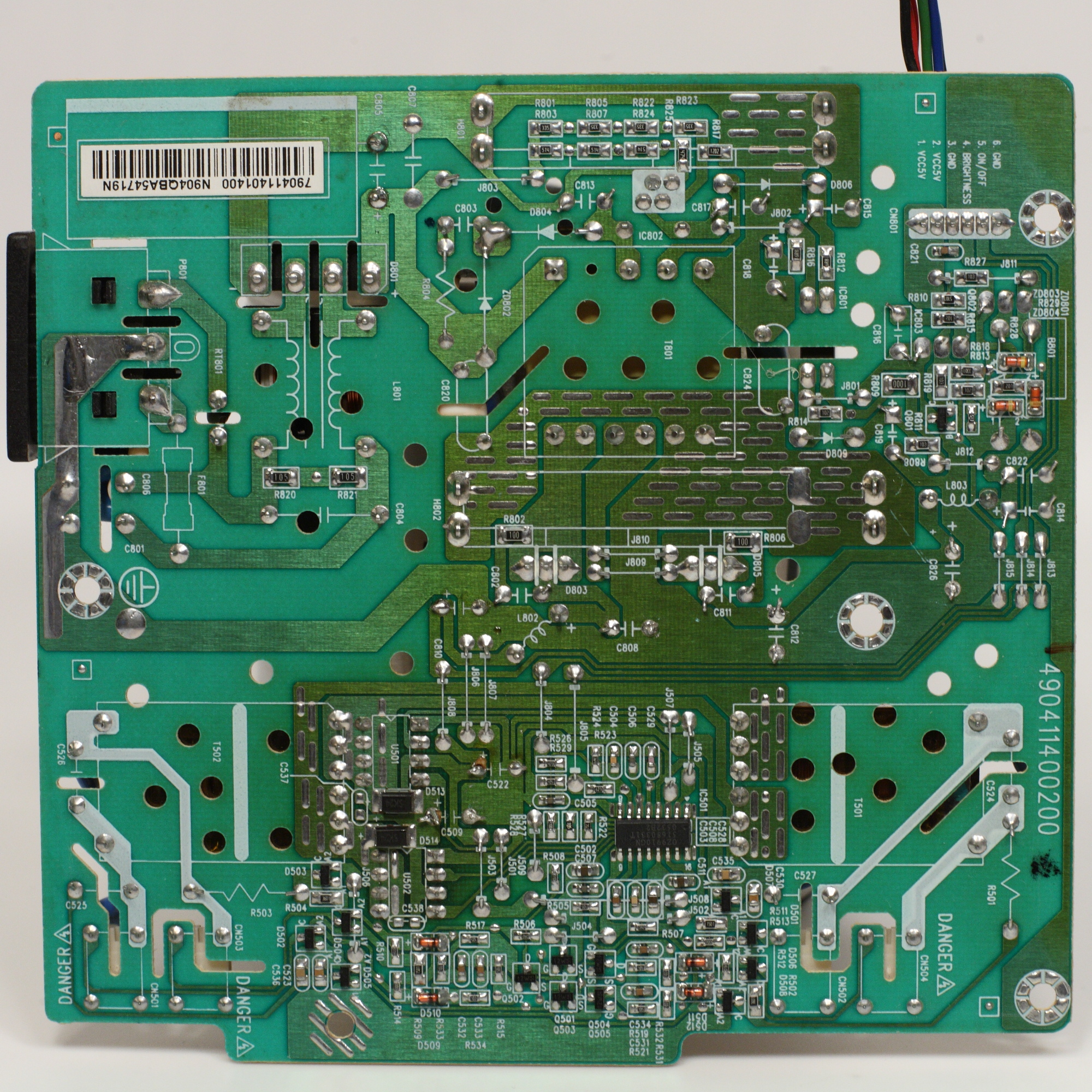

                            Update on my monitor project. I have successfully repaired 31 monitors for my company to date (including 23 of this exact model). However, there are 3 monitors [of this model] I have not been able to make fully functional (despite recapping with KZE on all 6 filter caps), and by constructing many permutations of known good parts, I have determined that all 3 have issues solely with the power board. Monitors A & B have the same problem, and Monitor C has a different problem - I'll explain them below:
                            Monitors A and B -
                            LCD display works fine, but backlights do not function at all (confirmed using separate power supply for backlights)

                              U 501 and 502 are AP605..these regularly fail on other Power supplies,so would check them.Also compare resistance readings from good boards on the Inverter transformer secondaries,.
