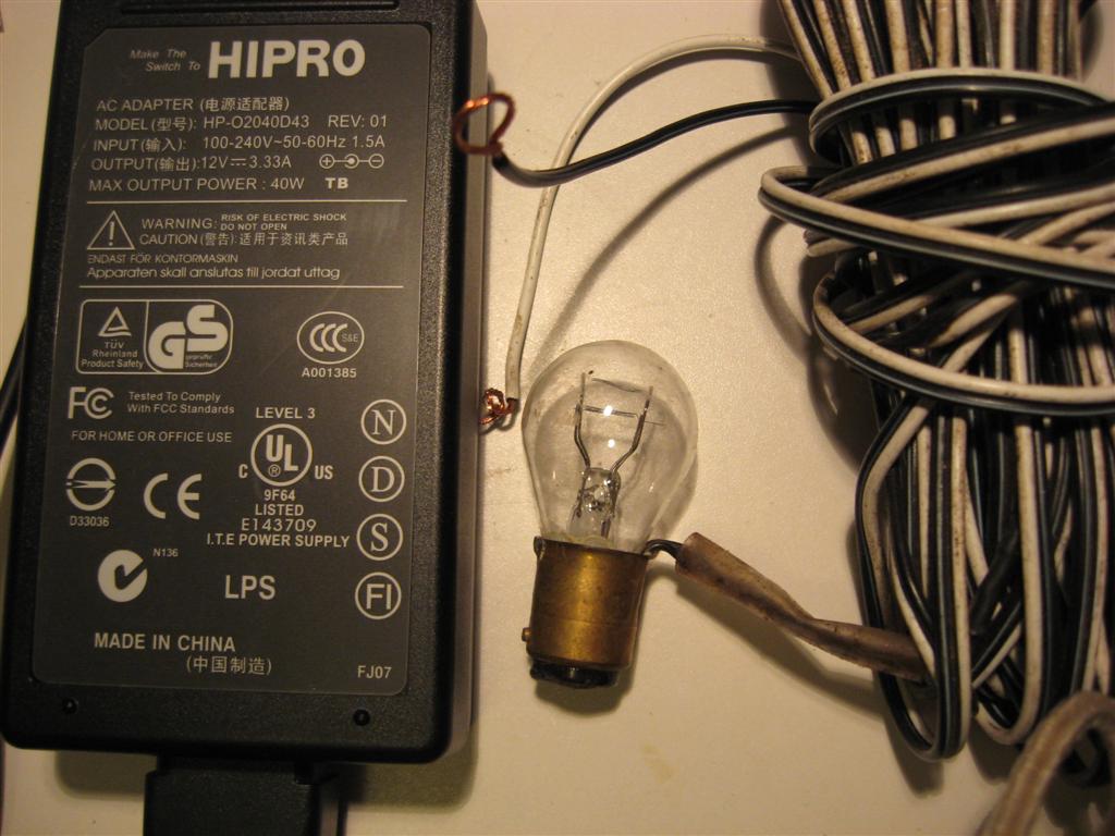

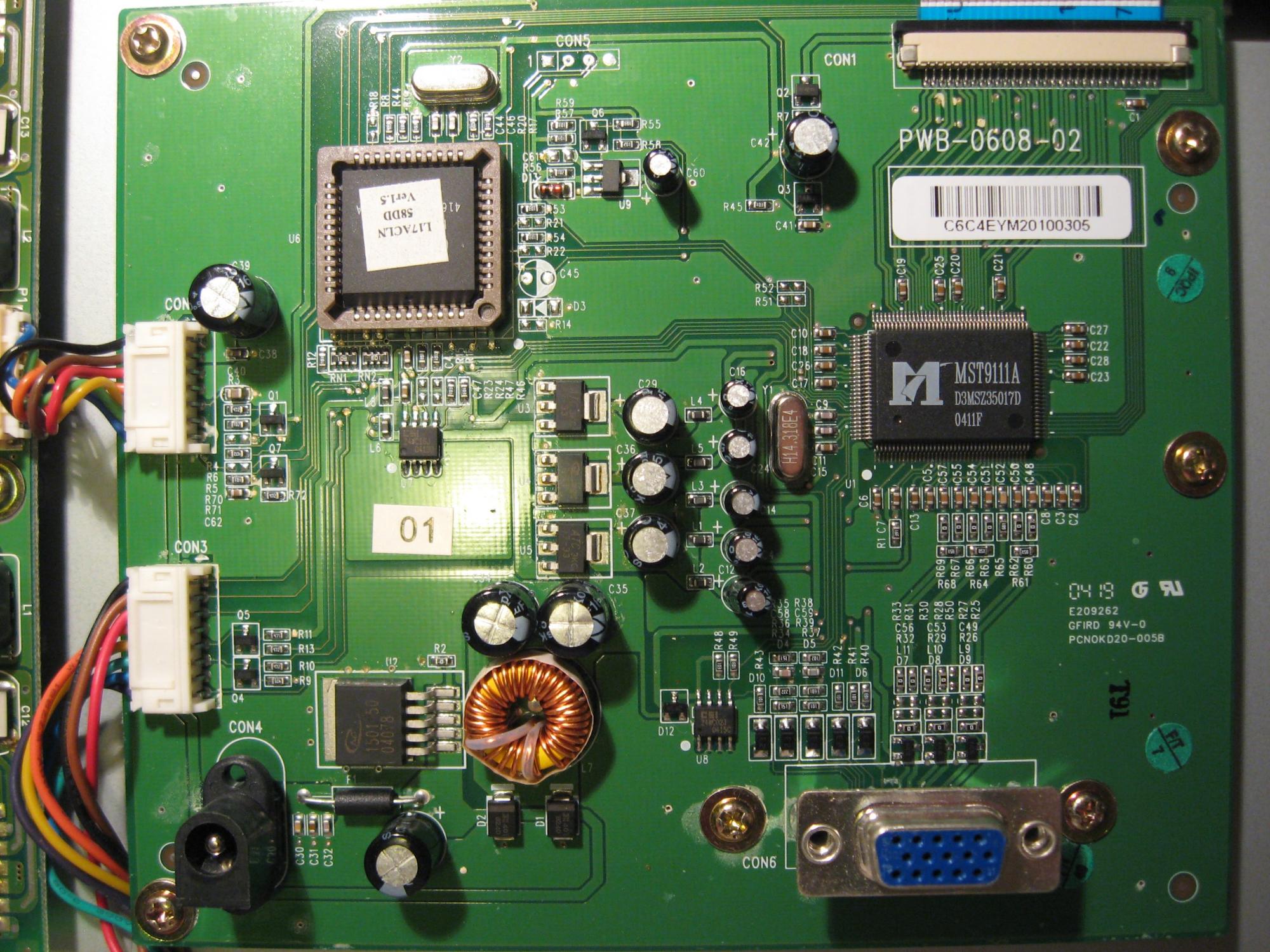

    Rec'd three of these monitors. All have the same symptom. Flash of display, then black. Power LED is yellow all the time.
    I only have a single power supply, but it appears to be working. Tested it with a small load (12v light bulbs) and voltage drop was 12.6 down to about 12.2v.
    A word of warning. I an NOT a electronic technician. I am a aircraft mechanic by trade and can 'figure things out' when I set my mind to it. I know how to use a multimeter, but that's about it. While I understand most electronic concepts, I seem to struggle with how those concepts interact with one another.
    I have been reading for a couple of days about bad caps. I have investigated the circuit boards, but have not been able to identify any suspect caps. I have searched the board for my model monitor, but have not seen boards like this one.

    What is the output rated amps on the power supply, and did your test lamp put a significant load on the power supply. An automotive 12v circuit tester/light may not.

      Re: Planar PE1700-BK monitor
      12 @ 3.33A
      and did your test lamp put a significant load on the power supply. .
      It was a towing trailer harness with bulb soldered in.

        If that's an 1157 type tail light, the total load is about 2.2 Amps if I recall correctly. I've got a similar jig and got burned when a power brick would supply enough current for the lamps, but would fail on the monitor. (Wasted a LOT of time with that one).
            I have not been burned using Turn signal bulb YET. But knowing me it’s bound to happen.
            I would think as long as you see above 12v under a load at the fuse when you try to turn the monitor on, you are OK.
            I think it would be unusual for 3 monitors to have the same identical problem; really the only thing in common is the power supply.
            However for right now try taking a load off the monitor, remove the flat cable from the logic board to the LCD panel. Is there any change in the behavior of the PLED or the backlights.

                      Ok. Connected the ribbon back to the monitor. Connected it to a laptop and I get the image of the laptop on the monitor for the same 1/2 second interval.
                      • alexanna
                        • Mar 2010
                        • 1346
                        Well its what we call 2 seconds to black.
                        If you use the advanced search feature RetiredCaps has a very informative guide,I would suggest reading it particularly about CCFLs and substitution.

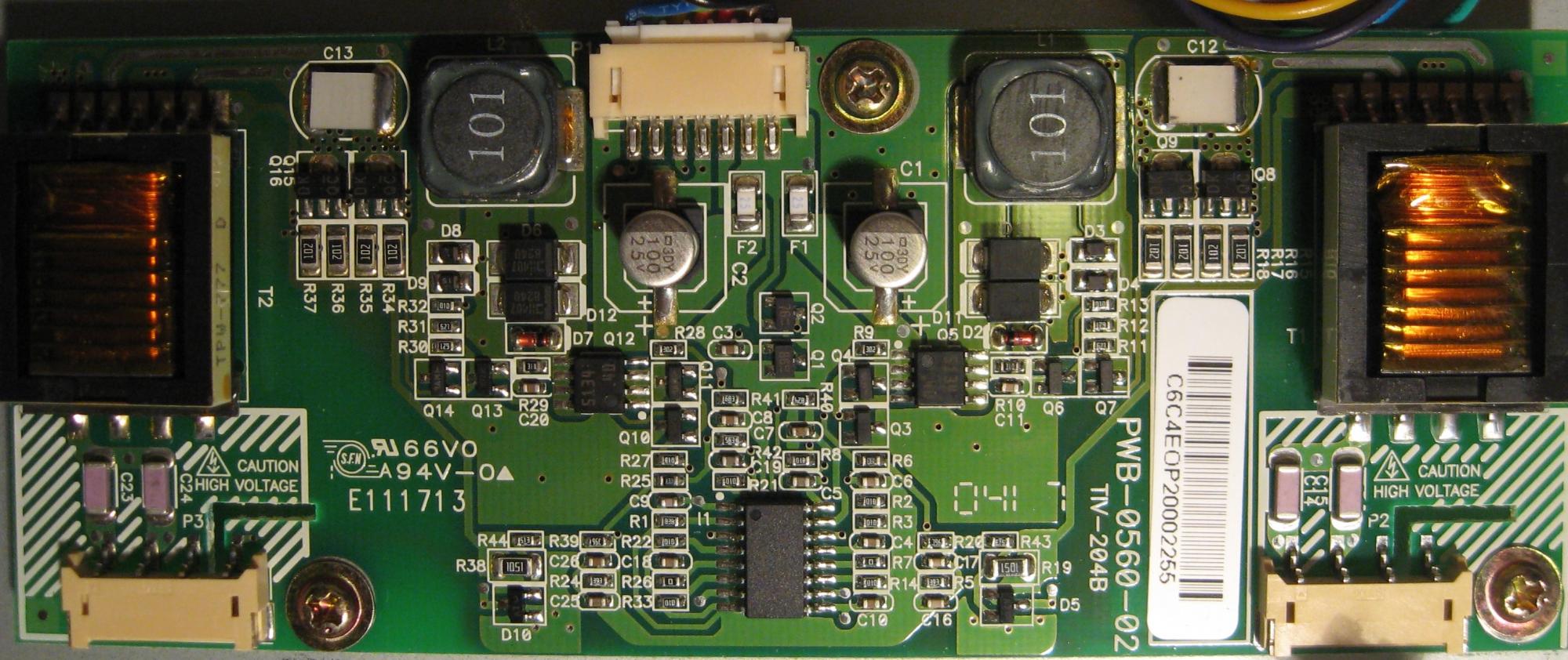

                          All of these tests are to be done with power off, and can be done without removing the components from the board.
                          On the inverter, check the resistance of F1 and F2. Also, on that connector pins 1 & 2 are power, pins 3&4 are Ground. What are the voltages on pins 5, 6, and 7? Try to get readings when the backlights are on, and when they are off.
                          And last (for now), if either F1 or F2 is open (more than 10 ohms), check the transistors Q8, Q9, Q15, and Q16 for shorts.
                          Yeah, our old friend the Royer oscillator.
                          Oh, and the pictures of the inverter are superb - I can even tell the transistors are Rohm 2SC4672.
                              Both are about .6
                              I do have 12v on 1 & 2.
                              5 is about .1 vbc anytime and 6, 7 don't read anything.
                              Oh, and the pictures of the inverter are superb - I can even tell the transistors are Rohm 2SC4672.l
                              I even went back to look for the transistors because it's easier.
                              If I need to check the Q's, you'll have to instruct me on that.

                                    OK, let's go back to the basics on this. Unplug power from the monitor. Set your DMM to the lowest resistance range, usually 200 ohms. Touch the probes together. What reading do you get? Now place 1 probe firmly on each end of F1. What reading do you get? Now place 1 probe firmly on each end of F2. What reading do you get?
                                    The difference between the reading across each fuse and the reading with the probes touching is the actual resistance of the fuse, and should be less than 1 ohm for each fuse.
                                    Now switch the DMM to the 20VDC range. Plug in the monitor and have it hooked to a computer displaying a desktop or something similar. Hold one probe on pins 3 or 4, and the other probe on pin 5. Press the power button several times at 3 to 5 second intervals. I would expect to see 0 volts when the power LED is off, and some voltage (typically 3-5 volts) when the power led is on. Move the probe from pin 5 to pin 6 and repeat. And again, to pin 7 and repeat. Also, do you get a flash of the display every time you push the power button and the power led comes on?
                                    Very briefly, I suspect what you are seeing is 'Two Seconds to black'. With that problem the signal board is turning the inverter on, the inverter controller detects a fault condition, and turns the CCFLs off. The inverter receives two signals from the signal board - On/Off and Brightness. Each should have some voltage over 2 volts, and be stable while the power LED is on.
