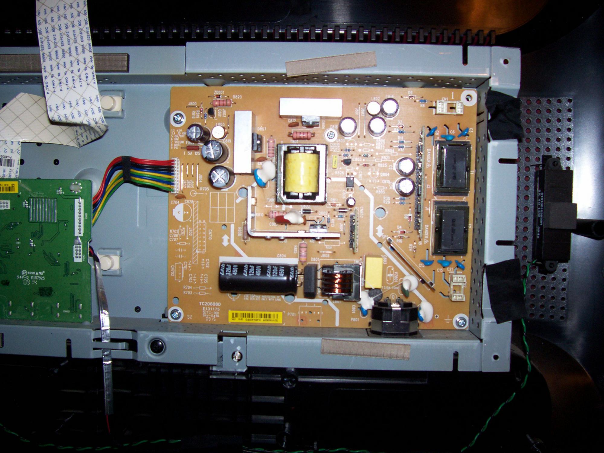

    Well that said I have a problem with a Hannspree HF237 monitor.
    I have replaced the caps and still seems to have an issue with 2 seconds on and blank,
    Power led stays lit.
    I have read about the 2 second problem and using a flashlight to see if the backlights are off.
    Dont really understand how to do this to be honest.
    Do I shine the FL into the screen and see if I can see the image?
    Or do I need to get behind the screen?
    From the front I see nothing fyi.
    That newb question asked.
    I have replaced the caps and still have the problem.
    Nothing visually appears damaged or otherwise unusual on the board.
    It will run for hours and then when the power is cycled (reboot or via power switch) it may not come on except for a brief time or not at all.
    If left on it may start working. And may not.
    If it does it will be 5 minutes before it does then it goes blank after a few seconds again.
    It started initially with taking longer and longer to come up.
    This progressed to what it does now.
    At a loss to where to look now.
    Thanks for any brainstorming offered.

    Better a longer post than one with little useful information. (We just love the "I have a monitor itson't work rite tellm e howe to fixit." posts - I just ignore them. Still, you faile to provide a couple of vital pieces of information.
    I've had very little success with using a flashlight. The idea is to hold it at an angle and verify you can see an image on the screen.
    The symptoms are contradictory. A monitor taking longer and longer to come up typically is caused by bad caps. What brand and series did you use? * At the same time, the behavior of the CCFLs sounds like they may be nearing their end of life. when they first turn on, is there a pinkish tinge to the picture?
    Another thing to check is the resistance of the inverter transformer secondaries. A low resistance can indicate shorted turns.

      Here is a pic of the board.
      I will need to disassemble again to get better ones.
      I want to review the How To for pics also.

        Did you replace the small cap in the center of the board also?
        • ixtlan
          • Aug 2011
          • 12
          Re: Hannspree HF237
          As a matter fact no I did not.
          I overlooked it completely
          50v 10uF brand is Su'scon.
          Is that brand a suspect one possibly?

            Su'scon is a suspect brand - I would say 'replace on sight'. That cap performs a vital function. It's the start-up cap. When it fails the power supply won't start. Of course, it's so small that it doesn't have a vent, so a failure is invisible. And it's inexpensive to replace - under $.50, so I usually replace it unless it is a high reliability brand.

                                      Transformer readings:
                                      Meter set to 20k ohms
                                      Transformer has 4 pins on one bank and 5 on the other.
                                      I assume the 4 pin is the primary (1-4) and the 5 pin is sec (5-10)
                                      Primary
                                      1-2 = 0.00
                                      1-3 = Open
                                      1-4 = Open
                                      2-3 = Open
                                      2-4 = Open
                                      3-4 = 0.00
                                      Any Primary to any secondary = Open
                                      Secondary
                                      5-6 = Open
                                      5-7 thru 10 = 0.00
                                      6 - 7 thru 10 = 0.00
                                      7 -8 thru 10 = 0.00
                                      8 -9 thru 10 = 0.00
                                      9 -10 = 0.00
                                      So I am guessing using my rudimentary electrons skills the transformer is good.
                                      Is this a likely conclusion?

                                        The primary will read real close to 0 ohms resistance, secondary side usually will read somewhere between 500 and 1500 ohms, give or take a few.
                                        You may have to remove the transformer from the circuit to make sure your measuring the correct pins.
                                        The primary windings will be the thick ones, and the secondary will be the thin wires. It is recommended that the secondary windings measure within 3% of each other.
