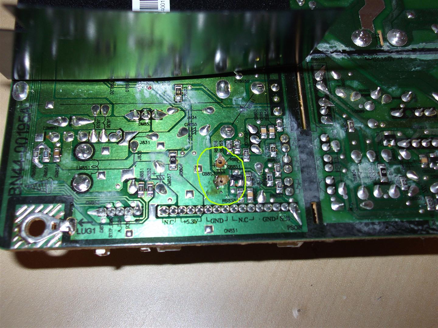

    Im new and probably screwed up, please be kind
    I have 2 Samsung 2493HM monitors, I saw that both of the monitors had a bulging 10v 2200uf cap on the power board and replaced them with a Yageo 16v 2200uf cap. I read that the extra voltage is a good thing, but perhaps I should use a better panasonic cap?
    Monitor 1 - Kinda works now but the color isnt right (too green) and I cant seem to use the menu (tried unlocking and resetting monitor but it doesnt work). Also it buzzes/hums a little. Could this be a cap related problem, should I try replacing other caps or the same cap with a better cap ?
    Monitor 2 - When I removed the cap some of the green PCB came off. Now the monitor LED comes on but the monitor doesnt come on at all, I think I may have ruined the power board? %&!#
    What do people think ? I have attached pictures for the power board which I removed some green off of.

    For monitor 1, did you use a low-esr cap?
    For monitor 2, just clean the green protection a bit and solder nearby. Should be no problem, you are lucky with that big pad.

      Monitor 1: I used a Yageo 105C 16v 2200uf capactior, sorry I cant say whether thats low-esr because I don't know what that is.
      Monitor 2: How would you reccommend cleaning it, and can I just solder where there is some green near it ? I thought it would have to be near/on the fine black line ?

              The Yageo SY series caps are nothing to brag about, but they are one of their low ESR series. I really doubt they are the cause of your problems.
              On the board you performed the exotic modifications, it's not that bad. It's one of the reasons we suggest practicing on a scrap board. If you have another capacitor, install it, but instead of trimming the leads, solder them to the traces past the destroyed area. A PC board is made my laminating a thin sheet of copper onto a fiberglass base. The excess copper is then etched away, and a coat of green solder resist is applied. Simply scrape the solder resist away, apply a small amount of solder to the bare copper, then solder the lead to that point. It won't meet mil spec, but these aren't mil spec monitors.
              As far as the other problems, I suggest marking all boards with either an A or a B, depending on which monitor it belongs to. For convenience, I will say the 'A' monitor has color problems, the 'B' won't turn on. Try the 'B' LCD panel with the 'A' cards. Swap cards back and forth until you determine which cards are defective, then start troubleshooting.

                        I tried to put a new capactior on the "exotic board" and put everything togerther. Now nothing turns on. I think I probably didnt solder on the cap right.
                        You mentioned cleaning the board but I dont think I quite understood it. There seems to be some clear residue on the board. One problem I had even though I read some soldering guides:
                        I preheated and tinned the solder point I have a 15/30w switch solder iron which I put on 15w. I touched the component lead and the area I wanted to solder on and left it on there for a while (perhaps not long enough? - How long?) I then applied the solder to the component lead and solder pad but not my soldering iron, however it didnt want to stick and just leaped towards my soldering iron
                        You also mentioned scrap the solder resist away, could you show me on the pic ? as there is green, dark green and then the firbre glass board.

                          That dark green thing is is to be cleaned. Scratch without putting pressure on it. Underneath it you will find shinny copper.
                          Be sure to use flux to solder.
