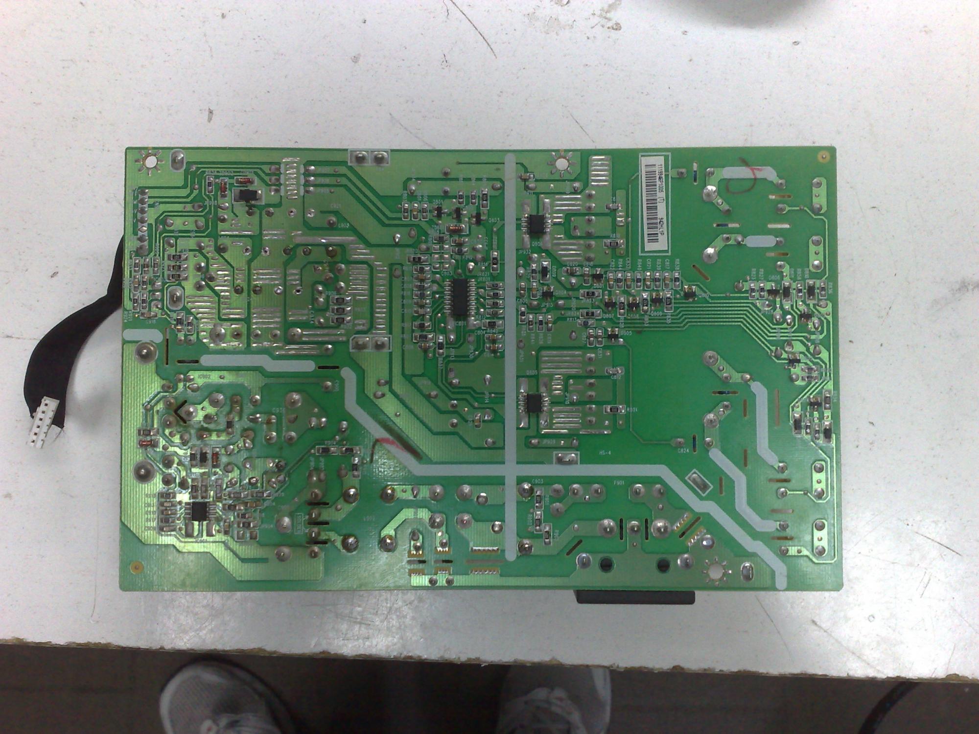

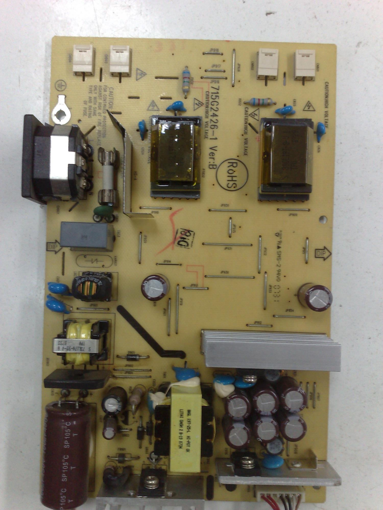

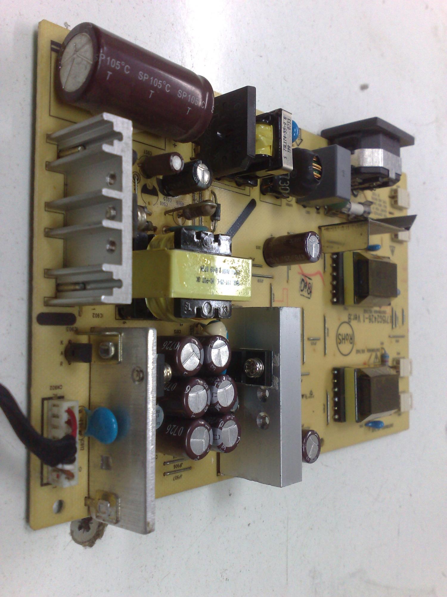

                  Oops i was measuring AC on the large cap.
                  Large cap has DC Voltage 345V, ALL caps have been replaced except those two small starter caps. Yes i am aware of the irony that the monitor won't start and i have not replaced the starter caps. They are not currently on stock and will replace them when they are available.
                  Here are the pictures:
