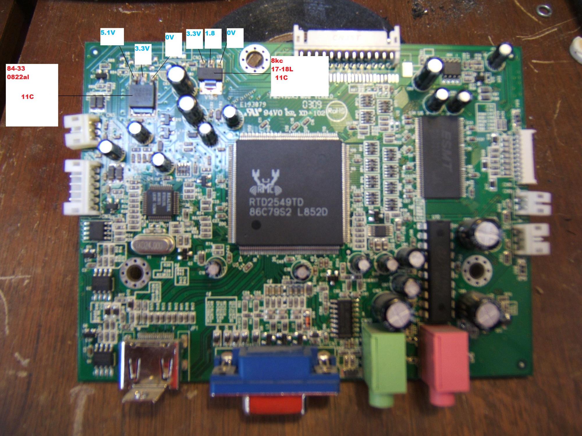

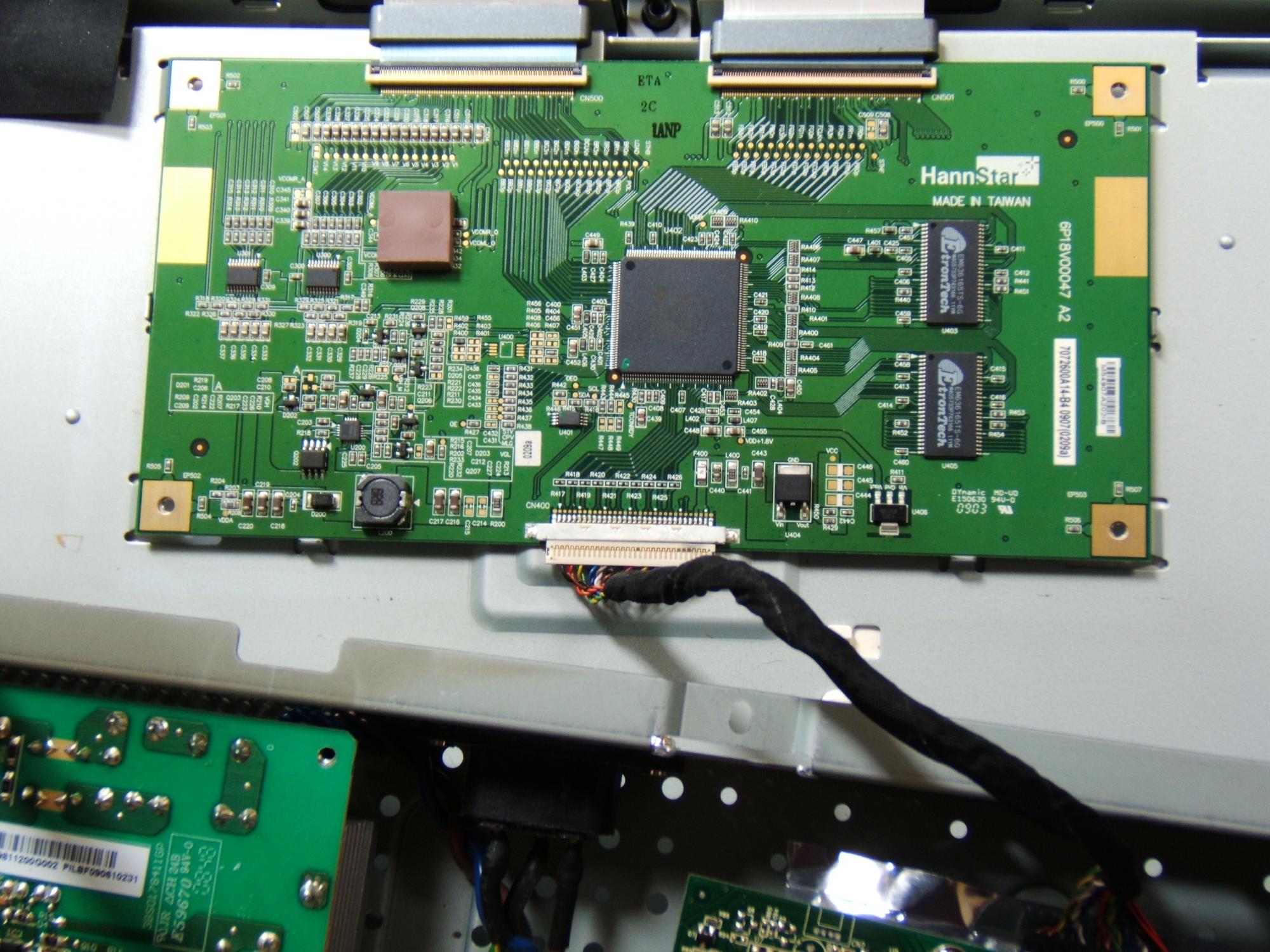

Hanns_G HG281D with flashing/blinking screen problems
  • Barq
    replied
    Re: Hanns_G HG281D with flashing/blinking screen problems
    yep thats where the HDMI port is so can I get a new one of those from the factory or is it repairable? btw, I gotta say you are a very nice person to do this for people like you do, this board is the tops! It is all very appreciated!
    Leave a comment:
  • retiredcaps
    replied
    Re: Hanns_G HG281D with flashing/blinking screen problems
    That is called the t-con or timing control board. If it were bad, the VGA wouldn't work at all.
    I believe the problem to be likely on the logic board.
    Leave a comment:
  • Barq
    replied
    Re: Hanns_G HG281D with flashing/blinking screen problems
    ok
    Leave a comment:
  • retiredcaps
    replied
    Re: Hanns_G HG281D with flashing/blinking screen problems
    Originally posted by Barq
    theres another small board at the top of the monitor, I assume that is for backlighting
    Post a picture of it. The long board is responsible for the the backlights.
    Leave a comment:
  • Barq
    replied
    Re: Hanns_G HG281D with flashing/blinking screen problems
    theres another small board at the top of the monitor, I assume that is for backlighting
    Leave a comment:
  • Barq
    replied
    Re: Hanns_G HG281D with flashing/blinking screen problems
    I also dug out another dvi to hdmi adapter for my video card and tried it. same result.
    Leave a comment:
  • Barq
    replied
    Re: Hanns_G HG281D with flashing/blinking screen problems
    also it started with windows 7 and i have it runnning vista now. Not a resolution problem.
    Leave a comment:
  • Barq
    replied
    Re: Hanns_G HG281D with flashing/blinking screen problems
    nNaw Im aware of that been running common resolution between monitors. I just tried another hdmi and now Im back to the screen flashing on and off and the blue light is on continuosly. It has to be the monitor.
    Leave a comment:
  • retiredcaps
    replied
    Re: Hanns_G HG281D with flashing/blinking screen problems
    Originally posted by Barq
    ok I tried it with the vga and it seems to work ok. I didnt sit and look at it for a long time but it seems fine. YES I can see the bios screen and microsoft startup bar with hdmi but then it goes blank.
    Hmm, I don't run Vista, but if the adapter card resolution setting in Vista is set too high or low, wouldn't the lcd just go black? That would explain why the VGA works, but not the HDMI.
    It also explains why the setup bar is displayed (probably because it is 640x480) and then goes black when Vista tries to load the display driver.
    According to
    http://cms.hannsg.net/onweb.jsp?prod...bno=33333333:0
    Resolution: 1920 x 1200
    Something you can try.
    Hookup via HDMI, put your computer into BIOS setup mode and leave it on that screen for 5 minutes. If it stays on, then you know it is probably a Vista adapter card/lcd resolution problem.
    Leave a comment:
  • Barq
    replied
    Re: Hanns_G HG281D with flashing/blinking screen problems
    ill try that I even swapped the adapter from the back of the video card to the other dvi port and tried it there. still no go Ill see if I can find a hdmi cable, I dont think I have another one. BRB
    Leave a comment:
  • retiredcaps
    replied
    Re: Hanns_G HG281D with flashing/blinking screen problems
    Originally posted by Barq
    YES I can see the bios screen and microsoft startup bar with hdmi but then it goes blank.
    1) If you have another HDMI cable, try another one. HDMI cables can break. Or to verify that your existing is good, try this cable between your blu-ray or DVD player and HDTV?
    2) If you have a blu-ray or DVD player with HDMI output, play your favourite movie and try that for the source and see if the lcd stays on longer.
    3) If you can access the lcd menu, see if there is a reset factory default option. Maybe the hdmi info/parameters are messed up after the power outage?
    Leave a comment:
  • Barq
    replied
    Re: Hanns_G HG281D with flashing/blinking screen problems
    ok 6 of the black transformers are
    2874014900
    M B 0908A but the one in the middle is
    2874015000
    MY0908A
    Leave a comment:
  • Barq
    replied
    Re: Hanns_G HG281D with flashing/blinking screen problems
    ok I tried it with the vga and it seems to work ok. I didnt sit and look at it for a long time but it seems fine. YES I can see the bios screen and microsoft startup bar with hdmi but then it goes blank. Ill get the other info for you
    Leave a comment:
  • retiredcaps
    replied
    Re: Hanns_G HG281D with flashing/blinking screen problems
    Originally posted by Barq
    the power light stays on blue, it will always show the bios screen and on vista it shows the startup bar but goes black after that. I got it to show the screen briefly after turning on and off, but just once.
    1) If you shine a flashlight on the lcd screen, can you see the Vista startup screen (with hdmi hooked up)?
    Im using hdmi , should I test with the old blue vga adapter? cant remember the name of those been so long.
    2) Yes, test the VGA port to make sure it isn't just the hdmi port that is bad. If the screen also goes black with the VGA port, can you see the display by shining a flashlight onto the screen?
    3) What is the part number of the black inverter transformers that sit on the long transformer board? There are 7 of them and they should all be identical part numbers.
    Leave a comment:
  • Barq
    replied
    Re: Hanns_G HG281D with flashing/blinking screen problems
    the power light stays on blue, it will always show the bios screen and on vista it shows the startup bar but goes black after that. I got it to show the screen briefly after turning on and off, but just once. Im using hdmi , should I test with the old blue vga adapter? cant remember the name of those been so long.
    Also Im running an old vga monitor with a vga adapter right now no probs. so I dont think its my compy. oh yeah No sparkles that only happened twice
    Leave a comment:
  • Barq
    replied
    Re: Hanns_G HG281D with flashing/blinking screen problems
    i gotta get the thing up off the couch I have it face down and look at it. be right back
    Leave a comment:
  • retiredcaps
    replied
    Re: Hanns_G HG281D with flashing/blinking screen problems
    Okay, right now, if you hookup a working computer to this lcd, what symptoms are you getting? You can leave all the boards disassembled.
    1) Is the power led on solid and steady?
    2) Is the lcd display working correctly and displaying a picture steadily? Any sparkles?
    Leave a comment:
  • retiredcaps
    replied
    Re: Hanns_G HG281D with flashing/blinking screen problems
    Originally posted by Barq
    ok heres the logic board
    Okay, the voltage regulators are within spec.
    Leave a comment:
  • Barq
    replied
    Re: Hanns_G HG281D with flashing/blinking screen problems
    ok heres the logic board
    Leave a comment:
  • Barq
    replied
    Re: Hanns_G HG281D with flashing/blinking screen problems
    (M)105c, pic with other voltages and numbers in a minute
    Leave a comment:
  • STKR123
    Elitebooks (820, 840 etc. all gens) and those continuously flashing Power LED + flashing CapsLock LED
    by STKR123
    As the Elitebooks (820, 840 all gens) only show flashing Power LED and flashing CapsLock (continuously) + a very soft "ticking" noise near the DC Jack,
    I wonder if re-flashing the BIOS might be of any use here.
    As far as I understood, steady flashing either means insufficient power or a CPU/GPU/Motherboard issue. I use the original 65watt power supply.
    There are so many threads out there, but most of the solutions involve flashing codes, which I dont have or claim that you MUST use the original power supply, do a hard reset, reseat the RAM, clean the RAM,...
    11-03-2024, 06:58 AM
  • JDong
    Problems flashing BIOS for supervisor locked Lenovo V15 G4 IRU 831A laptop
    by JDong
    There was an error... Aborting......I'm using another Linux Laptop with Zorin OS...to try and patch my Lenovo V15 G4 IRU with above specs....It originally had Windows 10/11 installed and converted to a dual boot Kali OS/Parrot OS system. I may have used the wrong lenovo_autopatcher_0.2 (I believe was posted by @knucklegrumble....I am out of ideas and flat broke so i cannot afford another fix (spent it all as an e-com entrepreneur does) any help from anyone would be GREATLY appreciated.....
    • Laptop Model: Lenovo V15 G4 IRU
    • Issue: Forgotten supervisor password.
    • BIOS Chip: GD25B128E (or GD25B128B
    07-06-2025, 10:18 PM
  • learnmore
    Samsung QE55Q60TAUXXU - flashing backlight and flashing standy light--no image
    by learnmore
    Hello Community!
    CASE DETAILS
    Promblem Signs: Backlight on 1 sec off 7sec > repeat && Red standby light: 1blink, off 3 sec, 2 blinks, off 5 secs, 2 blinks, off 3 sec, restart cycle
    13V present on powerboard output. Backlight continues flashing after removing cables to pannel one at a time and even with both disconnected. NOTE: backlight STOPs flashing and remains on when connector between powerboard and mainboard (note Tcon built in) is disconnected.
    Tried inserting firmware on USB and left it in for a few hours, but no change
    03-03-2024, 09:49 AM
  • HTR-Informatique
    Dell G3 15 3500 - Battery bug (black screen and flashing keyboard backlight)
    by HTR-Informatique
    YouTube video of the problem encountered: https://youtube.com/shorts/q7TLNv36LUo
    I am a pro and I have a problem that I have never seen despite my 7.5 years of experience on my own and my thousands of repairs, on a customer's Dell G3 15 3500.
    On this PC I have already changed the complete palmrest because the keyboard was no longer working properly.
    I also changed the screen because the PC fell and the screen was broken.
    I changed the battery with a new and original battery.
    I also had corrosion/oxidation on the...
    02-09-2025, 06:51 AM
