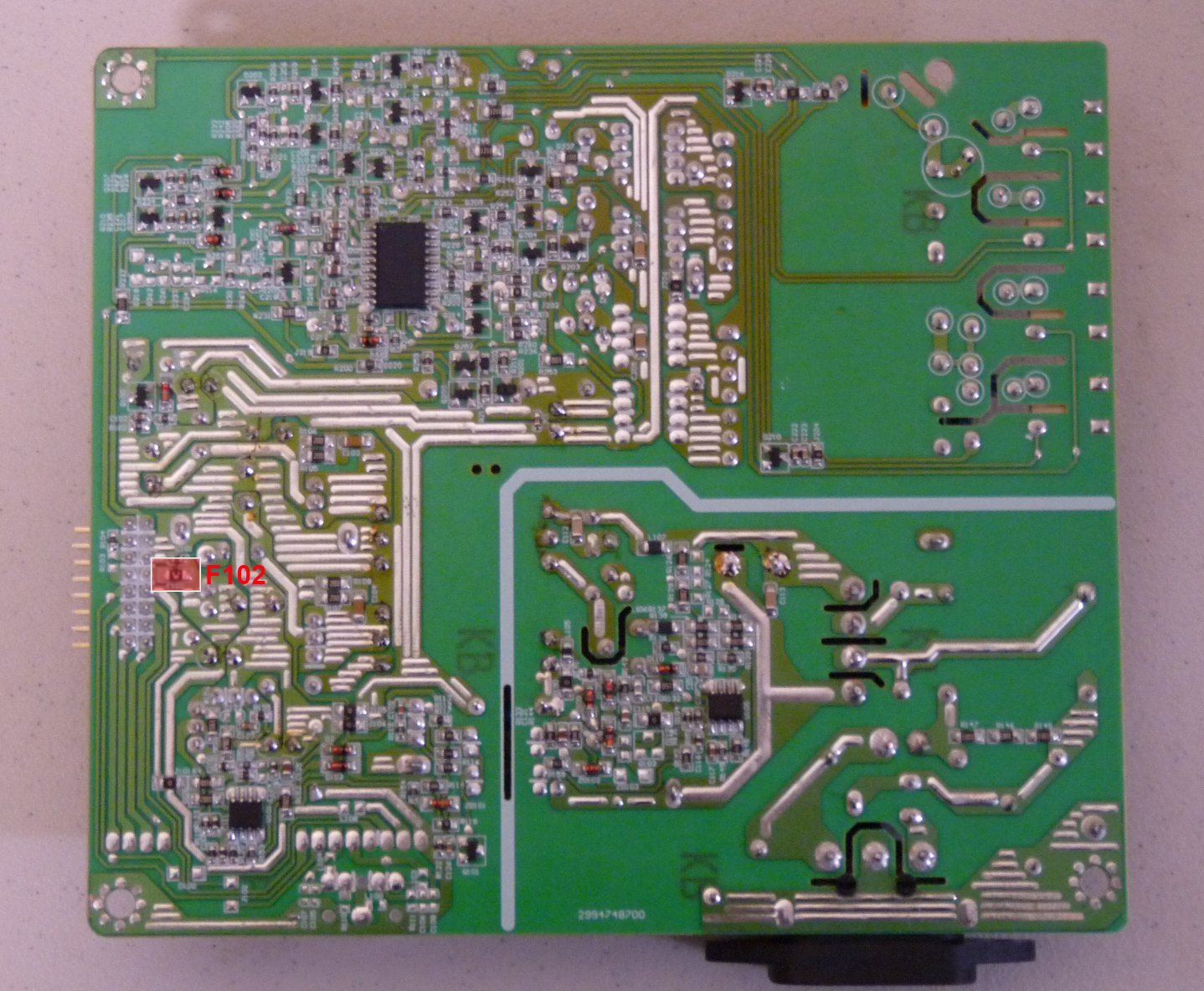

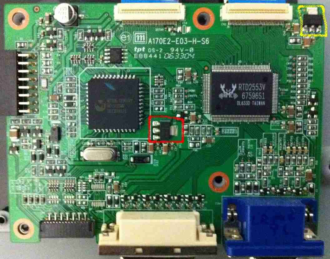

Re: DAC-19M009 dead?
I checked the datasheet but I wasn't sure how to determine the orientation of the chip. I've marked which pins I measured as 1 and 2
DAC-19M009 dead?
Re: DAC-19M009 dead?
That was a good idea- when I removed F200 I still have the same problem (LED flashes once, no voltage on the connector pins to the logic board) so I guess that means its not the inverter?
With the logic board disconnected and no CCFLs, the voltage is about 10.5V and fluctuates a little (say +-0.2V). With the logic board connected and the CCFLs disconnected, the voltage is about 31V and steady the whole time
Interesting, since the max VCC for this chip is 20VDC. Are you placing your probes across pins 1 and 2 ?Leave a comment:
Re: DAC-19M009 dead?
A little Monday morning quarterbacking.
If I understand you correctly, with the logic board disconnected the power supply stays alive?
One more thing that should be checked is a problem with the inverter causing the power supply to shut down. Remove F200 it's the glass fuse in the center of the board,with that removed and the logic board installed recheck the voltages.
Originally posted by PlainBillThe quick and easy test on the TEA1532 is to measure the voltage from pin 1 (Vcc) to pin 2 (Gnd) (DON'T use chassis ground). If the voltage is steady below 8 volts the chip is bad. If it's pulsing, the startup cap is bad, an output diode is shorted, or you have an excessive load on an output of the power supply. If it's in the 12-20 volt range the chip seems to be working properly.
This IC has the rectified mains voltage applied to pin 8, and is prone to failure.Leave a comment:
Re: DAC-19M009 dead?
This IC has the rectified mains voltage applied to pin 8, and is prone to failure.
PlainBillLeave a comment:
Re: DAC-19M009 dead?
A little Monday morning quarterbacking.
If I understand you correctly, with the logic board disconnected the power supply stays alive?
One more thing that should be checked is a problem with the inverter causing the power supply to shut down. Remove F200 it's the glass fuse in the center of the board,with that removed and the logic board installed recheck the voltages.Leave a comment:
Re: DAC-19M009 dead?
This is the one, yes?
http://www.ebay.com.au/itm/IC-TEA153...#ht_1973wt_882
If thats correct, I'll order it
However, wait 24 hours before ordering to see if PlainBill has anything to add to this discussion.Leave a comment:
Re: DAC-19M009 dead?
http://www.ebay.com.au/itm/IC-TEA153...#ht_1973wt_882
If thats correct, I'll order itLeave a comment:
Re: DAC-19M009 dead?
Search ebay for ea1532
I see quantity = 2 for $1.20 with $4 for shipping to Canada.Leave a comment:
Re: DAC-19M009 dead?
1) This SMPS chip has been bad in other lcd cases posted here. Since all the caps have been replaced including the startup cap, this chip could be bad.
2) Digikey sells a replacement for $1.14 at (which I believe is the correct part)
http://search.digikey.com/scripts/Dk...=568-3316-1-ND
3) PlainBill is the real expert on concluding if this chip is bad or not by taking voltage measurements at the various pins.
edit: He gives a good explanation at
https://www.badcaps.net/forum/showpo...7&postcount=20
4) If you have not done smd soldering, see
http://www.youtube.com/watch?v=3NN7UGWYmBYI'll have to look around for where to get a replacement, shipping to Australia comes out at over $30. At the very least, I'll have spare parts for the other Chimei monitors I have
Leave a comment:
Re: DAC-19M009 dead?
1) This SMPS chip has been bad in other lcd cases posted here. Since all the caps have been replaced including the startup cap, this chip could be bad. That is my best guess at what is causing the voltage to drop.
2) Digikey sells a replacement for $1.14 at (which I believe is the correct part)
http://search.digikey.com/scripts/Dk...=568-3316-1-ND
3) PlainBill is the real expert on concluding if this chip is bad or not by taking voltage measurements at the various pins.
edit: He gives a good explanation at
https://www.badcaps.net/forum/showpo...7&postcount=20
4) If you have not done smd soldering, see
http://www.youtube.com/watch?v=3NN7UGWYmBYLeave a comment:
Re: DAC-19M009 dead?
Wasn't able to get alligator clips, I ended up just doing it
When I turn it on, the voltage is about 340V, it does jitter a little for the first couple of seconds but I think that is just lag on my multimeter (it doesn't drop to zero instantly when I remove the probes). The voltage sits at 340 the whole time (I'm in Australia)Leave a comment:
Re: DAC-19M009 dead?
If you have aligator clips, use them to attach to the big cap to take DC voltage readings (since you are not comfortable with live voltages).
Clip the aligator leads (red to positive, black to negative). Turn on the lcd and watch the DC voltage. It should be around 160 to 165V DC. See if this voltage drops or fluctuates. Make sure to note the voltage in the first 3 seconds and afterwards.
Aligator clips allow you to take readings hands free can be purchased pretty much anywhere and look likeLeave a comment:
Re: DAC-19M009 dead?
I know your logic board is good, but I'm curious about the voltages on the 2 circled voltage regulators (red and yellow).
Put your black probe on the ground screw and red on each pin (not the tab). Report
a) part number of each
b) DC voltage of each pin
When measuring these DC voltages, is the power LED on or off? The logic board controls this power LED.
Both the regulators have written on them
EH16A
621J15
Now when I turn the power on, the middle regulator's lowest pin reads 5V, the big pin about 3.6V, and the others are I think zero. However, 3 seconds later the LED blinks on, and then everything drops to zero. That would probably explain the LED turning off. So I thought I should check the connector pins from the inverter board going into the logic board.
When disconnected, the top two pins read 13.6V and 5V respectively, and they did that as long as the power was on (from my previous measurement). Now, when I turn the power on, they read 14V and 5V. Pretty much exactly 3s later, there is a quiet clicking sound, and both of these drop to zero. The voltage drop is gradual, and I bet if I recorded it, the result would be something resembling an exponential (so it drops to say 1V very quickly, and then slows). The clicking sound just about coincides with the LED lighting up. So right after the LED flashes on, there is no power going into the logic board!
There is still an electrical buzz from the big cap area, it is there the whole time (even after the LED turns off)Leave a comment:
Re: DAC-19M009 dead?
I know your logic board is good, but I'm curious about the voltages on the 2 circled voltage regulators (red and yellow).
Put your black probe on the ground screw and red on each pin (not the tab). Report
a) part number of each
b) DC voltage of each pin
When measuring these DC voltages, is the power LED on or off? The logic board controls this power LED.Last edited by retiredcaps; 06-10-2011, 10:27 PM.Leave a comment:
Re: DAC-19M009 dead?
The start cap is usually "entry level" low ESR like a Panasonic FC. You should replace even though the secondary voltages (13.8V and 5V DC) are present.Leave a comment:
Re: DAC-19M009 dead?
No luck. I have the inverter connected to the logic board and none of the CCFLs plugged in, but the light still flashes on once and then stays off. As with before, the board doesn't make the sound that I uploaded, it only does that when it is disconnected from everything else.Leave a comment:
Re: DAC-19M009 dead?
Let's try this. Hookup all the boards without the ccfls plugged in (disconnect all ccfls). Does the power LED stay on now?Leave a comment:
Re: DAC-19M009 dead?
Leave a comment:
by double_DDHi all,
As the title suggests, how can I be sure that my EC chip is really dead?
I've recently gotten into this hobby of laptop repairs, and have successfully brought back to life a couple with some easy fixes, mostly shorted caps.
Now I'm working on HP Probook 455 G8, that had some "devil" run around on 3V line, burning a bunch of stuff. Luckily I have a dead 455G7 (for spare parts) so I managed to fix it (swapped burned parts) to a point that it will charge (both on barrel jack and usb-c), but it doesn't want to turn on. There is a 3V3 on a keyboard... -
by whirlpoolHello everyone
IMac model 2017 intel i5 Completely died after updating the operating system , no lights are on the board. I changed the power supply before just to gain experience, but again the problem has not been solved .. I have done a lot of research about it ...
I checked the SMC U5000 and pp3v3 pp5v. If you look at the schematic, the first light is called le0301 with the abbreviation in pp3v3 S5 circuit. before this I get 12 volts, 5 volts and 3 volts in U7600 well. but after U7600 and before reaching LED1_S5 everything is cut off . I reflowed the u5000 with a temperature... -
Hello everyone hope all doing well!
I have this PSU (GPS450-AA delta oem) around for like 4-5 years and I had it recapped early 2020 or 2021 with mostly UCC KY and Nichicon PW's. The bulk was and still is fine, the original Ltec's were bloated and empty. The previous issue was some major coil whine noise and at times random shutdowns when going idle. Today it started tripping the mains breaker and I think I have dead APFC mosfets (20N60C3). Right now upon checking I have the Q1 and Q3 FETs dead so far and I guess those are responsible for the PFC circuit. The only thing I care is If there...3 Photos -
by BetonHi guys!
I searched for the term "dead short" in the forum but no specific thread came up however if I'm just blind and couldn't see the thread talking about this please forward me to that direction.
So my problem is I don't know how to find the source of a dead shorted voltage rail. Dead short = ~0 ohm resistance.
I have two VGAs (HD 4850 and HD 4870), both dead shorted to ground on the memory rail. I have the boardview file for the 4870 and the memory rail consists around ~7892346 capacitors...
I have a bench PSU and if I try to inject voltage the voltage... -
Hello, today I'm working on this lovely MSI Raider GE75 gaming laptop which I bought to flip. Unfortunately, I believe the CPU is toast but I wanted a second opinion before I chucked it into my spare parts bin. I will not have most tools with me today as I'm away from my workbench but I have the basics (a good multimeter, a horrible iron, a solid screwdriver, and my trusty thermal cam). I do not have the original 230w charger, but I have a Dell 180w which was sold with the device and reportedly "worked fine for them".
Specs: I7-10750H, RTX 2060, 32GB RAM (unknown manufacturer)... - Loading...
- No more items.
Leave a comment:
