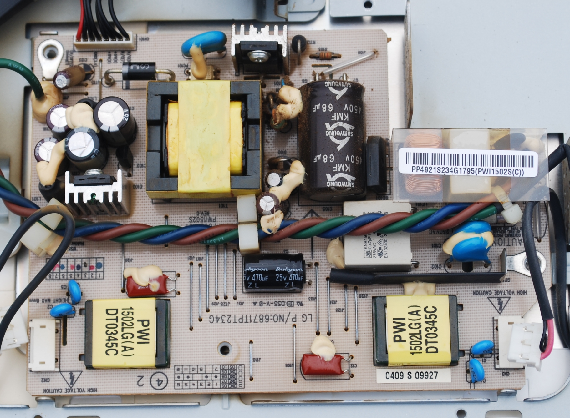

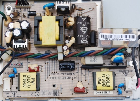

    Got one from Freecycle. Donor says the screen just went dark on day. I plug it in, and it does power up telling me to "Check Signal Cable". That status hasn't changed for the past 10 minutes leading up to this posting. I'm led to believe this monitor had been dormant for quite some time.
    I see seven capacitors, all with either the SamYoung or Rubycon brand. There's one I can't identify. I'm using ESR Micro 3.1 testing in circuit.

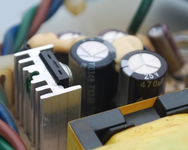

    The big SamYoung capacitor specified for 68 uF and 450V tests for 69 uF and 0.38 Ohms.
    There's a Rubyon ZL on its side specified for 470 uF and 25V. It tests at 1375 uF and 0.03 Ohms.
    The two SamYoung KMG capacitors specified for 330uF and 25V test at 1370 uF and 0.33 Ohms & 836 uF and 0.15 Ohms.
    There's a small SamYoung KMG capacitor specified for 22uF and 50V. It tested at 16uF and 5.4 Ohms. That bothers me.
    There's a SamYoung KMG specified for 470 uF and 25V and tests at 830uF and 0.00 Ohms.
    There's a T0348 ZL (Rubycon?) also specified for 470 uF and 25 V and tests at 1365 uF and 0.00 Ohms.
    I also test what I think is a fuse to the right of the small capacitor and northeast of the capacitor cluster. There *is* continuity.
    Anything else I should examine? I keep hearing debates on the reliability of SamYoung capacitors, too.
    Thanks for reading!

    1) If you hookup a working computer displaying your favourite, does the check signal disappear?
    2) Please post a picture of your logic board with resolution close to 2000x2000.

        Samsung used them a lot. All i can say is that they are not "bad" the same as the likes of Fuhjyyu, but they do fail.
        Are you confusing two similar brands? I know SamWah caps are used in a lot of Samsung products. They are generally good, but have some defective lots. Definitely second tier.
        Sam Young are 'replace on sight', pure garbage.

          I plugged it into a laptop, and was able to extend to desktop onto this monitor. I couldn't use it as the primary monitor, but I'm guessing that's me failing with the laptop.
          I misread the attachment requirements and was reading those for the JPE extension. I hope this one will work better.

              Essentially, it IS working now. I would really really really like to replicate the condition which caused it to fall into my hands in the first place.
              Guess I'll have to stress test it some more. Those 5 Ohms on the small cap still bother me.
                Then replace it. A normal ESR on a small cap like that is around 1 ohm, not 5.
                  A new Panasonic FC (lowish ESR) is 1.3 ohms. FM is 0.340 ohms.
                  http://search.digikey.com/scripts/Dk...name=P10318-ND
                  http://search.digikey.com/scripts/Dk...2uf%2050v%20fm
                  5 ohm could be correct depending on the original specs.
