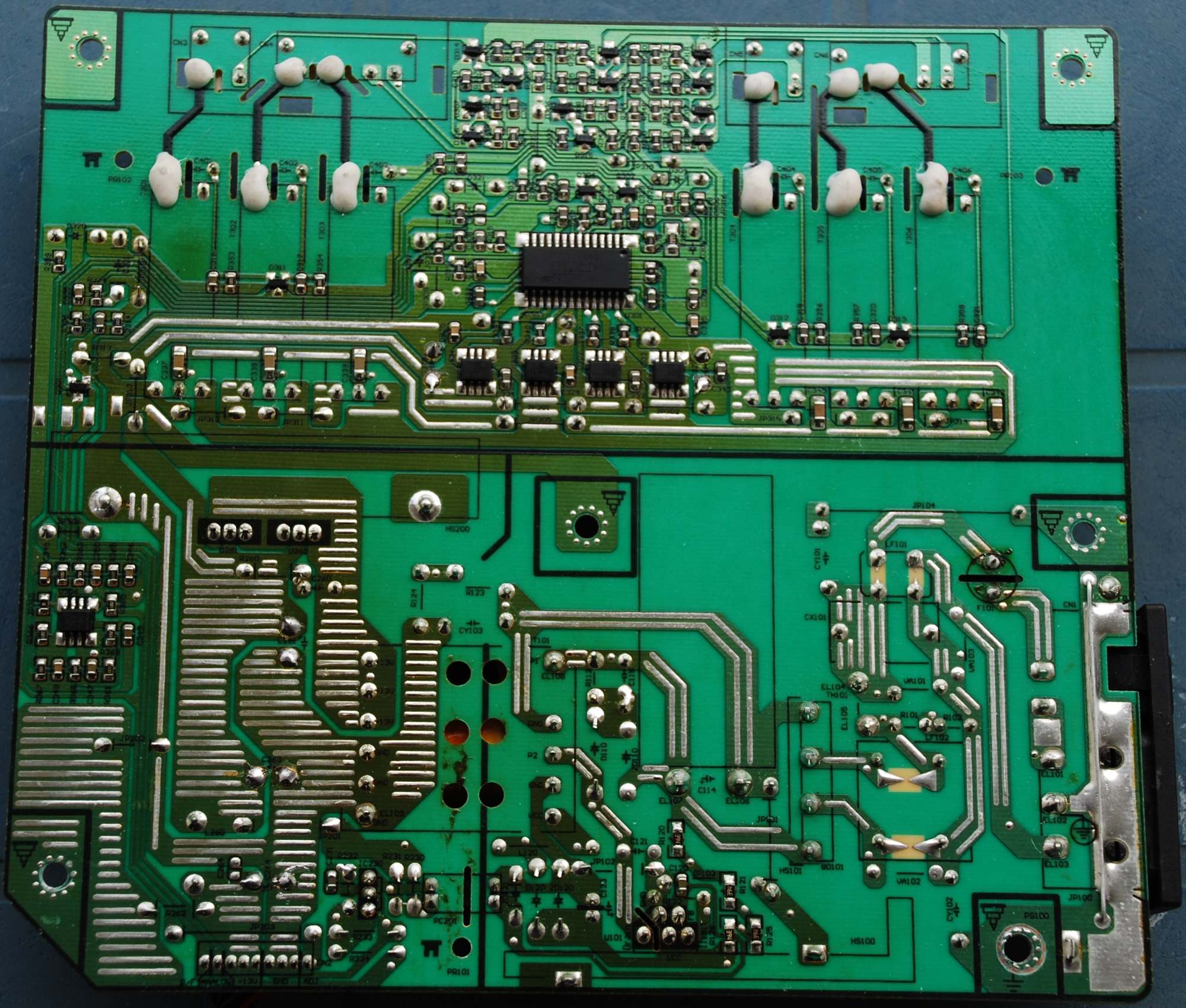

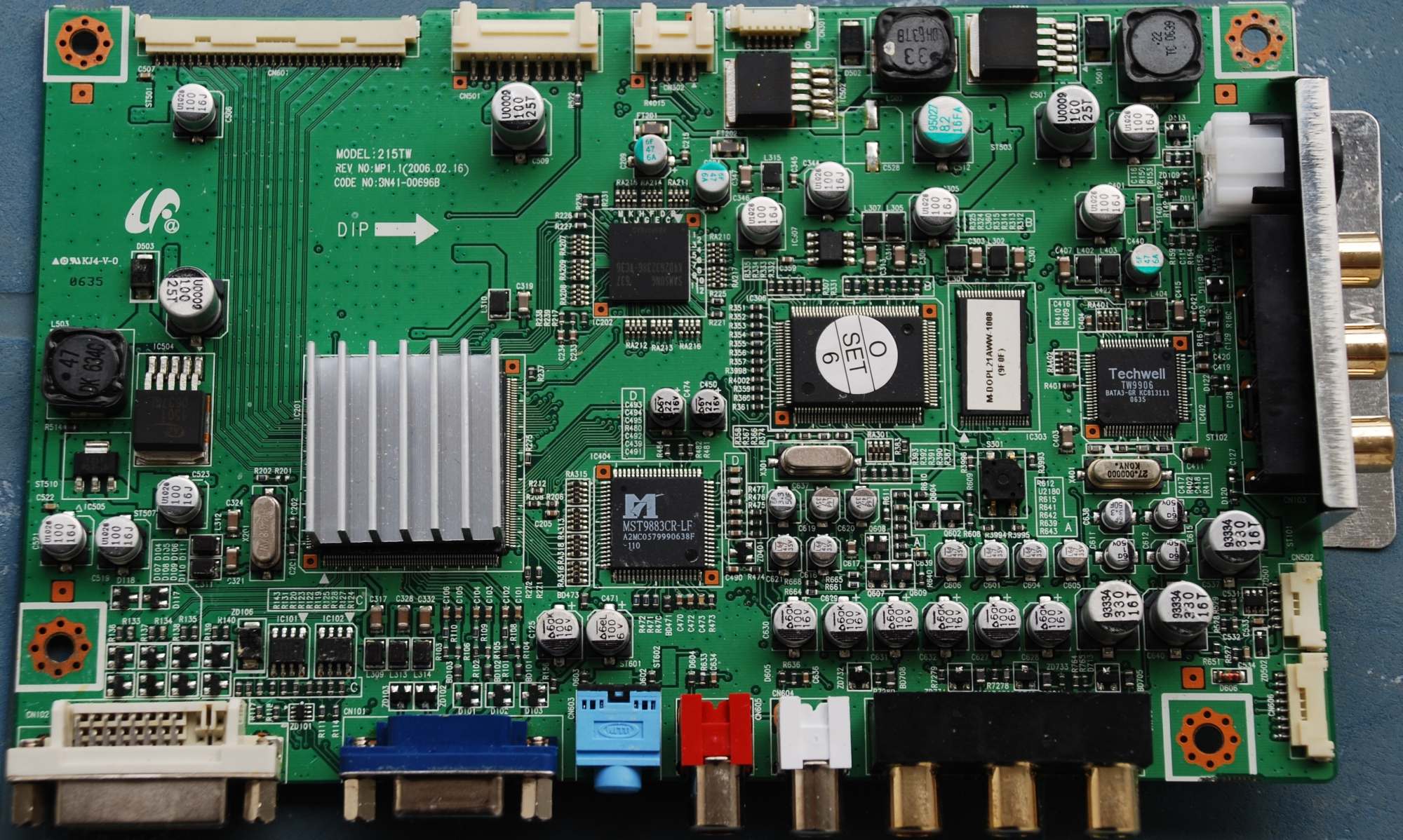

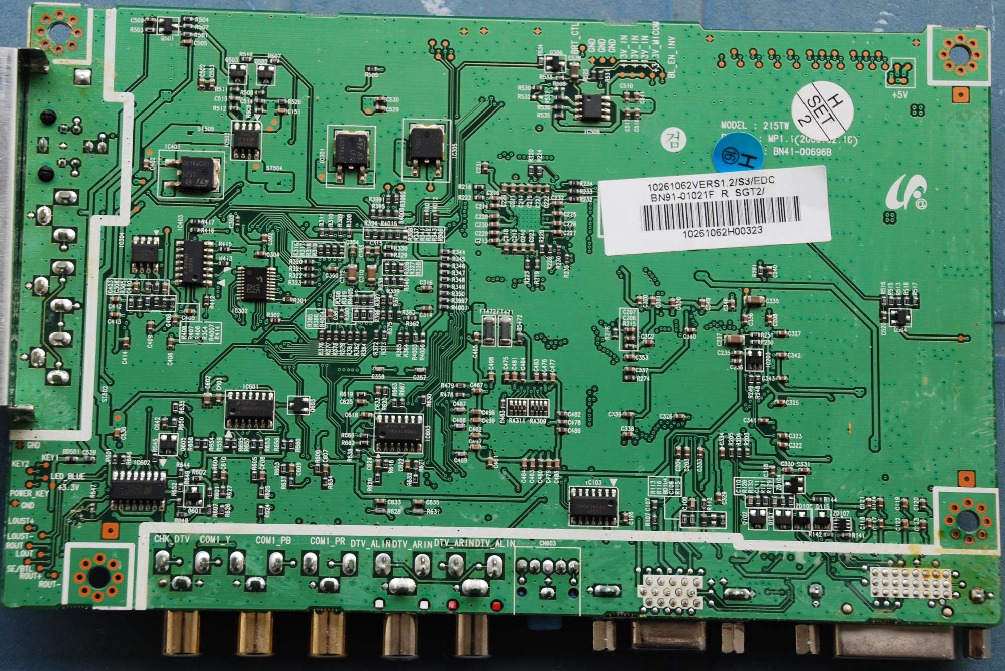

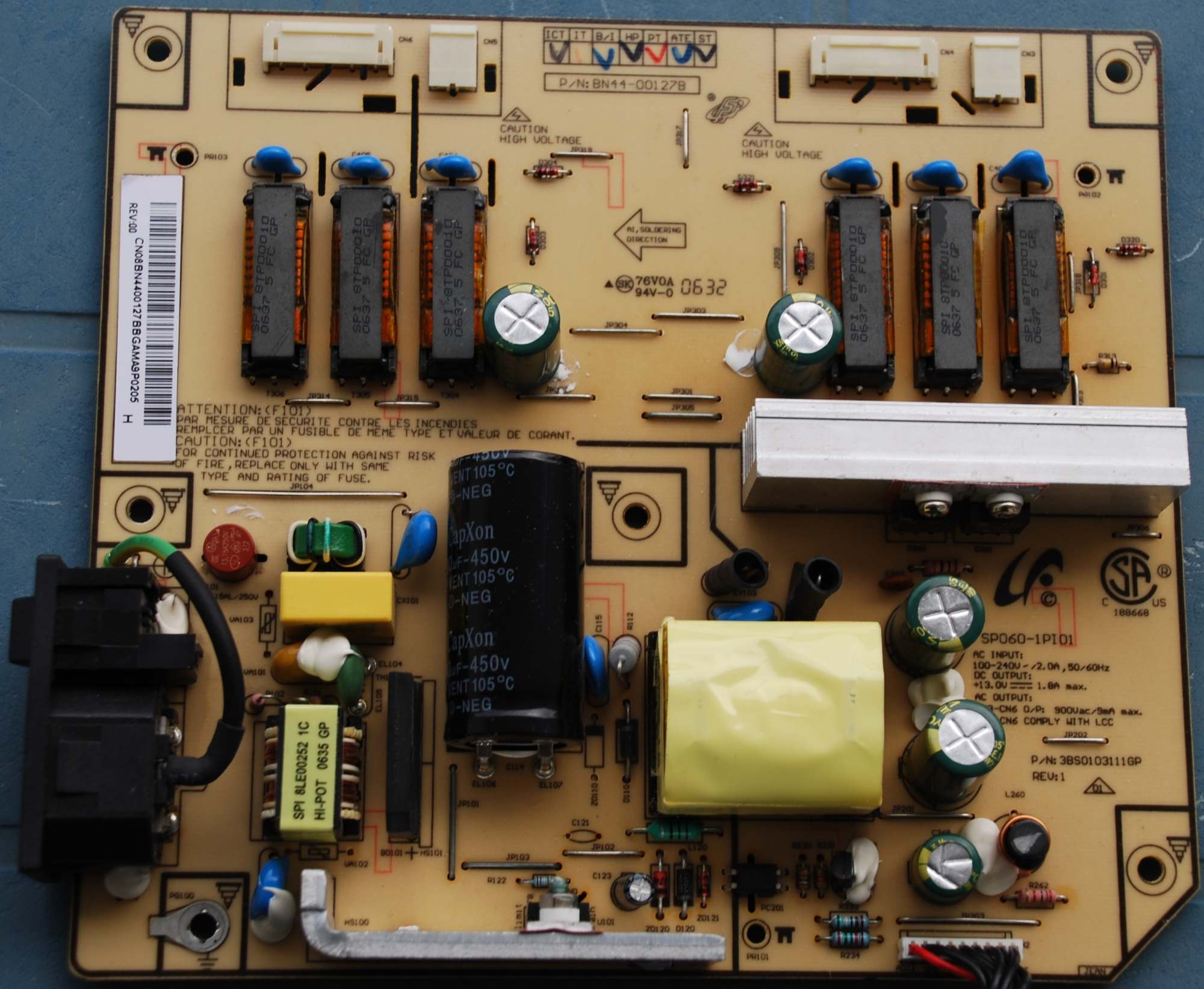

    Got this monitor from somone who had evidently tried to repair it. The caps on the powerboard were already replaced with Sanyo WX. The fuse was blown and i replaced it with a new one of same value as the old one. The monitor would then blink the back light on and off again.
    Same powerboard as this thread https://www.badcaps.net/forum/showthread.php?t=11012
    Searched for forum threads on the issue and found another thread where it was concluded it might be due to shorts at the CCFL tubes. Took the thing apart and sure enough, a big scorch mark at the upper CCFL assembly. I shortened the leads a tad and resoldered them. Put on some heatshrink to isolate the ends.
    Now the backlight works however still no picture, doesnt say samsung or anything else on it. If i have the monitor hooked to a computer it will show the EDID info on the computer. While hooked up the backlight will turn on and then after a few seconds turn off again as if it goes to powersave mode or similar. If its not hooked up the backlight will stay on for much longer.
    Im starting to think its a logic board issue of some kind, or could it be the caps on the powerboard are too good/bad (ESR/Ripple wise) compared to originals?
    I will add some pics later if noone can come up with anything else i could check. Just need to charge batteries of camera, only have semi bad pics atm.

      I would check the transformers had this issue on a 215t
      turned out to be top one of the six

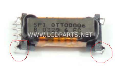

        Picture of secondaries for reference
        http://lcdparts.net/TransformerDetai...ProductID=3355

          Re: Samsung 215tw still dead
          So you think it might be the transformers? But if it was wouldn't it turn of the backlight when no computer connected as well as when connected?
          And what would be a good way to check them?

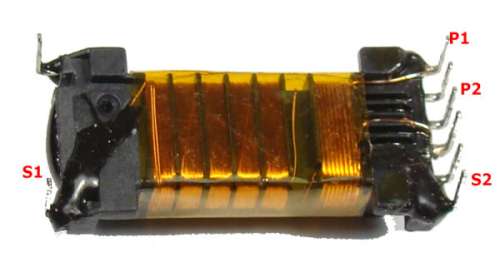

            Mine would stay on for a while then flicker and shut off
            Do a resistance test between pins S1 and S2 should be approx 950 ohm
            See pics
                See pics

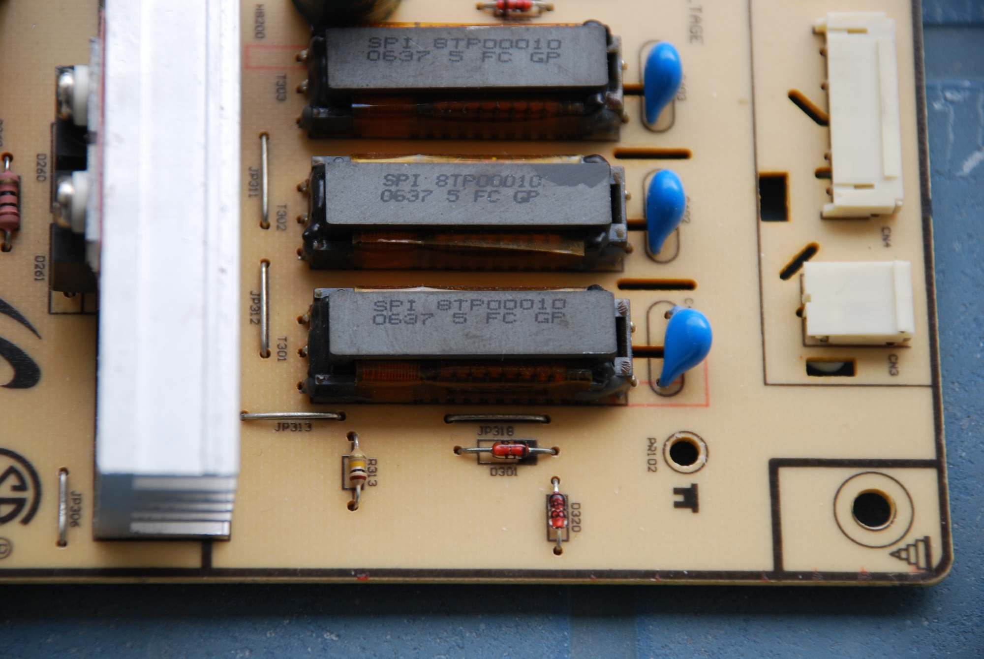

                That is not the same ones i have on my board. Mine have only 5 pins total.
                Ill attach more pictures below, hope that helps any.

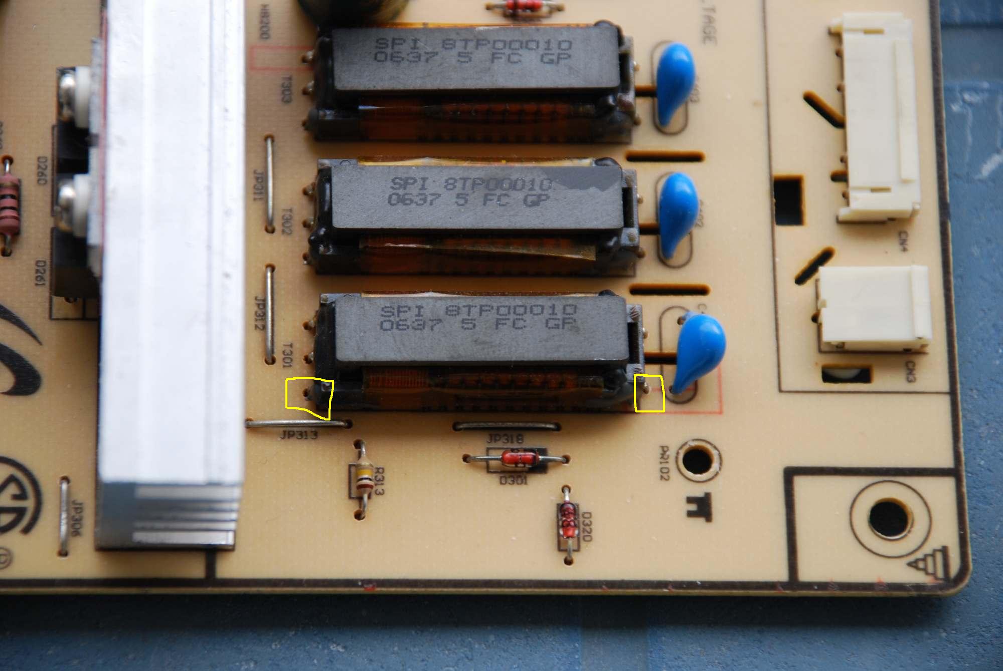

                    Good focused pictures are ALWAYS a help. In the photo, measure resistance across the points outlined in yellow. You may be able to do your measurements on top of the board, otherwise you'll have to scrape off the white adhesive. Also, measure the other 3 transformers on the other side the same way.
                    Since you say there was a scorch mark in the upper CCFL assembly, I'm assuming the wiring was shorting out? If the transformer powering that assembly checks good, then check all components connected to that transformer for shorts.
                    If you have a spare ccfl, then try substituting it for the one that was shorting out.
                      I *think* the secondaries on this inverter transformer are the two feeding into the blue caps.
                          Hmmm... looking a little more closely, it looks like one of the test points (the one without adhesive over it) MAY NOT be connected to anything. Try putting one test probe on the point with adhesive and test the other pins of the transformer with the other probe. Pin 1 (lower left) of the transformer appears connected to ground.
                            Looks like there is a scorch mark under one of the transformers
                              As i remember on mine and on the neovo i did (used these transformers)
                              The 2 yellow areas were the secondaries (Think)
                                Measured all of them, yellow marked in your pic. Gives no connection on any of them. My dmm only goes to 20M but im guessing its not supposed to be higher then that?
                                Dont have any extra tubes to try with, but at least the short should be fixed since my fix made the failsafe stop turning the backlight of at least?

                                  Supposed to be ~1k. Either your transformers have failed open (but that's a no since your backlights work) or they have a different pinout.
                                    On those pins i measure about 900-910 ohms on all but the one where the suspected scorch is, that one measures 855ohms.
                                      Turned out the same on mine
                                      Either bad wiring on the CCFL have caused transformer to start to fail or
                                      vice versa .
                                      Without a spare tube the only option i can suggest is a new trans or a good second hand one
                                        PlainBill suggests that these inverter transformers should be within 3% of each other. Details at
                                        https://www.badcaps.net/forum/showpo...7&postcount=18
                                        So 900 x 0.97 = 873 ohms.
                                        This suggests the inverter transformer is out of spec and bad.
