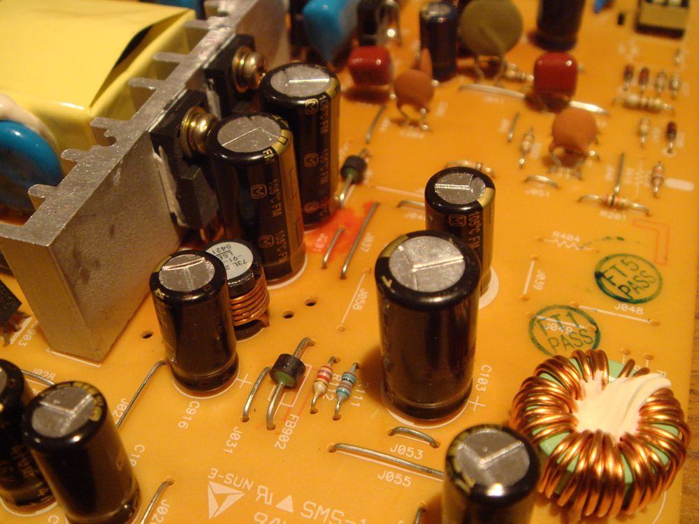

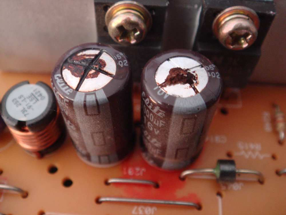

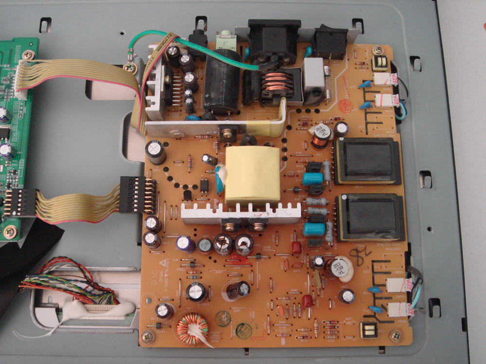

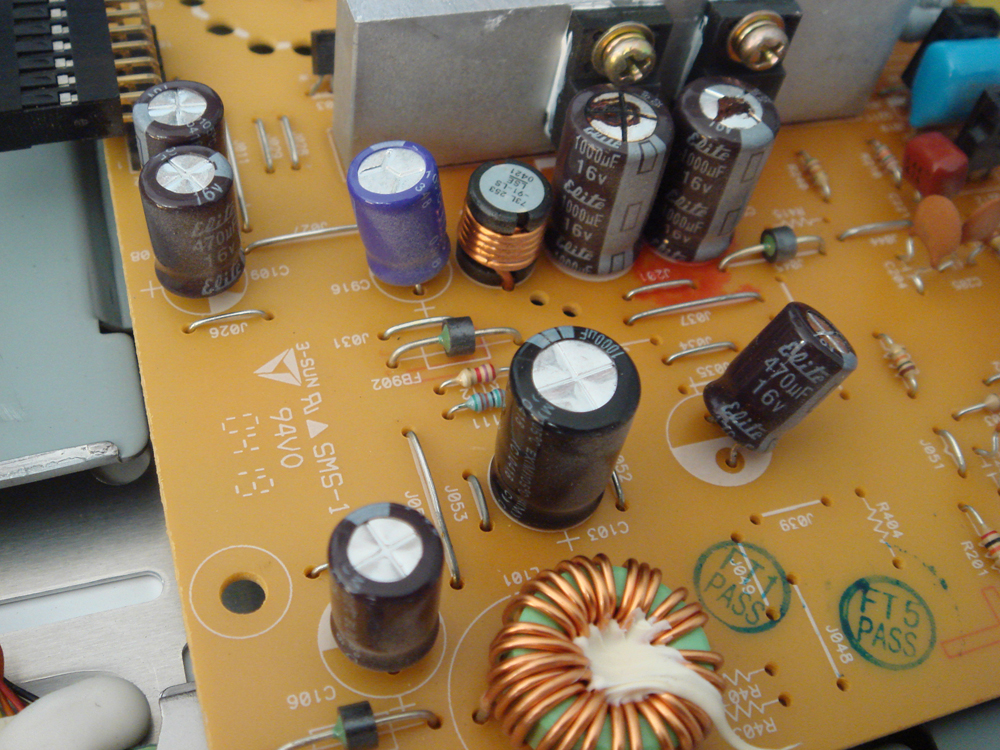

    Iiyama monitor developed the on/off clicking which other members on here have reported.
    After the screen sitting in a cupboard for a year (placed there before I learnt about badcaps) I took it apart today and below shows the findings:
    Iiyama Caps
    Obviously there is the pair with the split tops. Can anybody confirm if the larger laid down is split around one of its legs?
    I started my search for new caps on RS - I'm in the UK - but putting in the attributes of 16V and 1000uF gives 35 caps. What specification do I need to look for, or will any of these work? What is a reliable brand?
    Also is there anything else I should be looking out for now the screen is open?
    Thanks!

    Re: Iiyama ProLite481S - Bad Caps Found - Advice Please
    Please attach the pictures using 'Manage Attachments' (below the text entry area). That way they will be hosted here, and will always be available.
    In general you are looking for
    name brand (Panasonic, Nichicon, United Chemicon)
    low ESR (Panasonic FM, FR, or FC series; or equivalent from the other manufacturers) with
    dimensions that match the available space. Specifically, the Panasonic EEU-FM1C102 would be ideal. It is STRONGLY recommended that you replace ALL electrolytic caps with the possible exception of the large (typically 100uF, 450 volt) one that rarely fails. Do replace it if there is any sign it may be bad.
    Your countrymen may chime in to correct me, but RS and Farnell may be your best choice of suppliers.

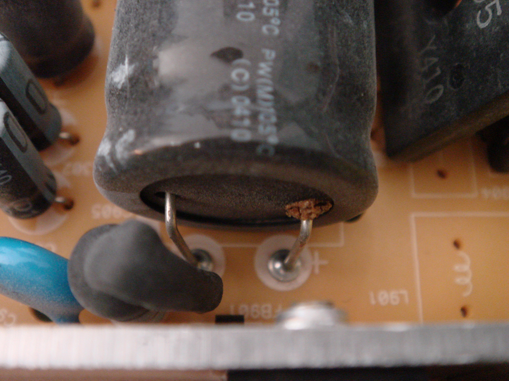

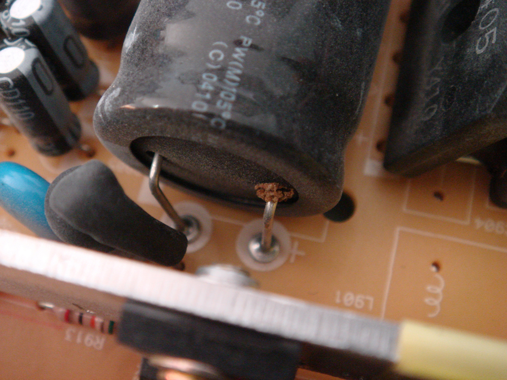

        Looking at the leg on the largest cap it is leaking so will need changing also
        RS and Farnell are good suppliers but not sure if they have minimum orders so not sure what their P+P costs are .
        Make a list of the caps you need remembering to note height and diameter and check their sites or you can scan ebay there are some good sellers

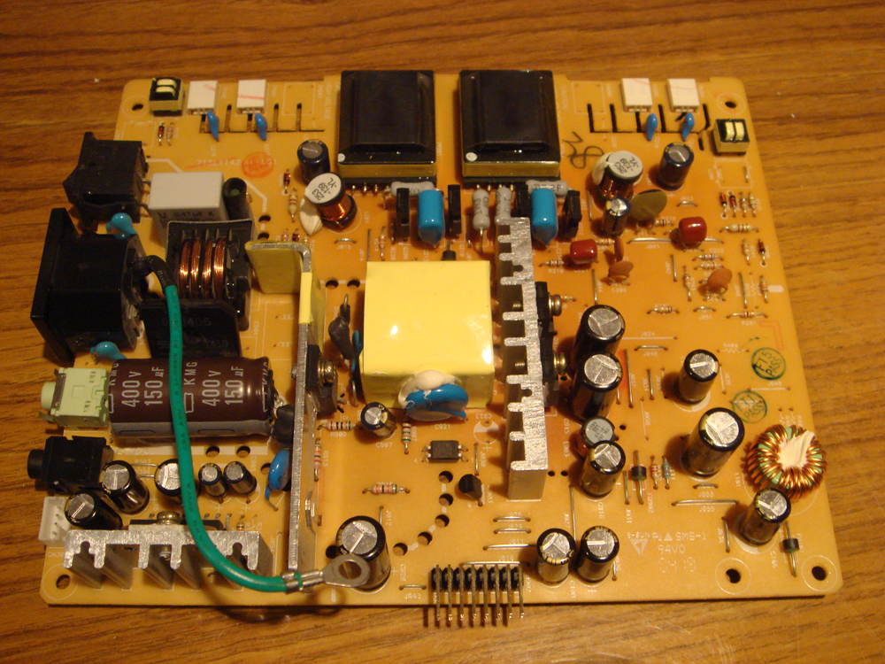

          Many thanks for the detailed response PlainBill.
          After searching through RS I have come up with:
          To replace:
          1000uF 16V - as blown:
          RS Panasonic 1000uF 16V
          40uF 16V:
          RS Panasonic 470uF 16V option
          OR:
          And the big one 150uF 400V I am not sure about, these are the possible 13 options:
          RS 150uF 400V
          Can somebody advise if these are correct and what I should choose.

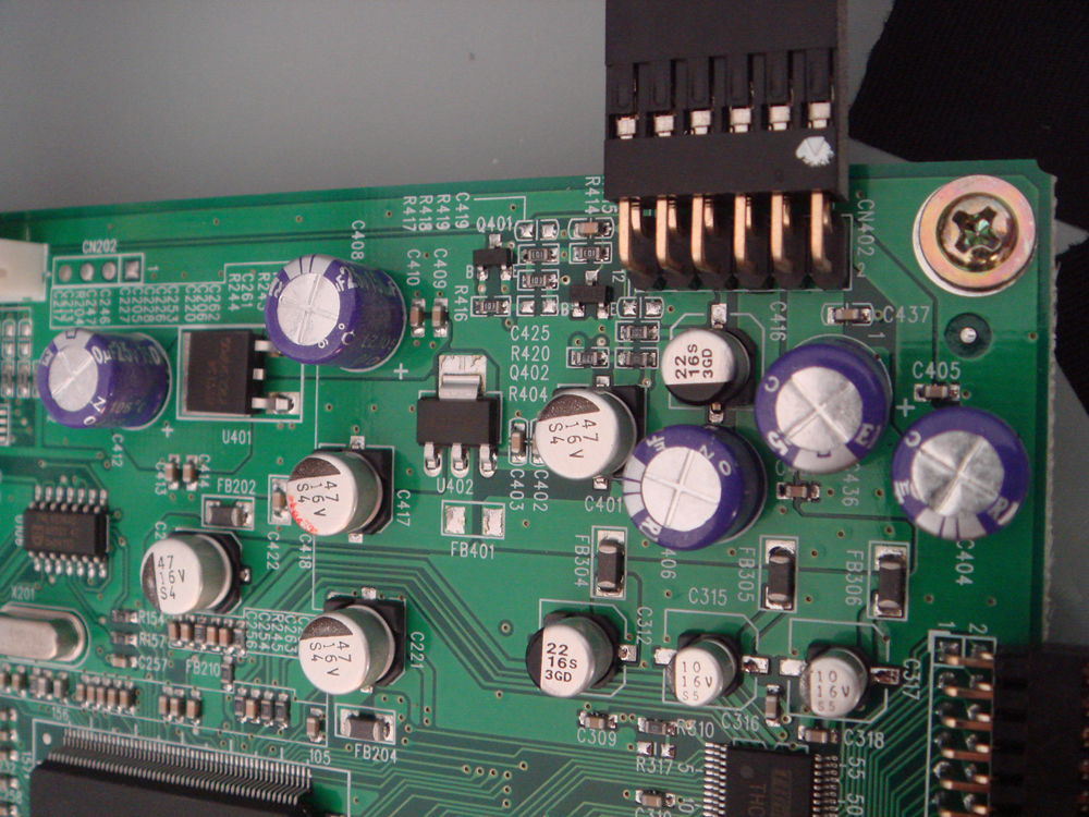

          I am choosing to replace these 13 out of the 19 on the board due to the convenience of values. I don't want to have to purchase 5 when I only need 1 and they're alright for the time being...
          Unless you can convince me otherwise?
          Thanks!
              A few yes
              Judging by the state of the caps i would change them all on the psu board
              best do them all now that way if you still have a problem after they are fitted
              they can be ruled out and other tests suggested

                  All of the caps are suitable, except for those rated 150uF, 400V @ 85°C. There are plenty in the group rated for 105°C, choose the one that fits.
                  There are a couple of small caps in the power supply that can fail without physical signs. They are typically rated 22 - 100uF. If they fail, the power supply won't work.

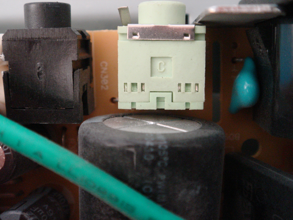

                        After searching through all on RS and Farnell I cant find a single one with long legs - required to enable the capacitor to lay down. They are mostly snap in and if not only have legs of around 6mm and I need at least 15mm.
                        Any advice where else I could look or is it a case of lengthening the legs with a short piece of wire??
                        External dimemsions are Dia:20mm Height:35mm
                        Following your folks advice I am going to try and replace them all.

                            The easiest is to cut the leads of the old cap as close to the body of the cap as practical, the wrap and solder them to the leads of the new cap.

                              I have a similar monitor which I have fixed. Mine did not have the problem with the big 150uF 400V cap. I had to replace the two 1000uF 16V. I simply went down to the local Maplin and asked for two 1000uF 25V 105C, the stock code is DT70M costing 44p each. The caps from Maplin are Jamicon which I find are quite reliable.
                                Ive now sourced a replacement for the large capacitor from a very helpful user on here so that little problem is solved.
                                Could somebody please be kind enough to check through my shopping list below before I place the order to make sure they are all suitable. I have checked all of the dimensions so that isn't a worry.
                                1000uF 16V
                                470uF 16V
                                22uF 25V
                                1uF 50V
                                220uF 16V
                                33uF 50V
                                If there is any problem with any of them/recommendations for improvement I am happy to search for others.
                                Thanks!
                                • PlainBill
                                  • Feb 2009
                                  • 7034
                                  Thanks!
                                  1000uF 16V Good!
                                  470uF 16V Good!
                                  22uF 25V I would suggest http://uk.farnell.com/panasonic/eeuf...3v/dp/9692495; the one you selected is not low ESR.
                                  1uF 50V Good!
                                  220uF 16V Good!
                                  33uF 50V Good!
                                  PlainBill
                                  • Pull9Gs
                                    • May 2011
                                    • 9
                                    Call me stupid but does it not matter that the voltage value is higher?
                                    Or rather is this the maximum voltage that the capacitor can handle? Before it burns out perhaps?
                                    Huge thanks to PlainBill for checking through all of those!
                                        So... Good News, it's fixed!
                                        Ordered the above shopping list with PlainBill's recommendation and swapped all the caps out yesterday morning - see attached photos.
                                        Had the display on for the rest of the day ~10hours and worked faultlessly.
                                        Thanks to all the help on here a complete noob has been able to beat the capacitor plague!
                                        Cheers guys!
