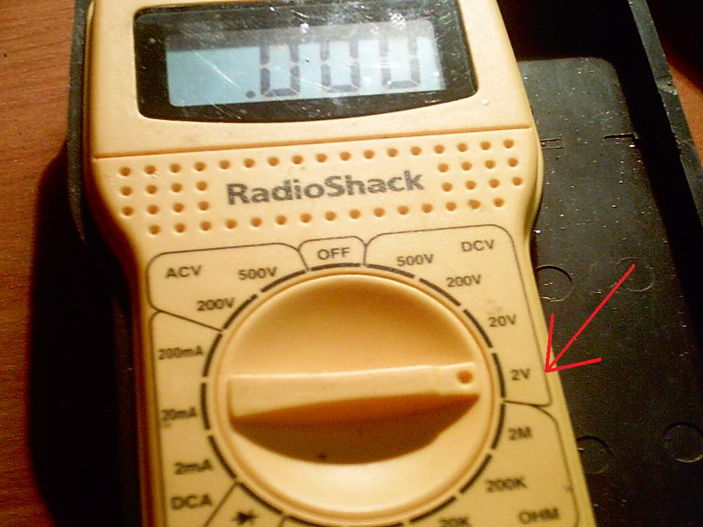

    With the ohm meter on 2k the voltage goes up to ~1.09 then falls to .000 within 2 seconds.
    If you are measuring voltage with your multimeter set on 2k ohms, you are
    1) measuring it wrong
    2) not getting an accurate reading
    3) may potentially damage your multimeter
    You would need a very special multimeter in order to be able to measure 2k volts if your multimeter goes that high. Most multimeters only go to 1000V DC.

      When I said 2k I was refering to the setting on the multimeter. This is the multimeter I have. On the OHM section i set the dial to 2k. You cant see it in the pic but the settings are 200, 2k, 20k 200k, 2m
      Not my pic by the way but its the same model mulri meter i have.
        #43
        Re: HP lp3065 repair or part source.
        You can't measure voltage with your multimeter when it is set to any ohm setting. Maybe you might a typo in post #40?

          well i guess it was ohms that i was measureing then. never used that setting before.
