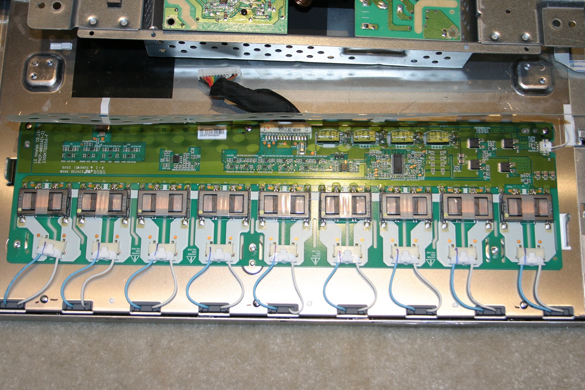

    I have a lp3065c hp p/n EZ320A which is not turning on. I have already replaced the power supply so I know its not that. I do not get any lights when its plugged in or if I hit the power button. One interesting thing though if I leave a usb thumb drive in the hub then plug it the power i get the drive access light for half a second on the thumb drive.
    At this point I am thinking it is the lcd logic board. I have tried in vain to get an official part number from hp but it is not available on part surfer or from their tech support. I did search ebay and google for every number that was on the logic board but no luck. I was only able to find the part on this site http://www.shopjimmy.com/tvs/5057767-7330-vga-input.htm but they are out of stock. Again searching for that part number yields no results.
    Does anyone know how to locate the official hp part number for this part or to repair it.

    Please post some clear focused photos of the power and logic board using the "manage attachments" button. Difficult to suggest tests if we can't see what you're seeing.

          Also, please a photo of the inverter board.

            Pictures as requested.

                Also, a lot of the larger screens seem to have probems with the inverter. Since the power supply has been replaced, try checking the fuse on the inverter. It's below the power connector and marked 10A/125V. If it's bad, try checking the 4 mosfets in the upper right of the inverter marked QXX (can't read it off the photo) for shorts. They are the 3-legged devices with the middle leg cut off.

                  The mosfets tested good. The 24v pins were reading at ~1.3v all others were 0. on the output on the left hand side the 5vsb was reading at ~5v and the 24v was ~1.3. I think the issue is in the logic board.
