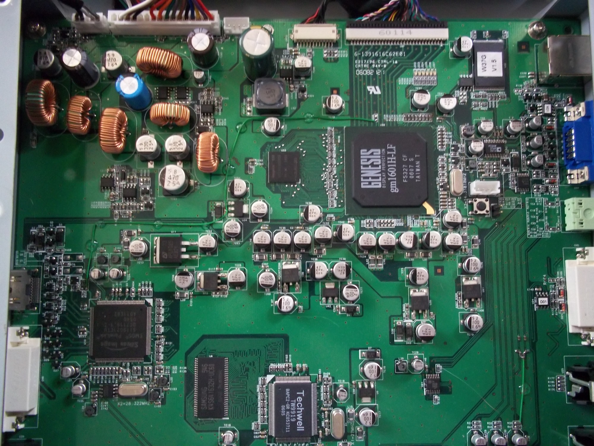

    This is the original thread but it full of stuff about the PSU. Eventually I went ahead and bought a new PSU, installed it and the logo light is on but pushing the power button results in nothing.
    There are few lytic caps on the board:
    1 Sanyo 1500uF WX 25v
    4 TAICON 330uF 0607 35V
    1 TAICON 470uF 35V
    The rest are polymers.
    I don't think it's the PSU. Something is not working on the input board, could it be bad caps or something else dead?
    Any ideas? I do get a 5V from PSU but no other voltages, unable to tell if inverter or lamps are bad, because I can't turn on the set.
    This is the only pic right now waiting for the PSU to slowly discharge, before I can remove the input board safely.

    Re: Westinghouse LVM37w3 input board.
    Try checking the fuse below connector CN10. It marked with a "T" and silkscreened 5A/24.

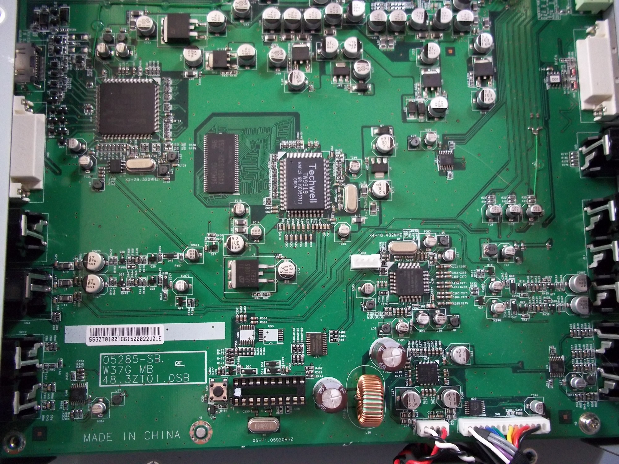

      I see it, tested with DMM showed 01.0 on the 200 setting.
      edit: added more clear shots of the board except it's in two parts.

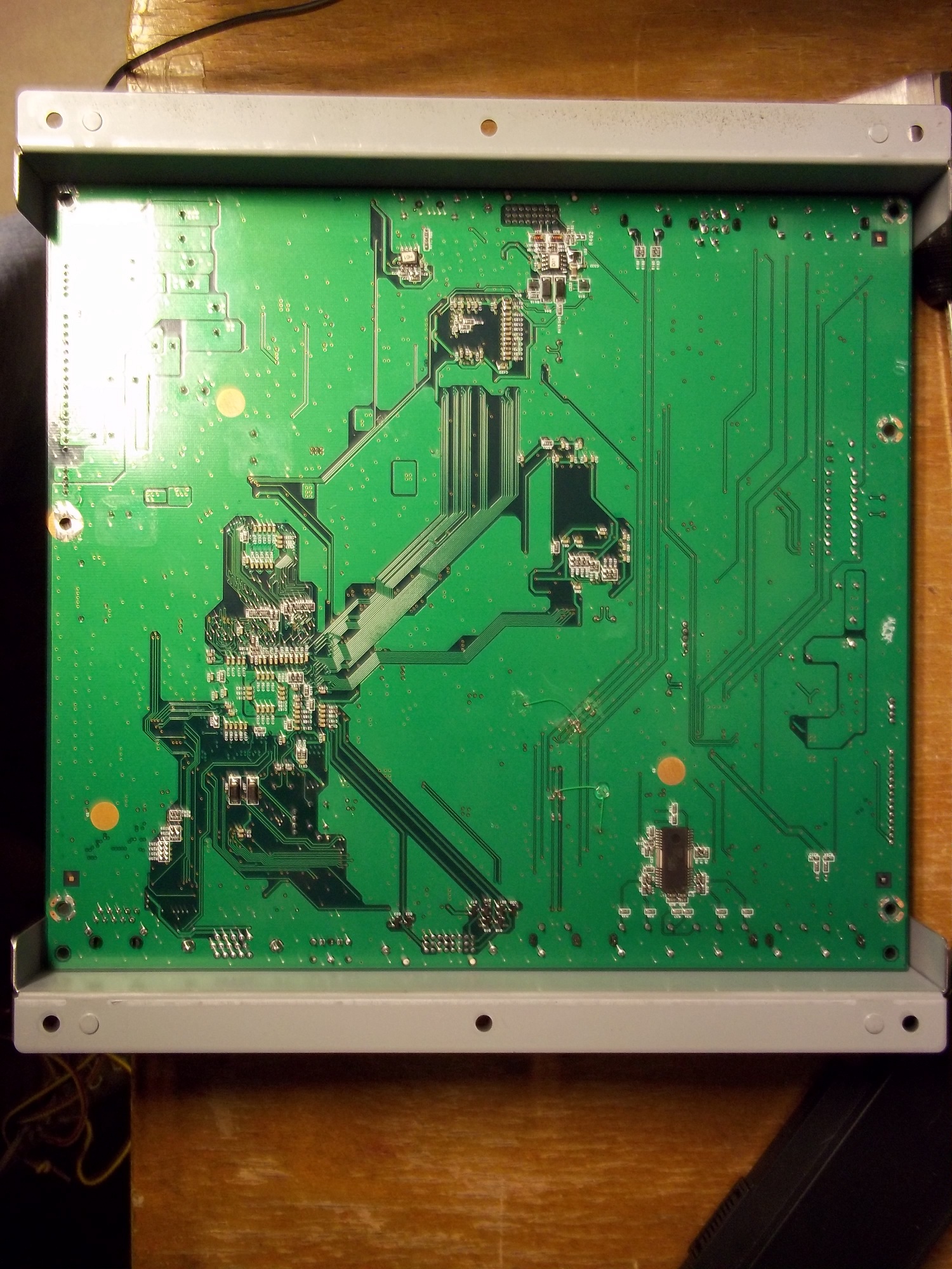

        Took a pic of the back side I had a hard time trying to get a clear shot.
        Anyways I think I'm going to recap the taicons and see what happens, I'm shooting in the dark, maybe I'll get lucky.

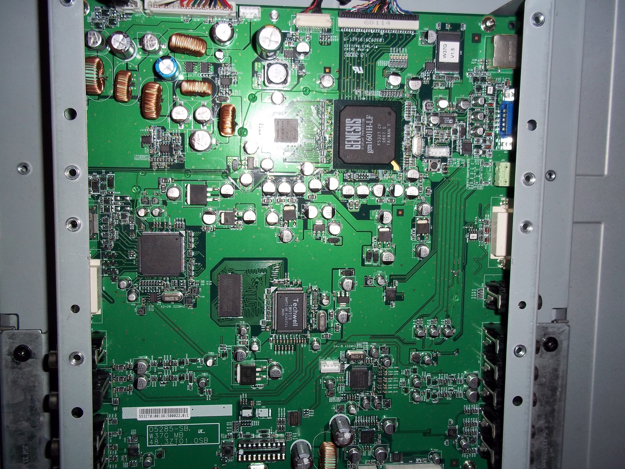

                  Replaced caps, still it won't turn on, I tested the voltage I get 1v, 3.3v and 5v where the supply plugs into the logic board, at the other end where the switch/button board plugs into I only get 1v, and 3.3v there's three wires that have no current at all. I assume I need a 5v current for the switch?

                      Sorry I was running tad late for work so I just wrote what I thought.
                      Jokes aside, what I meant was, I didn't see any voltage, and was wondering if there should be 5v rail for the button/switch board.
