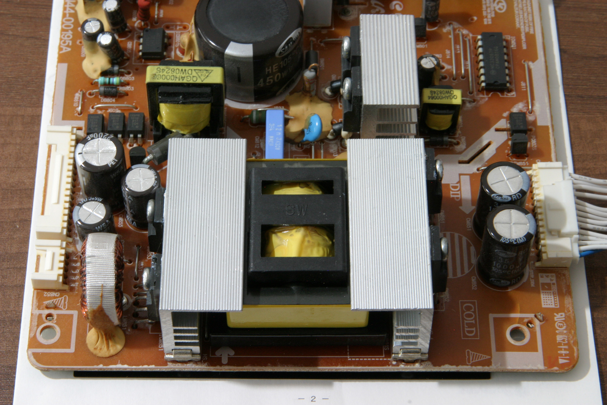

    I would like some help reviving Samsung 245b Plus.
    Model: 245BPLUS
    Model Code: LS24HUBCBL/EDC
    Type No: HU24BS
    The Symptoms:
    Monitor appears to be on(Blue Light on solid)
    No signal to screen, no menu
    Worked for a few days by turning it off for 30 seconds then on again but it eventually gave up
    So far following your guide I have taken apart the monitor and removed the power board. Examined the board and documented the capacitors i see there. Please point out if I've missed any.
    The Images
    Sorry for the external link but my pics were too big and I dont have photo shop installed on my laptop to downsize the pics.

    To my untrained eye I don't see any sign of damage on the capacitors.

  • retiredcaps
    • Apr 2010
    • 9271
    Re: Samsung 245b Plus
    The max resolution is 2000x2000 and I believe 2MB for jpgs.
    https://www.badcaps.net/forum/showpo...13&postcount=3
    If yes how would i go about discharging it?
    Most big caps in the LCDs monitors discharge via bleeder resistor in about 60 seconds or so. See the following if you want to learn more about discharging ...
    http://www.repairfaq.org/sam/captest.htm#ctsdc
    I have compared the caps i need to the kit here and they do not match. Why do the kit contents not list voltage of the cap?
    Manufacturers can and have changed board revisions or put in completely different boards while keeping the same lcd model number.

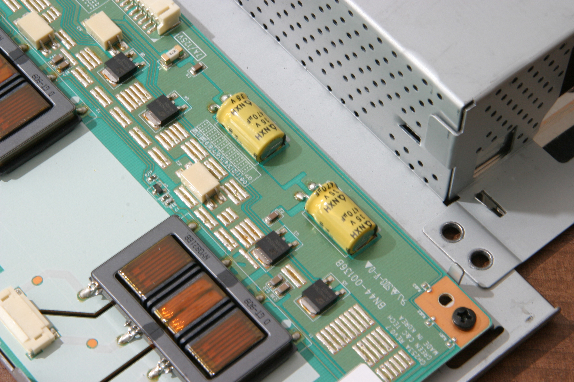

                              Since you're getting a power light, it sounds like the logic board is getting 5V. The black screen indicates the backlight is not coming on. Do you get a flash of light at all when you first turn on the monitor? Or is the screen always completely black?
                              Depending on how you answer, it could be bad caps, a blown fuse feeding the inverter, bad transformer on the inverter, bad ccfl, bad ccfl wiring, or a problem with the sense circuit that shuts down the inverter. Also, the power supply may not be outputting the correct voltage to the inverter.
                              Hope that you now understand why we ask for photos. When you do supply the photos, please post them using the "manage attachments" button and also include a photo of the inverter and logic boards.

                                After it went all black during use, it has been completely black afterwards. Switching power led on/off and power switch under panel doesn't bring any light on the screen. Here's some pictures of the components.
                                Edit: Both fuses are fine. I'll be back tomorrow to continue.

                                • Toasty
                                  • Jul 2007
                                  • 4171
                                  With the PSU back in the frame and connected - except for the plug from the PSU to the Inverter.
                                  Try powering on and see if you have 24v on the pins of the PSU as indicated by the table on the Inverter board.
                                  5 @ 24v(+) and 5 @ Ground(-).
                                  Check the 4 inverter MOSFETs for shorts. Check the inverter fuse for continuity.

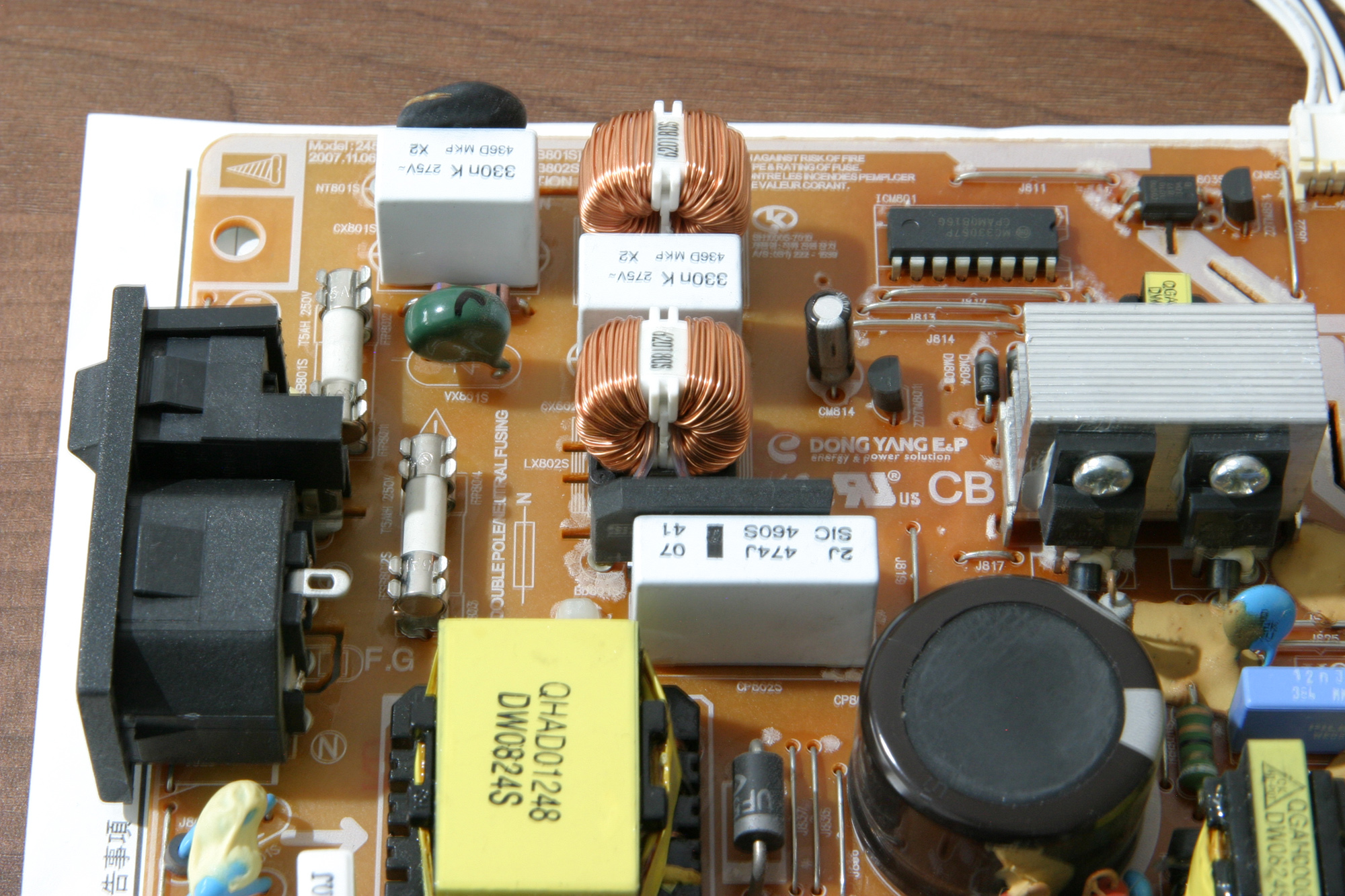

                                  Some clear pictures of the underside of the PSU too, please.

                                  • tgu
                                    • Jan 2012
                                    • 8
                                    Got my tools back to home, and bought some rubber gloves just in case :P
                                    Here's some pictures from underside.
                                    I'll update results later tonight.

                                      On PSU 5x24V and 5xgnd give 24.4V each, they seem to work. Inverter fuse on board gives a continuity beep. Searching instructions for testing them MOSFETs.
                                      "There'll be war, there'll be peace. But everything one day will cease. All the iron turned to rust. All the proud men turned to dust.."
                                      • Toasty
                                        • Jul 2007
                                        • 4171
                                        Diode check with DMM or low ohms scale with analog. Check for shorts between legs and tab in all polarities.
                                        Hook the PSU to inverter cable back up and monitor the 24v on the inverter board as you cycle the power button. If 24v jumps up briefly then dies, the problem is in the inverter.
