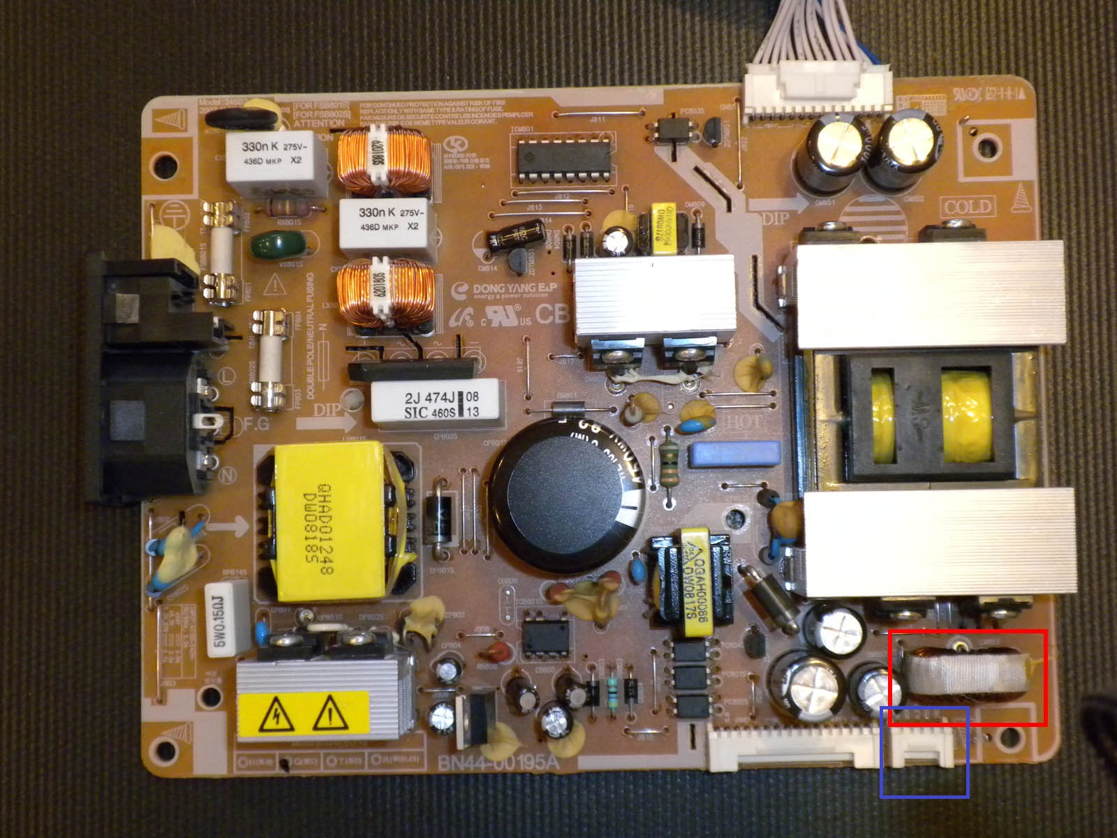

                Another observation I made was that on the replacement power board I received, the smaller connector between the power board and the logic board was bent (but does not seem broken) - I attached a picture and boxed it in blue.
                This connector has the BL_EN and SOS pins, and I believe a DWM or DIM pin (I can check again when I get home). If this connector is actually damaged/broken on the power board, would that explain the constant white screen on my monitor?
                If so, I'll probably try removing the 5 pin transistor on this new power board and put it on my old power board.
                If not, I may try to RMA this logic board instead.
                  Re: Getting started with troubleshooting [Samsung 245BW]
                  If those pins were broken in any way the problem would have been no backlight, not backlight and white screen. This is definitely a LCD, cable or logic board issue.
