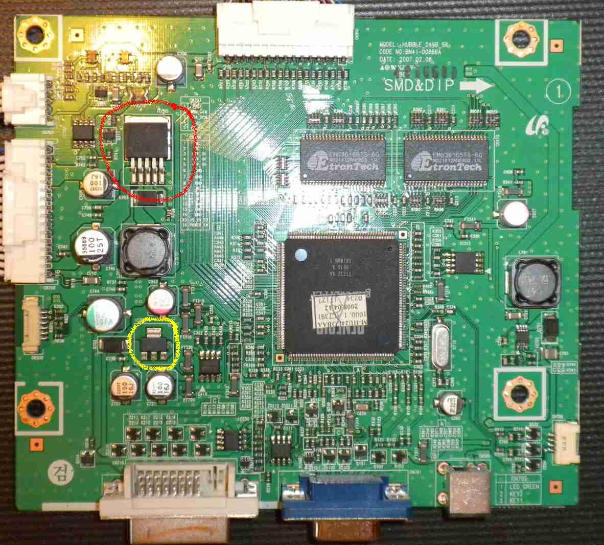

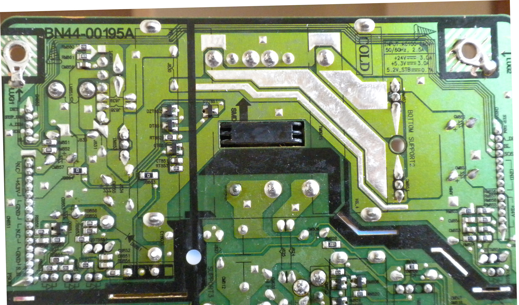

        If 5.0V standby is now steady, let's make sure it is reaching the logic board. The logic board tells the power supply to start.
        See picture (one person in another thread questions why pictures are needed and implies that I'm an idiot for even asking).
        List the part number and DC voltages each pin, of the red and yellow circled component (the two components that are designated IC on the PCB - one is IC703).
        Measure each pin (except the big tab) with respect to ground. Use a ground screw on the logic board for ground.

          The red circle is IC705, and the part number is AnaChip 1501-33. Here is the data sheet:
          http://www.alldatasheet.com/datashee...IP/AP1501.html
          The measurements for the 1501-33 are:
          Pin 1: 5.18V
          Pin 2: 3.30V
          Pin 3: 0V
          Pin 4: 3.23V
          Pin 5: 0V
          From what I can understand from the datasheet, it seems that Pins 1 through 4 have the correct values, but I'm not sure about Pin 5?

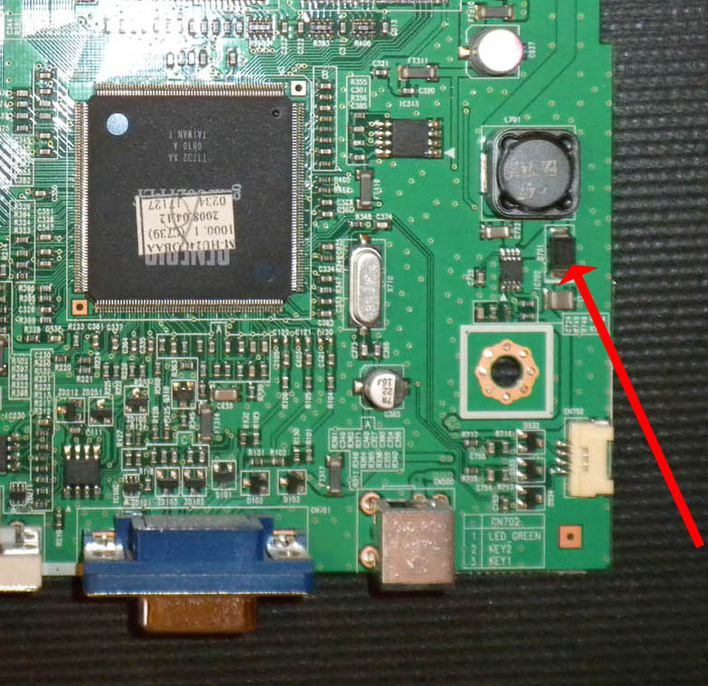

          The part number on IC703 is "J412 953-18". I wasn't able to find a datasheet for this one. The measurements are:
          Pin 1: 2.93V (3.18V if I turn the monitor off)
          Pin 2: 0V
          Pin 3: 1.78V (regardless of on or off)
          The pins were counted from left to right using RetiredCaps' picture.

            Ok, now this is weird. I searched other threads for "953-18" to see if anyone else had measurements I could compare against (which I did find, and I guess my readings are normal). I then checked the voltage across the main capacitor, that previously measured 160V. It now reads 384V!

              The suffix in part numbers like the one above indicate the output voltage. So -33 denotes 3.3V DC. So pin 2, it spot on at 3.30V DC.
              Pin 2: 0V
              -18 indicates 1.80V DC should be the output. Most of these parts should be with 1% of the output rating. That is 1.80 x 0.99 = 1.782. Let's say this voltage regulator is working properly because most multimeters are +/- 0.5% accuracy on DC V.

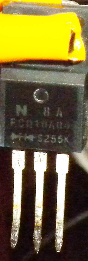

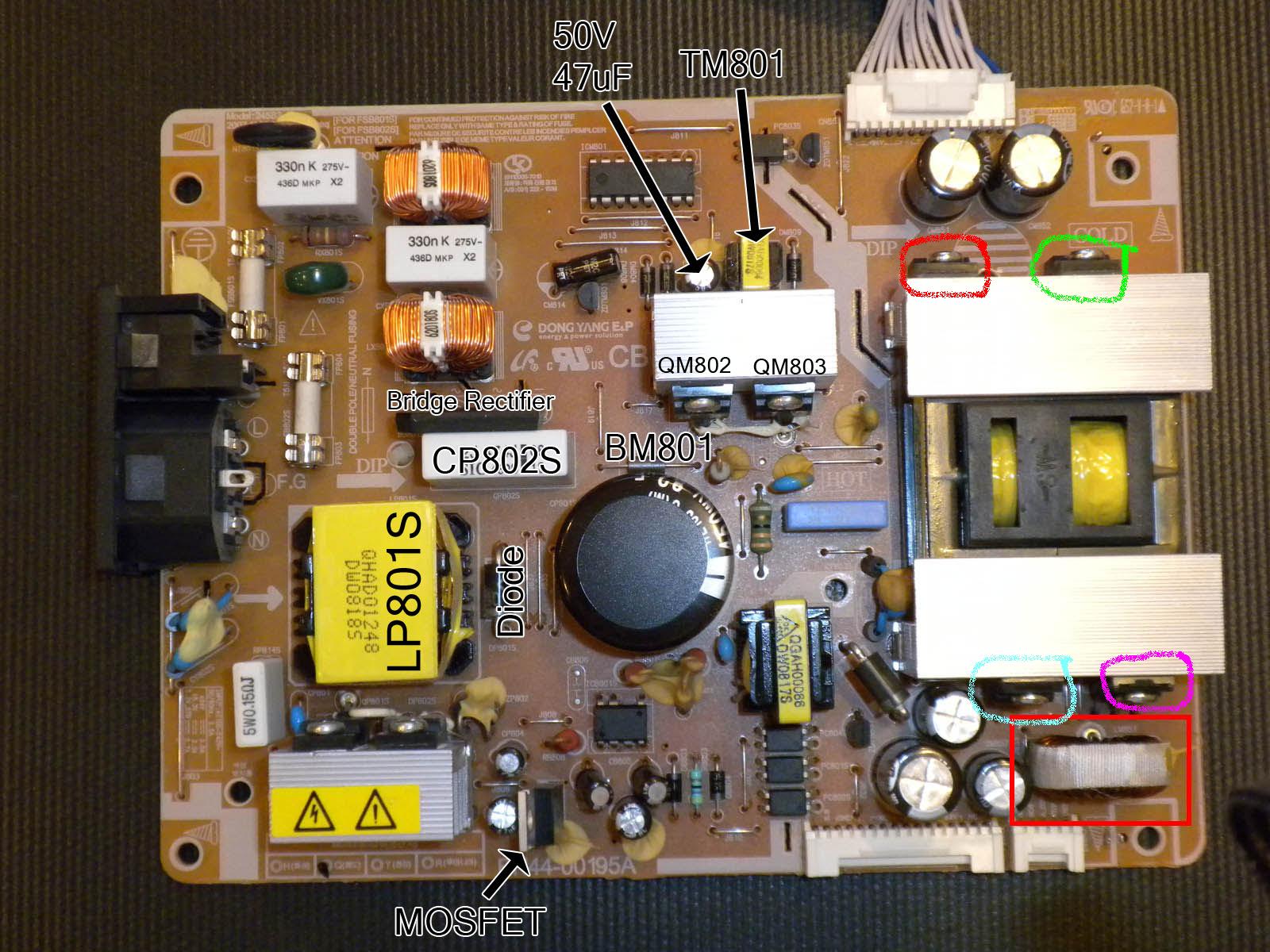

                  1) What are the part numbers for each of the 4 colored transistors?
                  2) Test each of the above for shorts.
                  3) If there are no shorts, measure each pin for DC voltage with respect to ground. Use a ground screw for your black probe.
                  --- begin sig file ---
                  --- end sig file ---
                    #89
                    Re: Getting started with troubleshooting [Samsung 245BW]
                    Regarding the 384V DC and PFC, see PlainBill's post at
                    https://www.badcaps.net/forum/showpo...&postcount=171
                    the other Samsung245BW thread.
                    Some of the suggestions are now relevant to you now.
                      #90
                      Red - EN210A 8222EN
                      Green - EN210A 8222EN
                      Couldn't find a datasheet for these 2
                      Light blue - N 8A FCQ10A04 S255K
                      Magenta - SIK (i think) 8008HFE
                      I tested them using the same method I used for the other MOSFETs, though I think the "light blue" transistor is a Schottky Barrier Diode, so I'm not sure if that's the proper way to test it.
                      Red transistor -
                      Black Pin 1, Red Pin 2 - 19.7 ohms
                      Black Pin 1, Red Pin 3 - 0.3 ohms
                      Black Pin 2, Red Pin 3 - 21.0 ohms
                      Green transistor -
                      Light blue transistor -
                      Black Pin 1, Red Pin 2 - 21.4 ohms
                      Black Pin 1, Red Pin 3 - 0.4 ohms
                      Black Pin 2, Red Pin 3 - 22.6 ohms
                      Magenta transistor -
                      (From the data sheet, it looks like pin 3 is the ground pin, so I used that for my black probe and measured the resistance between the other 4 pins)
                      Black Pin 3, Red Pin 1 - 19.5 ohms
                      Black Pin 3, Red Pin 2 - 21.4 ohms
                      Black Pin 3, Red Pin 4 - 700 ohms
                      Black Pin 3, Red Pin 5 - 590 ohms

                        Hmm, all the above readings would suggest that all those 4 components are possibly shorted.
                        Given how QM802 andQM803 were bad, it is possible that this board got some severe damage?
                        I would desolder just one transistor (say the red circled one) and retest it for a short. There could be something "in circuit" that gives these 4 transistors a "false" reading?
                        If you want to minimize the work involved in desoldering the red circled transistor, try to just "lift one leg" of the transistor and retest.

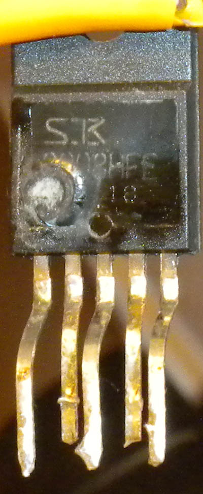

                            If it's the 5 pin ones, yes, you're going to have a hard time locating them. They are custom parts that go out of production soon after they're released. A new power board would be a good idea.

                              If the 5 pin IC is bad, I use findchips.com
                              http://www.findchips.com/avail?part=8008HFE
                              However, the cost of replacing all the shorted ICs may only be the beginning. Other components may be shorted after replacing these.
                              If you want the satisfaction of potentially fixing your board, then you may want to replace whatever ICs are shorted.

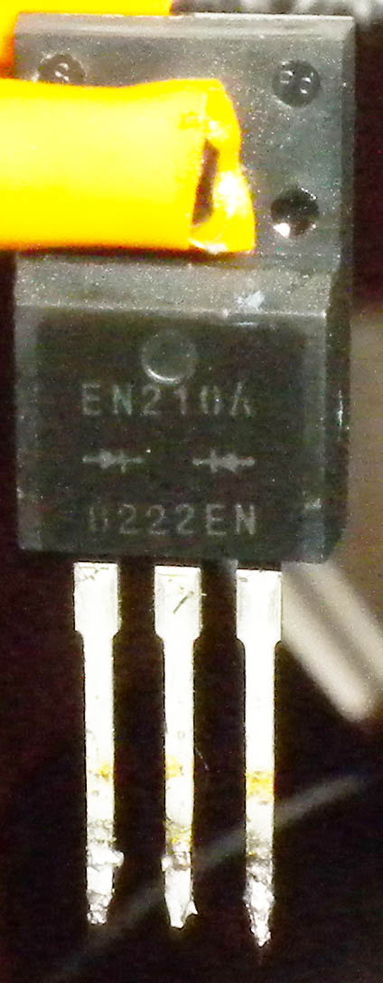

                                I attached pictures of the red, green (both marked "EN210A 8222EN", and light blue ("FCQ1A04") transistor .
                                When I pulled out the red transistor and measured it again, I got the following readings (counting pins from left to right using the attached pictures):
                                Black Pin 1, Red Pin 2 - Out of range
                                Black Pin 1, Red Pin 3 - Out of range
                                Black Pin 2, Red Pin 3 - 140.8 Ohms
                                Since the little icons on the transistor looked like diode symbols, I also tried:
                                Black Pin 2, Red Pin 1 - 140.7 Ohms
                                And just for kicks:
                                Black Pin 3, Red Pin 1 - Out of range
                                Black Pin 3, Red Pin 2 - Out of range
                                Because these readings looked better than when in-circuit, I pulled all the transistors and tested them. Out of circuit, the green transistor tested similarly as the red above:
                                Black Pin 2, Red Pin 1 - 141.5 Ohms
                                Black Pin 2, Red Pin 3 - 141.3 Ohms
                                Light blue transistor:
                                Black Pin 2, Red Pin 1 - 116.5 Ohms
                                Black Pin 2, Red Pin 3 - 116.4 Ohms
                                Magenta transistor:
                                Again, I tested using the black on pin 3, since the datasheet indicates that is the ground pin. Sadly, after pulling this one out, I could see what looked like a blister on the front (picture attached), and it tested similarly to when it was in-circuit
                                Black Pin 3, Red Pin 1 - 20.1 ohms
                                Black Pin 3, Red Pin 4 - Out of range
                                Black Pin 3, Red Pin 5 - 604 ohms
                                So I'm thinking, of course, the one that is broken is the one that's hardest to find?

                                      Farnell,UK 509 in stock:-
                                      http://uk.farnell.com/allegro-sanken...Ntt=SI-8008HFE

                                        Well, I'm back. I ended up getting that used power board off of eBay for $20, and I replaced all the caps on it. I plugged it in to the logic board, connected the front bezel, and plugged everything into the current limiter power strip. I turned on the power switch on the power board, and the light bulb flashed momentarily then went dark. I then turned on the monitor and again, the light bulb flashed momentarily, then went dark, while the blue power LED stayed lit. From what I understand, this is correct behavior.
                                        I then unplugged the monitor, connected the power board to the inverter board, and plugged the monitor into a regular outlet and turned it on. The power LED came on, the backlight came on, but it is solid white. Also, as soon as the backlight came on, something on the logic board popped. I attached a picture. It's labeled D701. Even after D701 popped, the backlight remained on.
                                        When I connect a VGA cable to my laptop and set it to use the 245BW, the backlight comes on, the screen is white like before, but it flickers often, but with a random pattern.
                                        I'm guessing something else is bad on this different power board that caused D701 on the logic board to blow?
                                          I don't think so. I think that unfortunately the main processor (the Genesis chip) is bad, and its excess current draw blew the diode.
                                          A working TV? How boring!
