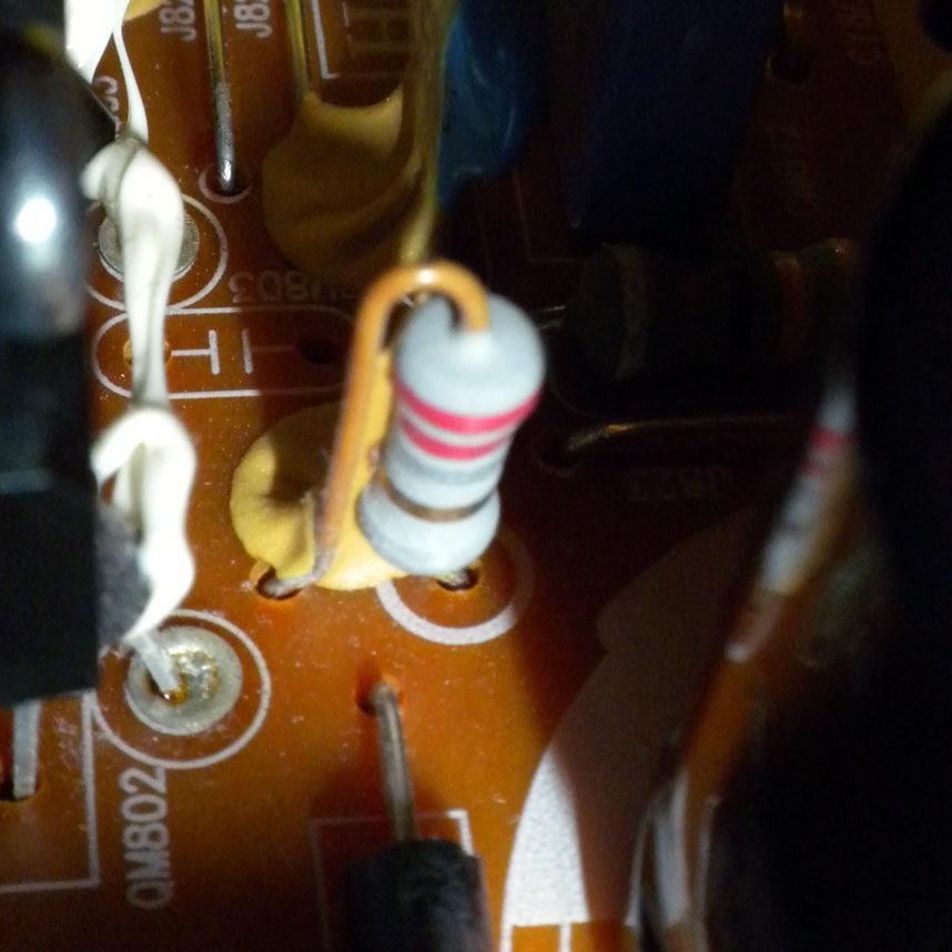

                      Unfortunately, my power board is different than the one most people have in the 245BW megathread. Mine is a BN44-00195A, whereas it seems most people are referring to the BN44-00173A board in the megathread.
                      I looked at the picture in this post to get an idea of the general area to look in:
                      https://www.badcaps.net/forum/showpo...4&postcount=37
                      That general area on my board seems to be where PlainBill and newbie1 identified the SMPS chip, and PlainBill suggested I replace those 3 capacitors. In that area on my board, I was able to identify the following resistors:
                      (Identified from the top of the board)
                      RB801
                      RB802
                      RB803
                      RB808
                      (Identified from the underside of the board)
                      RB804
                      RB813
                      I've attached a closeup of the underside of the board beneath the SMPS chip (STR-A6159). Then, using the link from Newbie1 as a starting point, I found the datasheet for the STR-A6159:
                      http://pdf1.alldatasheet.com/datashe...STR-A6159.html
                      I did my best to understand the datasheet, and I measured the resistance of the above mentioned resistors:
                      RB801 (R91 from the datasheet?) - 89k ohms
                      RB802 - 98k ohms
                      RB803 - 47 ohms
                      RB808 (R3 from the datasheet?) - 2.2 ohms
                      RB804 - 1.3 ohms
                      RB813 - 3.24k ohms
                      I'm actually not sure about RB813. When I measure it on the "20K ohms" setting, I get "3.24". But if I switch it to "200K ohms" setting, I measure "18.8"

                                      Using Retiredcaps thread to learn about how resistors are marked, I was able to identify what each resistor on the power board should be:
                                      Board location - Marked value - Measured value
                                      RB801 - 100K Ohms - 98K Ohms
                                      RB802 - 100K Ohms - 98K Ohms
                                      RB803 - 47 Ohms - 47.3 Ohms
                                      RB801S - 33 Ohms - 33.5 Ohms
                                      RB808 - 2 Ohms - 2.2 Ohms
                                      So it seems all those look good. However, there is another resistor, NE of the center cap in my power board picture, labeled RM801. From what I can tell, it should be 0.22 Ohms (red-red-silver?-gold). However, the reading I get is strange - Apparently, it's reading "0.56" when my DMM is set to the "20M" ohm range. That would mean 560K Ohms, right? I attached a picture of the resistor.
                                      When I measure RM801, I started at the 200 setting and it quickly showed out of range. The same thing happened at the 2000, 20K, and 200K settings. When I switch to the 20M setting, it starts decreasing from a 20.0 reading, quickly at first, until it gets into the 1.0 range. At that point, it slowly decresases, getting slower and slower, and seemed to settle around the 0.50-0.60 range.
                                      From what I read, an open resistor will show infinite resistance and a shorted resistor will show 0. This appears to be neither? Should I replace this resistor?
                                          I would definitely remove that resistor and test it out of circuit. If indeed it is open you have found the problem.
                                          Short explanation. That resistor is used to sense the current in the primary side of the standby power transformer. If it's resistance is high - or it has gone completely open - the SMPS controller will reduce the current - which reduces the output voltage. With essentially no load (logic card removed) you will get full output voltage.
