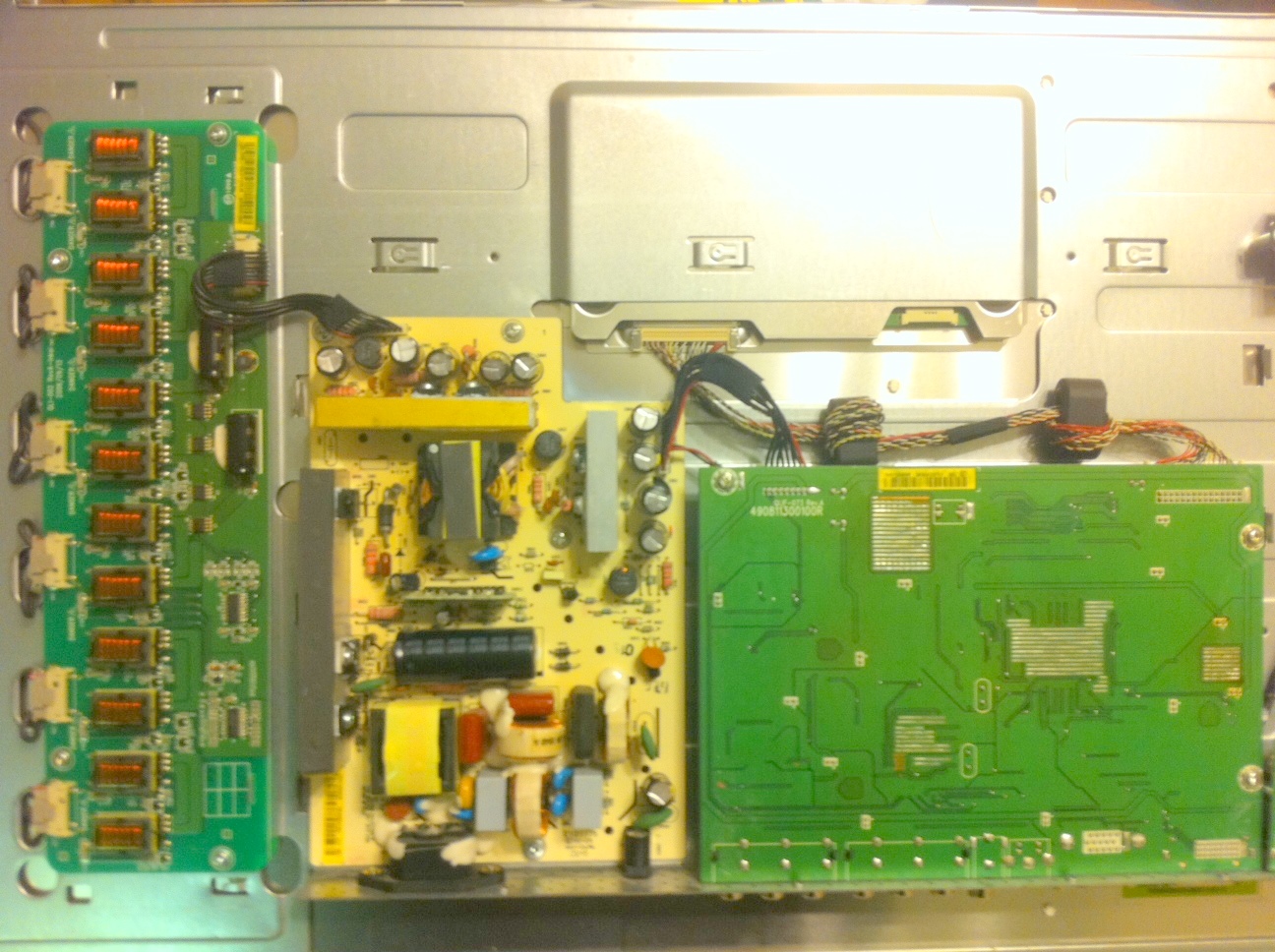

    5. A picture or two would be a big help. Are the power supply and inverter combined onto a single board or are they separate?

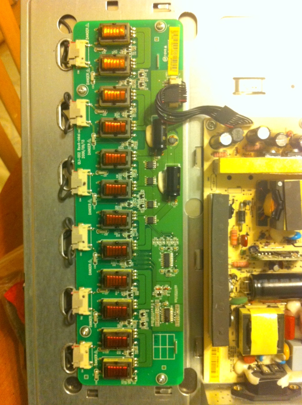

      It apears that the power supply and inverter board are seperate units. The inverter board is the long thin board with the 12 coils correct?

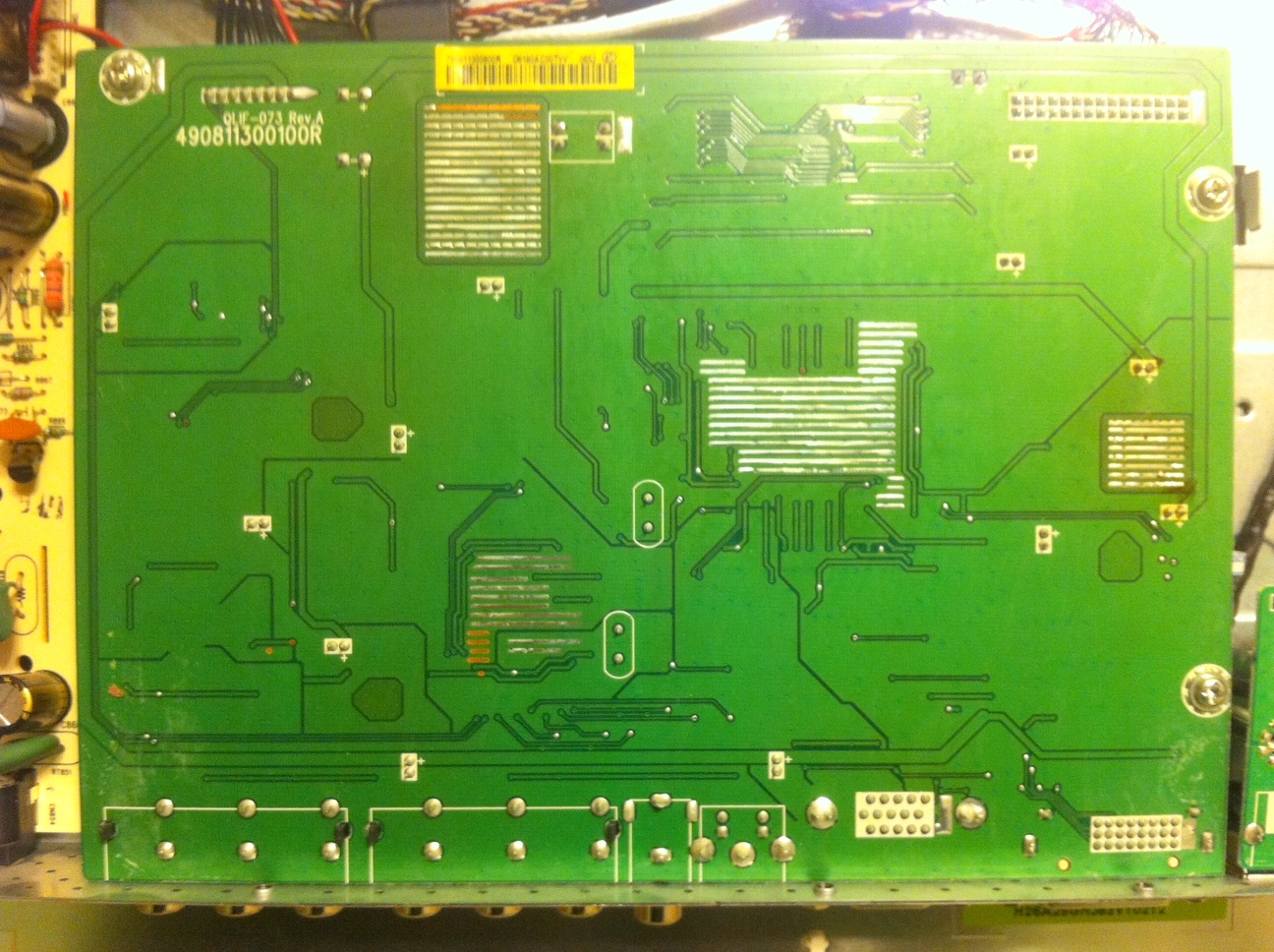

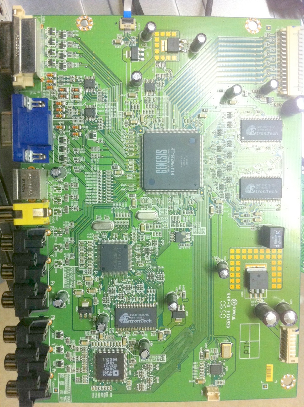

      I disassembled the monitor again tonight to take photos. I noticed that there are a few bulging caps on what I am guessing is the video board.
      Should I order new caps for the video board?

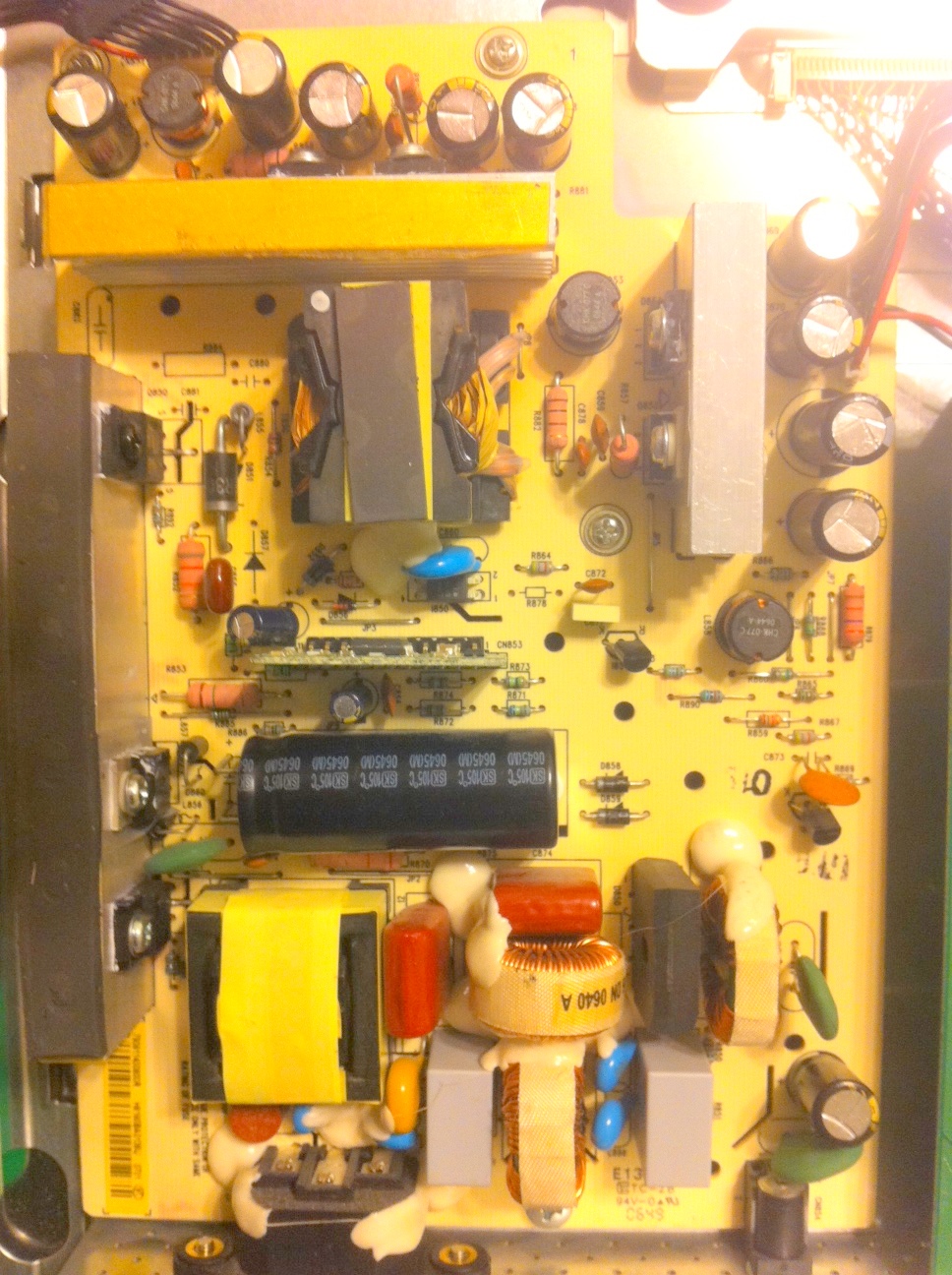

      Here are some photos for identification. I will take more in the daylight if needed.
        Definitely. The video board will not work properly with bloated caps.
        You can order them from digikey.com if you are in the USA. Change ALL the caps on the video board because I count 6 bloated caps and the others are likely to be bad soon. Use something like Panasonic FR, FM, or FC for replacements.

          If the monitor still isn't working after replacing the caps on the signal board, I'll need pictures top and bottom of the area of the inverter where the cable from the power supply connects.
