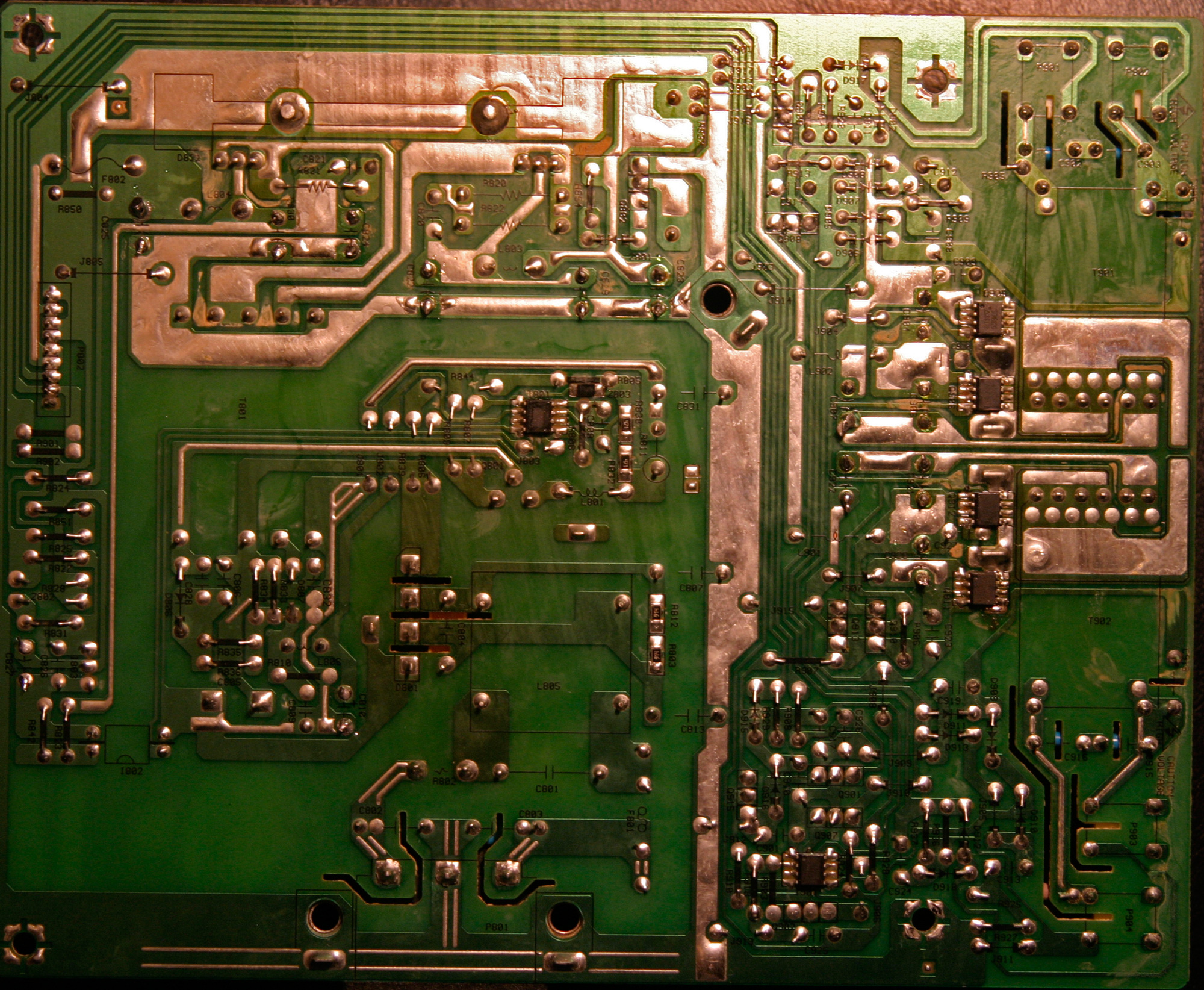

    So first of all I just found this forum, and am so pleased it exists. I was given this monitor by a friend about a year ago, and I just recently found the time to attempt repairing it.
    At first, the screen would turn on and worked for maybe 20 minutes before it started flickering. Then it would only turn on for maybe 30 seconds and then blink for 10 seconds or so, and go black. A flashlight test showed the image was still being displayed. The problem seemed to only get worse each time I tried to turn it on. A few months ago, I got it to work for about 25 minutes before the flickering showed up. Then like before it only got worse and worse, till it wouldn't light up at all.
    I randomly found some info about capacitors going bad, and causing this exact problem. So I found the correct caps in a kit on ebay, even though I saw no bulging caps, and did the replacement.
    At first glance it seemed to have worked. But after a few minutes it began blinking, and went dark. Today, after fiddling with the board a bit, wiggling and such, It seemed to have improved the problem. I was able to get it to turn on and stay lit for 10 minutes, before it started to blink. It seemed to randomly start blinking, but it didn't seem to just get worse. It would blink for a minute or two and then seem fine for a few minutes.
    However after leaving it on for 30 minutes, it went black, and now won't come on at all. If replacing the caps didn't help, what else should I try? I have a multimeter and test light. I still have the old caps that I guess were not bad at all.
    Here are a couple images of the power board. Could it be a problem with the lamps themselves or maybe the other board(display board??)?

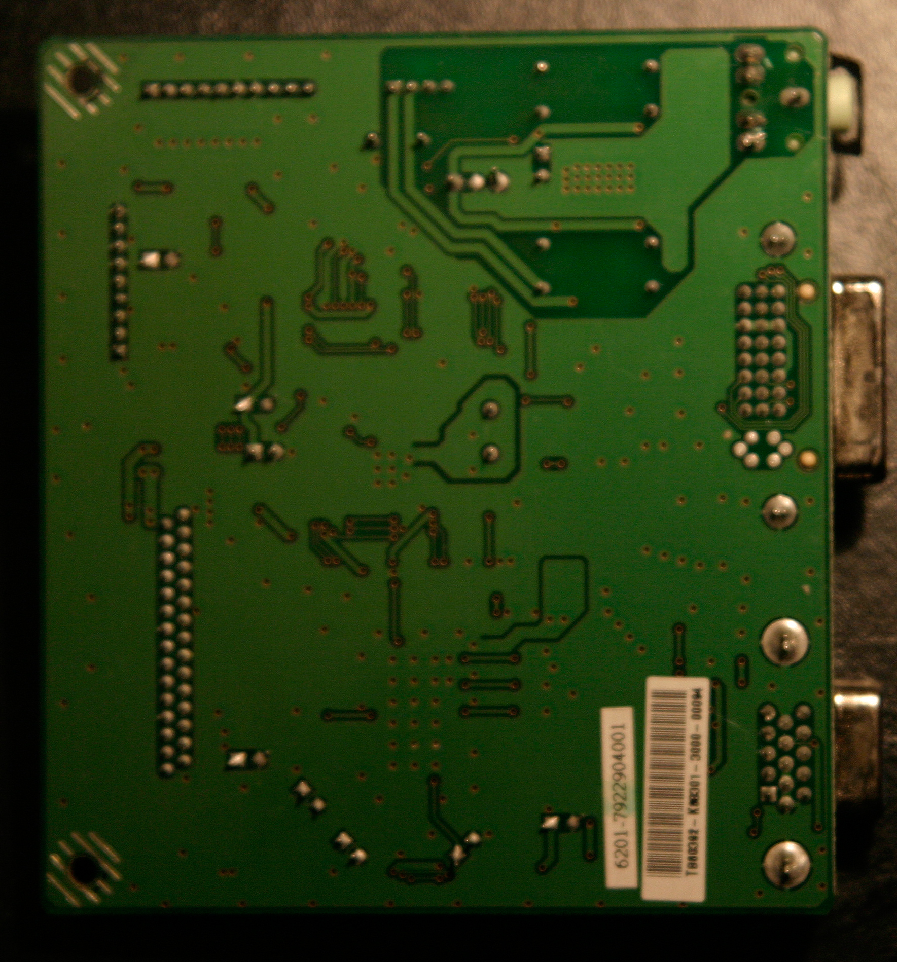

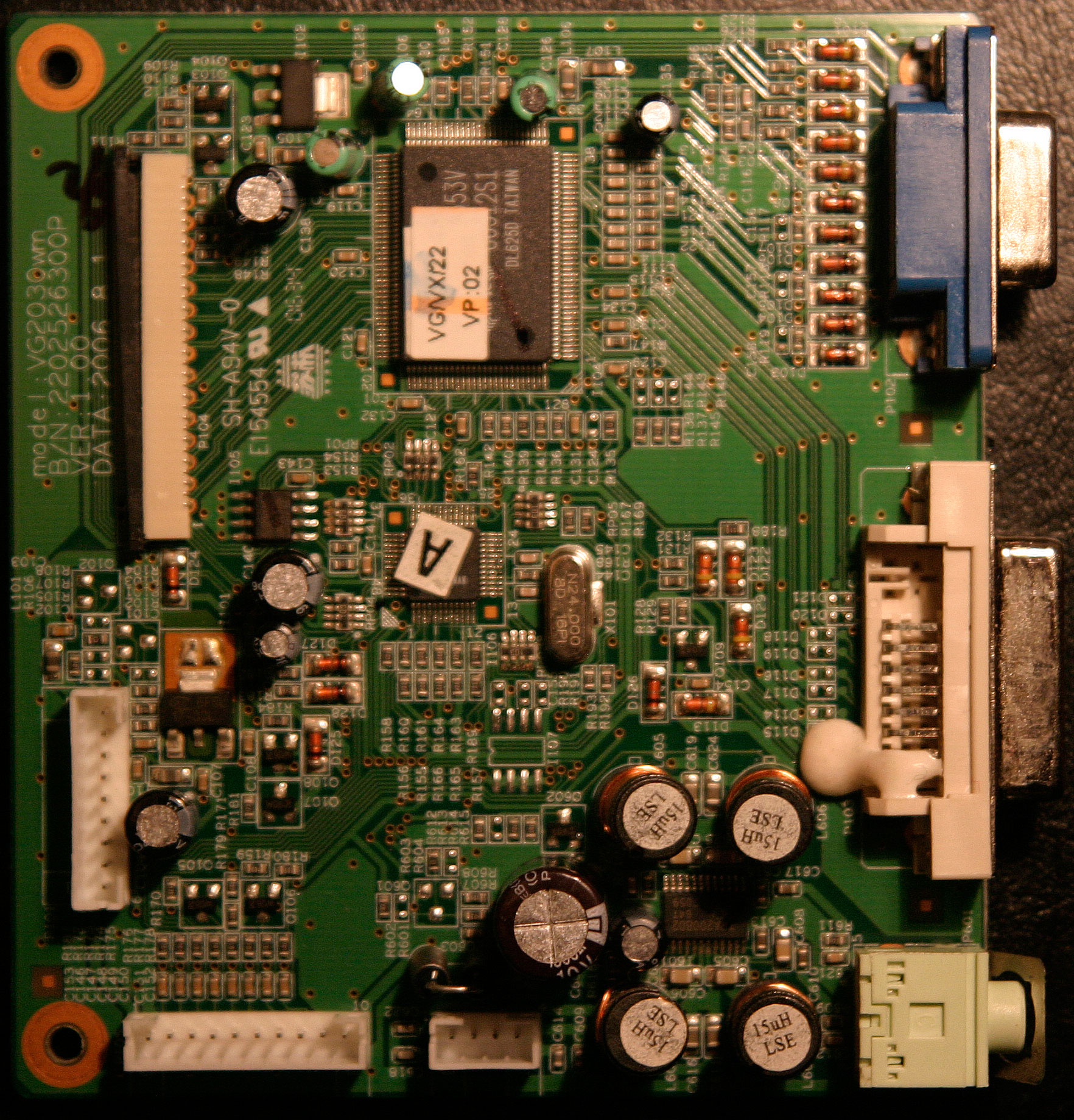

    My apologies for not providing more technical data about the parts I'm working with, and for placing inline photos, instead of attachments. I'm removing the images linked in the post above and adding them in my attachments, including images of the logic board, front and back.
    The caps I replaced were Hermei. The new ones I'm not actually sure what they are, but they have a M or W in a circle on the side. Thats the only mark other than their rating I'm seeing. Had I found this forum before I'd have made sure I was getting the recommended panasonic, even though I now get the feeling its nothing to do with my caps.
    The company I ordered the kit from states: "We only use high quality capacitors manufactured by Panasonic, Nichicon and Rubycon in our kits. We do not use CapXon capacitors."
    So today turning the screen on, it seems to work fine. I don't have a dvi or vga port to test the monitor with atm, but the "no signal" screen comes up bright, no flickering every time I turn it on. Though I imagine like yesterday, if I leave it on long enough, or turn it on and off enough times, it will again flicker for a while and then finally go black. This makes me think the problem may have to do with heat? If the longer its on the worse it gets, till finally, the light goes out, and won't come back on until the its been off for a couple hours or so(untested, just about how long I've waited to try again), then it seems like something is "buckling" under heat right?

      Re: Viewsonic VX2235wm ver-3 -replaced caps-still blinks
      those caps are actually panasonic/matsushita (the M-in-a-box is for Matsushita)
      from what i can tell on the pic, they seem to be FM series..

        You could have a bad ccfl or ccfl wiring. See
        http://s807.photobucket.com/albums/y...klight%20lamp/
        for some examples.
        You may also want to check your board for poor soldering with a 10x magnifying glass/loupe.

          So I may have come upon a somewhat unorthodox test, but with the monitor plugged in and powered on, not connected to a computer, the no signal screen comes up bright the first dozen or so times after not being on over night, then around 15 times turned on and off, the no signal screen begins blinking every time I turn it on, more and more each time.
          Well I thought Id try unplugging the 10(9?) pin connector between the power and logic board, and the power led goes black, but the screen shows solid white, no blinking whatsoever, and when reconnect the "10" pin connector the no signal screen comes up, blinking a few times before the monitor goes to standby, like its been doing.
          So since this bright white screen comes up solid, with no flickering, shouldn't that tell me this has nothing to do with the ccfl's at all? No pinkish hue either.
          Could I even go as far to say that the problem only occurs once the logic board is powered, thus it's likely this is where the problem is?
          And about the "10" pin connector I've read about on other threads about this model, I'm only counting 9 pins, and I've even found a thread with the same boards that I've got, and counted 9 pins on there, yet the connector is being referred to as a 10 pin. Am I missing something? The post I'm referring to is post 9 by retiredcaps in https://www.badcaps.net/forum/showth...ght=vx2235wm#9
          Thanks for the help!
