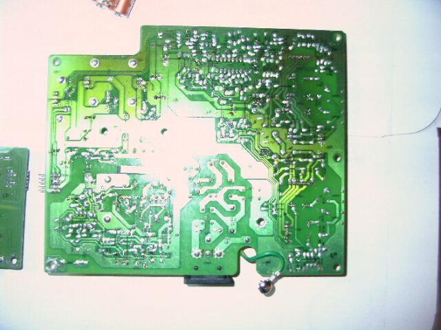

                As it all worked out of the case but not in, I should concentrate on what has changed.
                I dont think we have any pictures of your boards - that might help us spot something.
                Any extra long legs on any components that might be touching something, any tall caps that might be touching something. Is the "Keys" board fitting in ok back not touching anything. All connectors firmly connected and a working pc source connected?
                Can the lamps or wiring be arcing out anywhere to the case.
                  Re: Dell E172fpb
                  Two pics attached?
                  Preview shows them, we'll see, maybe.
                  I'm sure I can do better, but don't have a clue as to what they'll turn out when I take them. Any hints?
                  There are no tall caps, all are as when I opened it up. Perhaps, likely, moved to a different spot on the board, as I removed and tested all. The 'keys' board is in a bezel that surrounds the screen, and was insulated, etc, when testing. Once I put the two boards in the case, and attach screws to hold the boards in place, it quits working. I don't think it is a torque situation where the board is twisted or loaded funny. The CCFLs will not light up when the boards are mounted in the outer metal shell with the perforated panels, and the power switch green led flashes constantly until the power switch is held to depower the board.
                  These two pairs of lamps ride in a U shaped metal channel that then slides into openings at the bottom and top of the display assembly. They operate fine when waving in the breeze, and also when they are inserted into the display cavity. Well, I think fine, as I have the screen face down, and can see the 'floating rainbow' moving around. Cannot really observe the brightness as I can't get a direct angle, but they sure burn bright. Testing that was my 1st thing after finding it didn't work when assembled. Laid cardboard on the back of the display, connected the loose CCFLs, connected logic board, key button board, and power. Push button, lights after ~2 seconds. Install CCFLs and do the same test, lights work. I have not tried having the case separated from the panel by an insulator, and think it wouldn't make a difference. I think there is a component that is loading the inverter when the logic board and the power/inverter board are connected to the case.
                  The AC ground pin on the board does not connect to board itself, so it is not a power ground situation. I *think* the 'cold side?' ground is isolated from the switching power supply ground, but may get connected when the board is put into the case. I haven't really wrapped my mind about that except in the case of a TV chassis with a switch mode power supply. That I can visualize and understand. This thing, staring at the PDF file I downloaded, Benq_Inverter_Schematic.pdf, is confusing. In that schematic, the 2.2uf50V near the lower right is the only thing I see that is connecting to 'ground' directly other than the C5707 transistors.
                  May be I am getting too old to do this stuff any more.
                  The last thing I was thinking about was insulating the mounting screws from the ground pads on the inverter board, so that it would not connect through the screws to anything as the other side of the board is bare insulate. I was fearful of some sort of floating ground sending power backwards through something and loosening the magic smoke to the world, so am asking if that is a valid test?

                    Pics are not really big/clear enough for troubleshooting however looking at another pic I see that some of the holes have a solder ring and other dont. Try mounting it in the frame with only screws in the holes with solder rings.

                                Is my second picture useless as well? I took it upstairs into the sunlight, and tried to get the image to fill the frame. Any hints?

                                Results of insulating the trace side of the circuit board with cardboard: same, blinking power light and no CCFL fire.
                                Results of insulating the frame from the backside of the display panel, same, blinking power light, no CCFL fire.
                                Ugh. That means trying to figure out which bits are dysfunctional. I think I will stare at the schematic and attempt to 'isolate' one part of the board at a time if possible. I don't think the logic board would cause this, but it does diddle with the brightness control, I think.
                                tom
                                  Re: Dell E172fpb
                                  In my case, I found that there were two places where grounds could have been connected by the case. Both were from the SMPS, one where AC line was coming in, the other further on.
                                  Given that, after isolating those grounds, it still didn't work. Made no sense. There must be something that changes when the boards are mounted to the case.
                                  It was one of the new C5707 hitting the shield apparently as it works now, displaying these words. I made sure to tilt it away from the slanted case, and it must have cleared as it is working fine.

                                    That section of the chassis is slanted, now it makes sense why it stops working, I was surprised it did not blow the inverter fuse, but I am glad you figure it out, good job.
