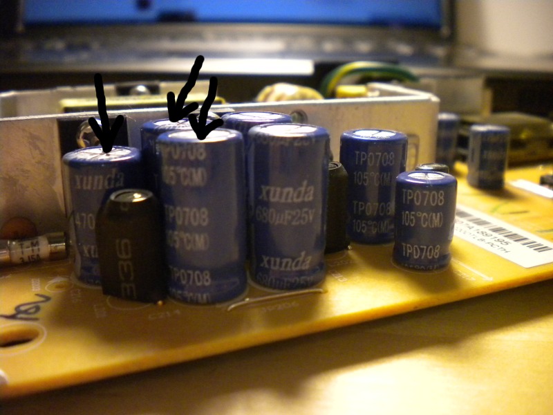

    Hello there,
    This is my first post, so please feel free to let me know where there are bits of information I haven't covered (or tell me that I haven't done enough work yet to be asking questions!)
    I have a Hyundai N91W monitor which will operate for only 3 or 4 seconds at a time. The monitor powers up, displays a perfectly good image, then immediately switches to standby. The monitor will happily start-up again, simply by pressing the front-panel power button, but almost always switches off after a few seconds. Once in a while, it is possible to get the monitor to stay switched on (normally after about 40 power cycles - I'm persistent if nothing else). It will then stay on without problems until it is powered down (this includes screen-restarts when changing resolutions, or the PC going to sleep). It is then once again a matter of perseverance to get the monitor into a usable state.
    From the information I've read on the internet I think that there are possibly bad capacitors on the power inverter. I've taken the monitor apart and had a good look at all the components. Using this guide I have identified 3 capacitors (2 x 680microfarad 25V and 1 x 470microfarad 25V) on the power inverter which don't appear to be charging.
    I should mention that there are no signs on any of the component boards (that I can see) of any burst/swollen caps, heat damage or anything else which looks out of place.
    The monitor is out of warranty, so I'm happy to play around with the innards, but I only have the most basic equipment (multimeter - without ability to test capacitance, screwdrivers, soldering iron, etc).
    Having looked on this forum, I can only see one thread that mentions the N91W in a related problem, and the poster says they replaced a large number of capacitors on their power inverter.
    I would like to ask the forum if, given the symptoms described, my current course of action seems appropriate, and if they would recommend any other steps I could take to try and track down the problem.

    What brands of caps are currently in the monitor? Some (Sam Young) are 'replace on sight', some (Capxon, Elite) are notorious for failing, some (Panasonic, Nichicon, others) are noted for reliability. If your monitor has known crap brands the best approach is to replace the full set of electrolytic caps. If you are in the US and order from Digikey it will cost about $10.00

        Thanks for the reply PlainBill.
        The caps seem to be "Xunda". I'll include an image here, and just for reference I've indicated the three that I suspect are faulty (though they don't look any different from the rest).

            replace all xunda.pure crap.

              Re: 3 seconds usage on Hyundai N91W
              What you describe sounds like capacitors with high ESR (ohms). When the caps get warm, the ESR drops which allows the lcd to operate properly. When the caps are "cold", they have high ESR.
              There are a couple of ways you can check for high ESR.
              1) The most obvious is to use an ESR meter. These meters are designed to measure ESR, but unfortunately cost between $65 and $300. For a one time lcd fix, it is not economical to buy one.
              2) Use a hair dryer and carefully warm up the capacitors only and see if the lcd powers up and stay on.
              As others have mentioned, you want to use high quality low ESR replacements. A list can be found at
              https://www.badcaps.net/forum/showthread.php?t=2280
              Members here advise replacing all the electrolytic capacitors except the largest one which rarely, but not never, fails.
              BEFORE ordering the caps, you might also want to check the inverter transformer secondaries to make sure they are okay. Details can be found at posts 13 and 14 at

                Xunda,were used in a lot of Proview Monitors, and failed on a regular basis.Although your photo does not show the whole board from the top,I see that there are 2 of those caps near the Inverter transformers,and they may well be the cause,HOWEVER change them all as already advised.

                  Xunda = replace on sight. all of them.

                    Thanks for the advice!
                    The inverter board is marked as Proview, as are several of the other boards, actually. I have some Nichicon caps on order, so hopefully they'll do the trick.
                    I will update with my progress once I've replaced all the Xunda caps.
