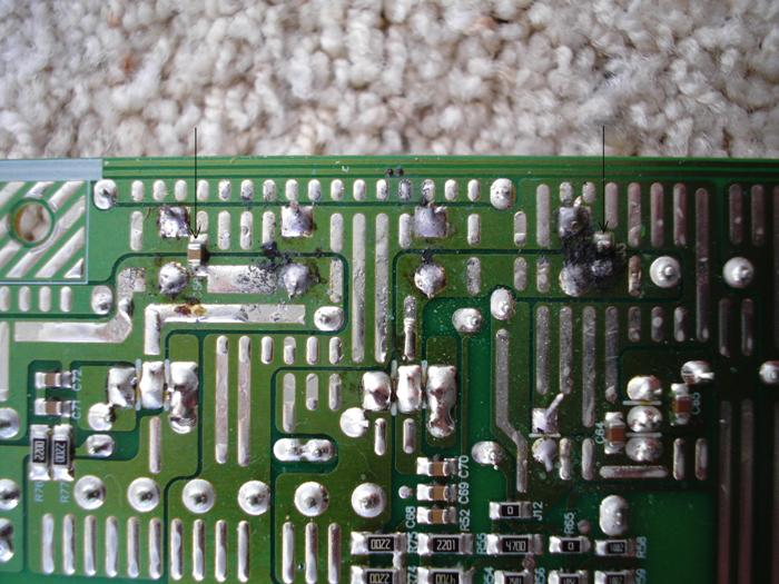

    Identify Hanns-G HC194D XAD819AR cap
    I put some new caps in because it was taking 20 minutes to boot. And it worked fine for 4-5 minutes before another capacitor smoked and blew. This is one of those tiny ones with no legs. Looks like 2 silver posts with plastic between them. I've enclosed a picture link with a couple arrows (one to a good one and one to the toast). Do you know what capacitor that is and if so is there some polarity for this style?

    It's a poly cap, and when you attach the picture to your next post someone may be able to identify the value.

            That worked. Argghh!!!! I'm losing it!!! Those are surface mount ceramic caps. There is no polarity BUT they have been known to short internally. Identifying their value is a PITA without a schematic.

              Re: Identify Hanns-G HC194D XAD819AR cap
              I usually just replace them with ones of the same size. Seems to work fine (or maybe I've been lucky every time). I still find it better odds than finding a schematic, though.
                  Originally posted by deskjockey
                  Did you find your ceramic caps at a local supplier or online.
                  Neither, actually. I just have a bunch of dead motherboards and video cards around and they all have plenty of these.
                  If you're in the US, though, you can get these caps online from either Digikey or Mouser. Locally, I'm not sure where to get these, other than other broken electronics .
                  Normally, I just replace the bad ones with others of the same physical size.
                  I suggest measuring them in millimeters, since you can then use that size to find a proper replacement online. For example, a 1608 (metric) multi-layer ceramic cap is 1.6mm long by 0.8mm wide.
                  The ones on your board seem bigger than that - probably something closer to 2012.
                    If that cap is connected to a pin of an integrated circuit or transistor, then one may be able to go back to the spec sheet for that device and make an educated guess as to what the value is.
                    Another possibility is to measure the capacitance of the good cap to the left of the burned one in the hopes that they're identical. Know anyone who has a cap measurement function on their meter?
                      The burned cap is in parallel with several other caps. All it does is keep the circuit under control if all the other caps go bad. It doesn't need to be there so it's value isn't important and you can replace it with any size you want so long as the voltage is sufficient. If the circuit works it will work fine without it.
                      I would ensure that all of its remains are cleaned up then I'd go looking for what burned it out.
                        Guys thanks for the input. I think when I soldered that maybe it shorted from splatter or runny solder. The two posts are right on top of each other from the replaced cap and this one. I'm going to check my old boards for a cap to use although most of my stuff is from the 60's. I'll see if anybody local has such stuff.
