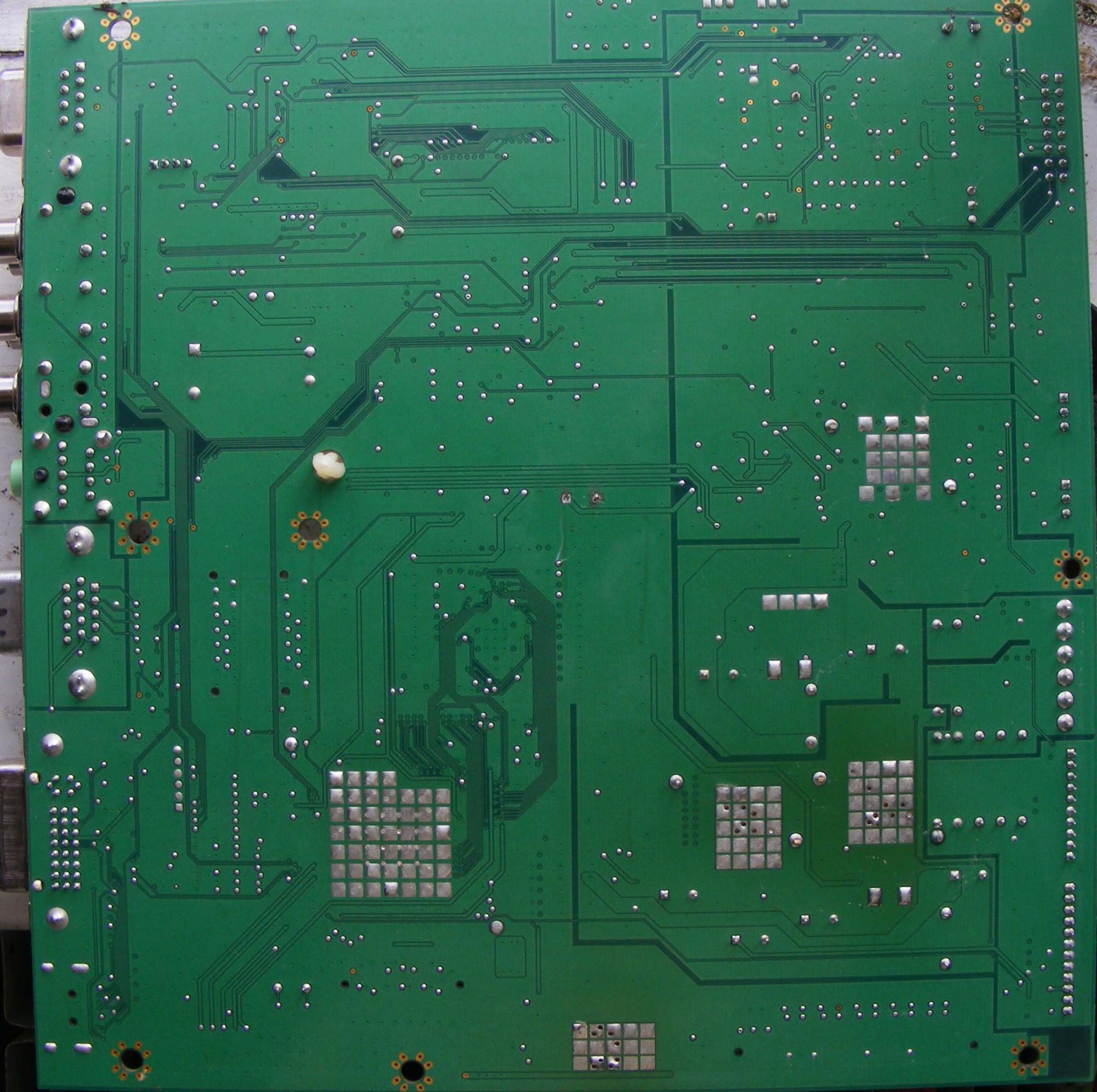

        1) 1) Post clear focused pictures after reading
        https://www.badcaps.net/forum/showthread.php?t=1868
        2) Please do not post pictures inline as they slow down the loading of pages.
        3) For best picture quality and clarity take your boards to a window on a sunny day, turn flash off, and use macro mode. Take a top down view of all your boards (front and back). Make sure the photo is legible so that we can read the PCB printing clearly. A shutter speed of 1/125 or faster will produce nice clear focused pictures. Try to get a photo that is 2000x2000 resolution or as close as possible.
        4) Here is an example of the pictures we want.
        https://www.badcaps.net/forum/showpo...94&postcount=1

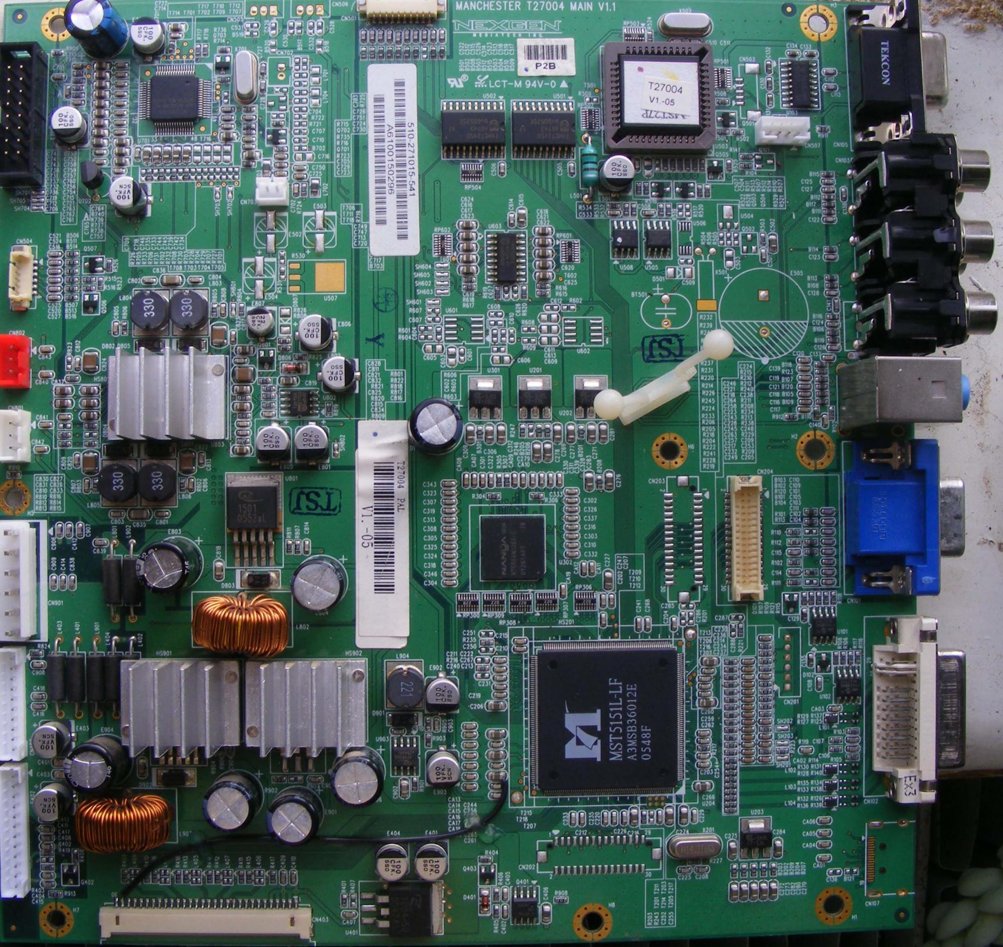

              I note the comments about the failing Voltage regulator and looking at the logic board I can see a discoloration on the board under the HS901 and this I think is the heat sink for a voltage regulator is that correct ? (sorry but I only have a very basic knowledge of circuits) if so maybe it would be better to replace this before the caps and see if that solves the problem
              I have attached pics
              Thanks for all the help guys

                    There may be more than one voltage regulator on your logic board. What are the part numbers for U201,202,301 located middle of board? Part number for U203 located lower right. Part number for U401 at bottom of board.
                      Re: intermittent fault on my Miria T27004 monitor
                      U201 is -5JCL 17-25L
                      U202 is -5KGL 17-33L
                      U301 is -5JCL 17-25L
                      U203 is -5KGL 17-33L
                      U401 is -PF7AL FDS 9435A

                        Using a mounting screw for your ground probe, measure and record the voltage at each leg for U201-203 and U301.
                        As for U401, it looks like you gave the part # for Q401 because looking at your photo I can vaguely make out 1084-?....Anyway, go ahead and please measure and record the voltages at the 3 legs of U401.

                              Looks like the regulator outputs are good. I'm starting to wonder if the LCD panel itself is the problem. You said the lines don't appear for a while. May I suggest trying to accelerate the problem by heating up the logic board with a hair dryer? If you get the lines in short order with the hair dryer, then we can suspect the logic board. If not, then try heating along the top inner edge of the LCD panel. I'm suspecting that the flat ribbbon cables that run the top width of the LCD display are started fail at the weld/solder points. This type of failure is not repairable.
                              If none of the above reproduces the problem, I would try replacing the 8 electrolytic caps with something like a low-esr panasonic FM or FC series cap.
