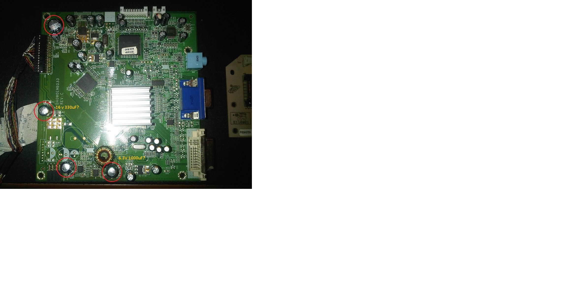

                                          Hi guys!
                                          I need some help! I had same problem so i Have decided to give it a try. I have ordered and replaced all of them faulty caps beside two. I am not sure which goes where. I have taken photo before I took them out but cant see it clearly on photo due to the light reflection.
                                          Please let me know which goes where if you have any clues.
                                          See them two on pic below.
