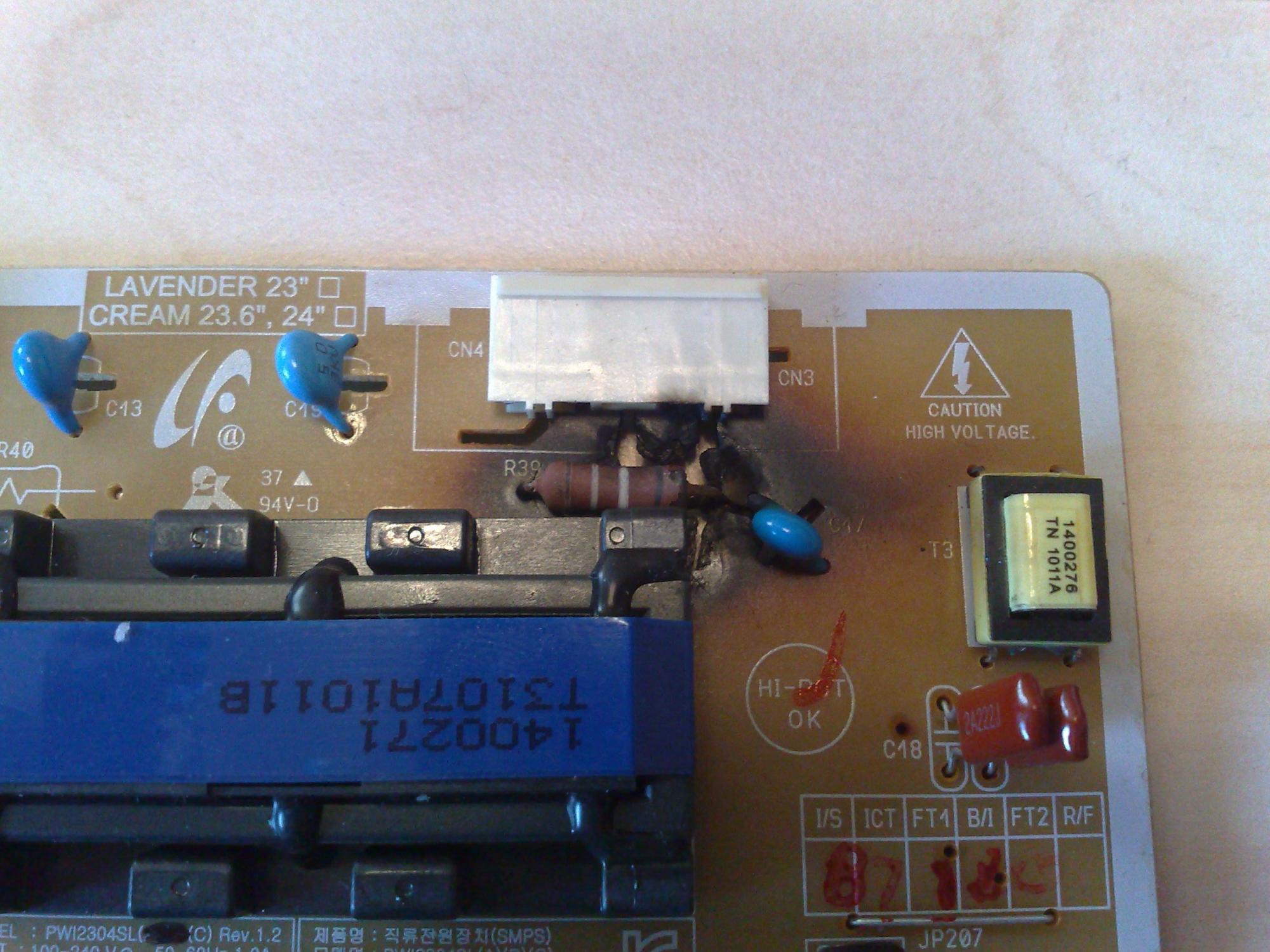

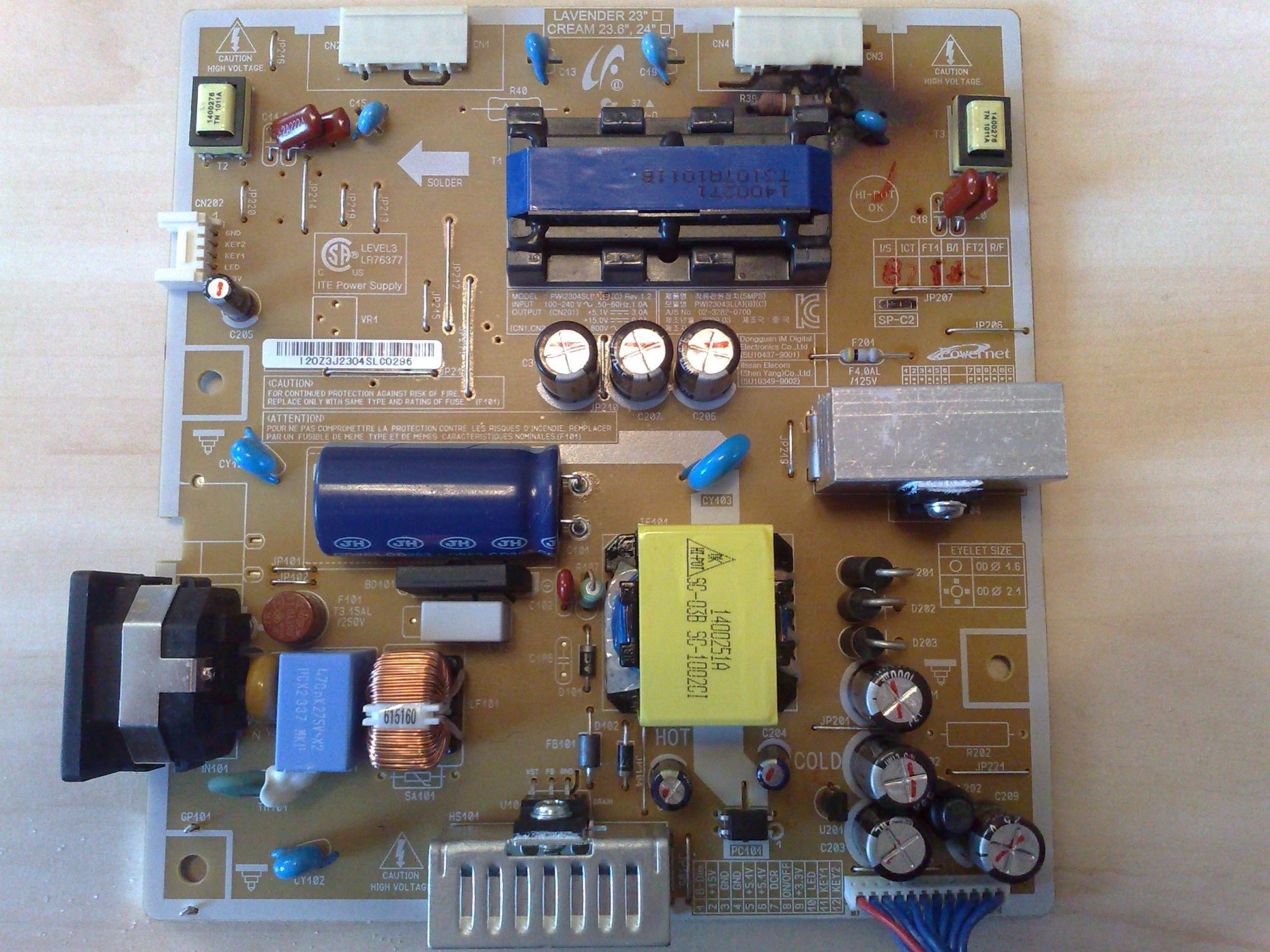

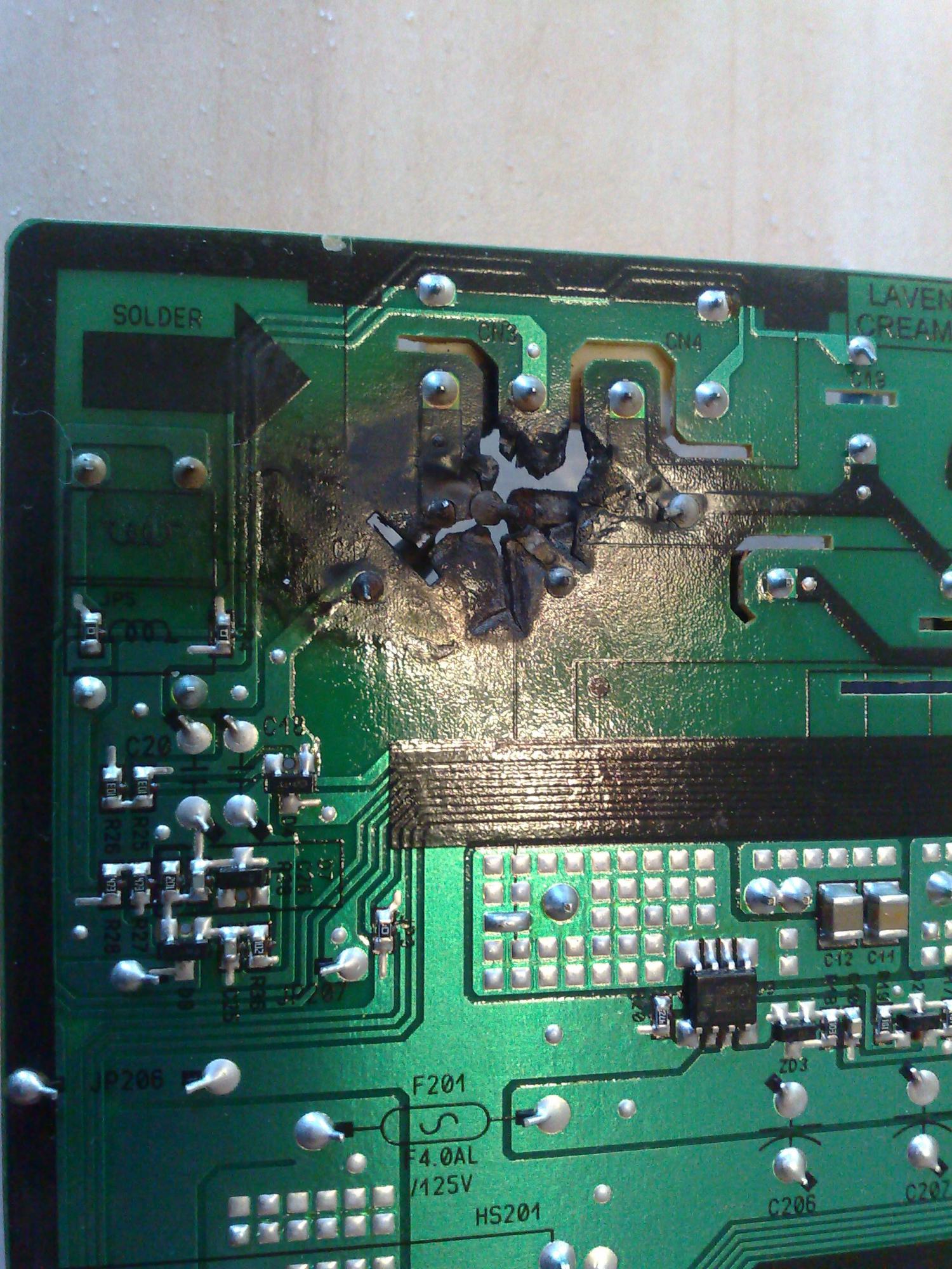

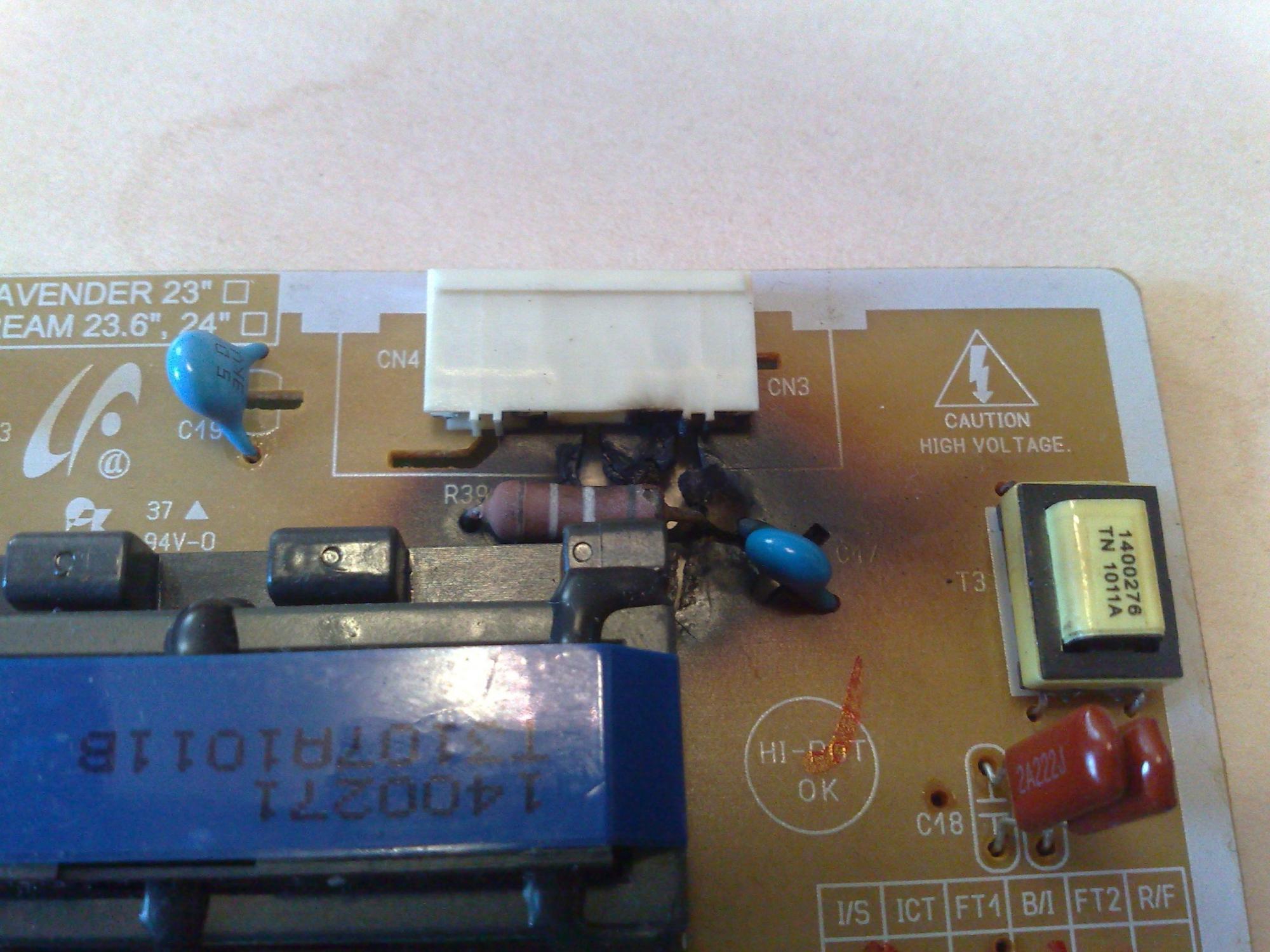

    Hi there i have just bought a monitor a samsung p2450 which i was told the screen would go blank after a couple of seconds. So on testing this that is the case. So i thought it would be faulty capacitors as it mostly is with samsung monitors. But when i opened the monitor up this was not the case. It has a big burn mark and a hole at CN3 ,CN4 next to a resistor and a capacitor. what would cause this,Is it repairable , or can i try and connect a universal 4 ccfl lamp inverter to this board to get the monitor working again.

    With some time and effort, this board could be fixed. The pins of the ccfl connector would have to be cleaned to prevent arching. The traces need repaired or replaced with wire of certain guage. I'd replace the resistor too. If it were a smaller monitor, I'd say forget it. Once the board is cleaned up and that part is replaced, you still dont know what else is bad on the board, if anything.

      I iamagine that my concern here,if I decided to try and repair, would be whether the transformer is 100% OK !!!!

        I agree with Rtech that the short drawing that much current may have damaged the inverter transformer and other surrounding components. Also, what caused the short? I'm guessing that one of the CCFL tubes shorted to the case, so that needs to be addressed by looking at the CCFL tubes and wiring.

              If your Board is burnt as badly as the one shown,then attempted repair would probably create more problems than it would solve.If 2 Monitors have done the same thing,then even a replacement Board may also go the same way.I would probably test the screen using another 24" Monitors internal parts,and then think either about using that and the Logic Board as spares or offer them for sale.I would think a good 24" Screen ,would bring in a good price.

                  Got the case off and found the power board looked like - but not quite as bad as - the pictures posted previously by garrymc123.
                  Found the whole board for $29 plus $8 shipping at http://parts-lcd.com.
