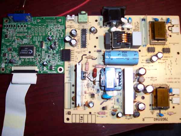

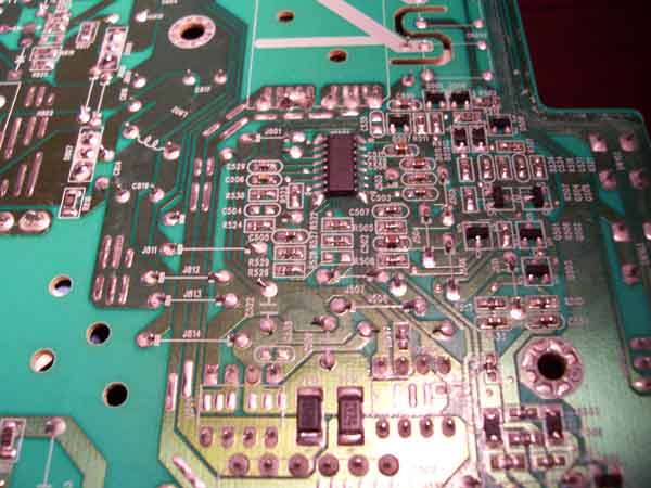

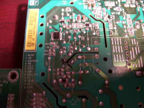

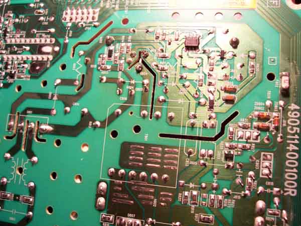

    i posted on a nother thread and got kind of hijacked so i thought i would start my own here. here is what i already posted
    Quote:
    Originally Posted by scampo77
    i came across this thread on a google search and i am very excited to be a part of this forum. i am very new at this but i really want to learn how to fix my problem. i have the same same power supply it is slightly differnt so i included a picture .i have different symptoms, mine is just dead. i seem to have DC voltage for the first bit of the board then when it reaches the blue transformer (P/N SPW-055 Rohs) i have +-160vdc going in and nothing coming out. also next to it there is a cap (JNC JM472M) and a 4 leg zener diode (P/N 817B)all have voltage on one side and not the other.
    im not too sure what i should measure next or what to pull out next
    any help would greatly be appreciated. please keep in mind im willing to learn but im new to this

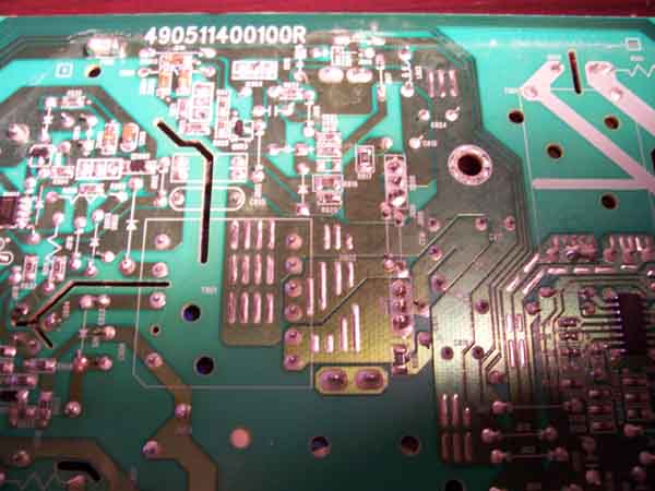

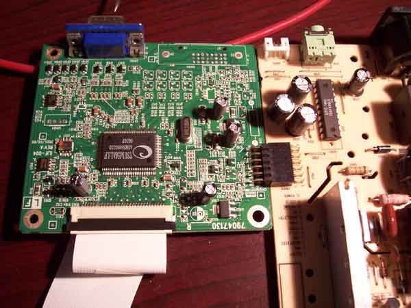

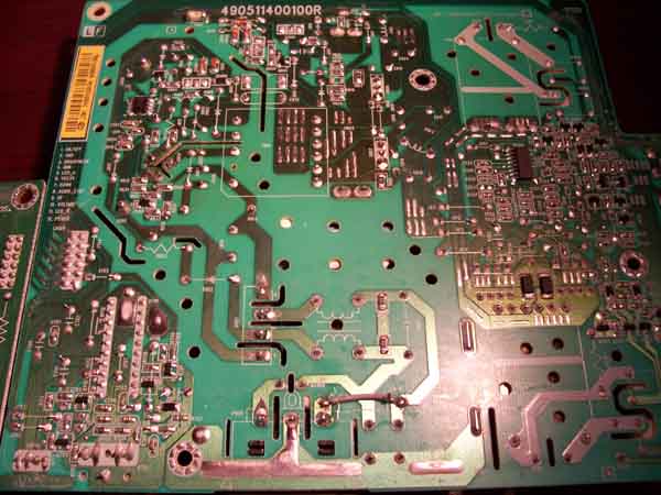

    Welcome to the forum! Good initial try at trying to figure what's going on. Here's what you need to do:
    1) post some photos (top and bottom) of the entire power board and logic board (the board you plug your video cable into) per PlainBill's links on post #45
    2) I think you're measuring the 160VDC off the bridge rectifier. This should be the same voltage across the 450V main capacitor.
    3) looks like you're getting voltage to the PWM controller chip.
    4) when you push the power button, does it show any activity?
    5) any flash on the screen when you push the power button?
    6) any other observations will be helpful.

      Re: xplio computer moniter
      yes the 160dcv is the same as the big cap
      the power LED just keeps blinking green
      i have zero volts at either inputs of the high voltage transformers
      and no blinks of brightness or attemps at the moniter display lighting up or powering on even for a second
      when i toggle or hold down the power button it seems to make no difference at all in the intervals of the blinking green LED it comes on for about 5 secs then off for .5 sec and just keeps cycling

        sorry, your quick!! i thought i could get up both posts before someone would answer. i figured it would be too long for one big post

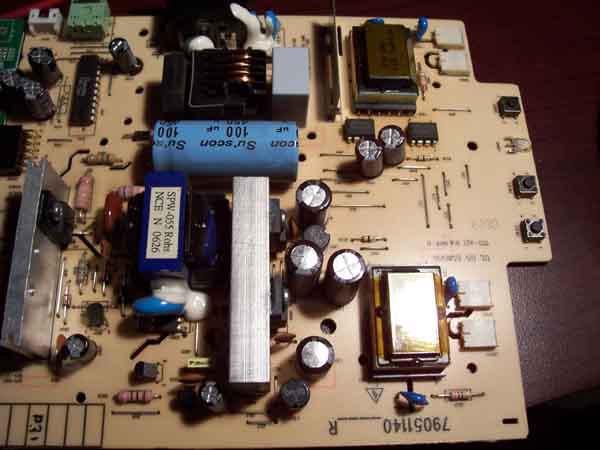

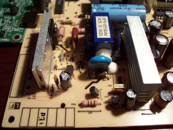

          You have at least 2 bloated bad caps (just right of the schottky diodes). This is why we always ask for pictures.

            Most here will suggest you replace all the electrolytic caps on the power board except the largest one which rarely, but not never, fails.
            If you live in the USA, you can follow PlainBill's instructions to order Panasonic FM caps (FC is a 2nd choice). See

                The diodes that are mounted on the heat sink give off a fair bit of heat. Caps die from heat. So the closest one take the full brunt of the heat.
                The diodes produce the 5V DC for the logic board and another voltage for the inverter section. If those caps are on the 5V rail and are bad, the logic card will not get proper voltage to operate normally.
