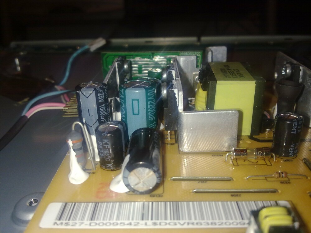

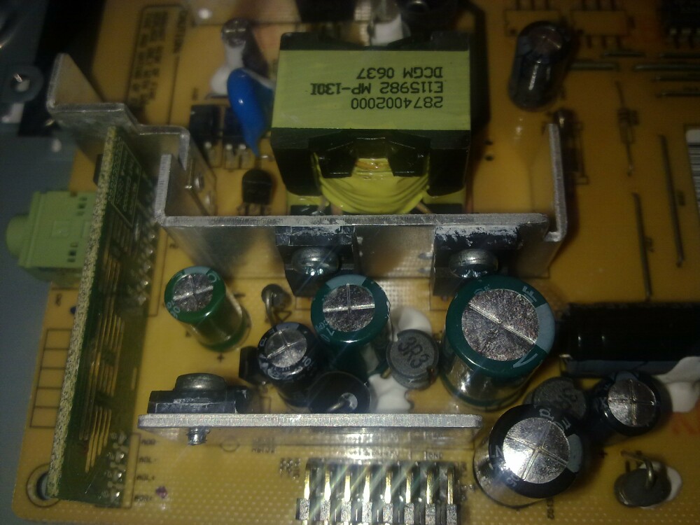

    Came down this morning to find my Panasonic monitor displaying a blank screen, but the LED light on the front displayed blue (the monitor should be on and displaying). A quick google search and flashlight test later showed that my backlight wasn't functioning.
    After reading several posts here, I disassembled the monitor and found the bulging CapXon capacitors that seems to run rampant in these monitors. Of my 8 capacitors I have 5 CapXon and 3 Taicons. None of the Taicons are bulging. Should these be replaced as well? Is there anything else I should do other that replacing the capacitors?
    Thanks very much,
    Brandon
    The members here recommend replacing all the electrolytic capacitors except the biggest one which rarely, but not never, fails.
    Capacitors die from age, heat, and shoddy build quality. Capacitors DO NOT have to be visibly bloated in order to bad. They can be out of tolerance uF (a 1000uF measures 20uF) and/or have high ESR (ohm). A multimeter will be insufficient to test for ESR. For that you need an ESR tester which costs between $50 and $300.
    Most members here will recommend that you replace ALL capacitors with reputable brands from reputable sellers. Brands like Rubycon, Panasonic, and United Chemicon are suggested.
    If you live in the USA, follow PlainBill's instructions to choose Panasonic FM (preferred) caps. If FM is sold out, then choose Panasonic FC.

      Thanks for the reply. I removed all of the capacitors from the board this evening and have found their matching components at Digi-key per your link. Everything looks the same dimension-wise except for the CapXon 25V 1000uf KF capacitor. My measured dimensions are 10mm X 20mm but the Panasonic FM and FC is 12.5mm X 20mm. One of these capacitors goes into a tight space and I don't think a 12.5mm diameter would fit unless I leave long leads. What should I do?
      Thanks,
      Brandon

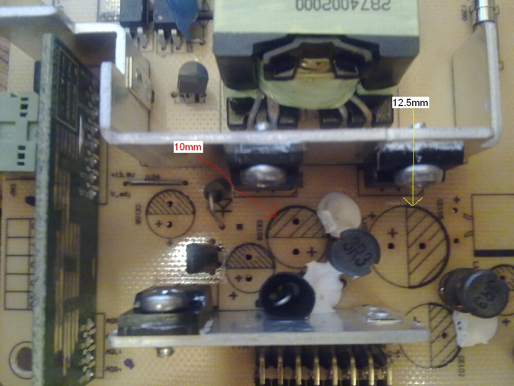

          Can you post a picture of the board where the fit is tight? Or list the cap values around where there is a tight fit?
          I have one idea that might help. For the caps around that tight area, we could go a smaller dimension cap but still the same uF and V. That might free up enough space to get the 12.5mm diameter 1000uf 25V?
          If that doesn't work, then
          Buying caps from badcaps.net does help support this forum, but badcaps.net doesn't always have the same selection as the bigger distributors.
            Here is a photo. There is a spot where a 12.5 diameter capacitor sits nearby so I labeled that for reference.
              Not suprised the caps closest to the heatsinked devices went bad. Too much heat. Don't go any higher in diameter as that will put the new cap even closer to the heatsink. If you can go 10mm on the 12.5mm cap, that would also be good.

                  I just went back and looked at some old pictures and realized that I'd messed up on my drawing showing where different capacitors went. The bottom right 10mm circle is the one thats supposed to get the 12.5mm capacitor. It's not that tight so it would fit.
                        If you are talking about CE102, you can "lean" the capacitor. You don't need the capacitor to stand straight up and down.
                        If you think the "leaning" idea is suitable, try the Panasonic FM cap

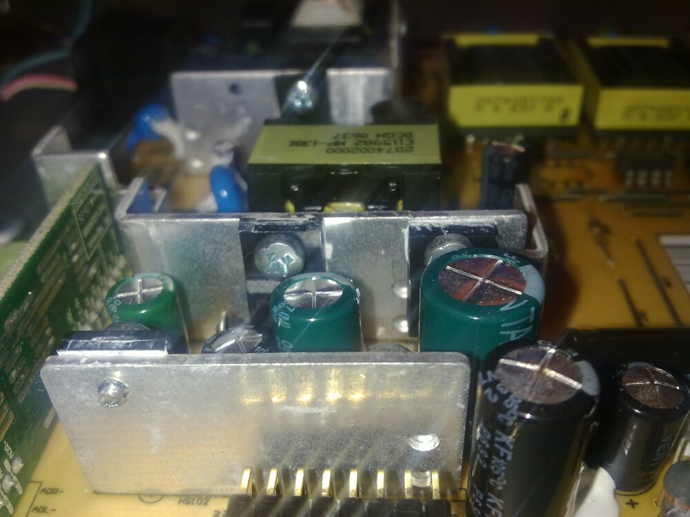

                              Got the Panasonic FM caps from Mouser today. Soldered them in and the monitor seems as good as new again. Hooray! The 12.5 diameter 25V 1000uf seemed to fit OK.
                                Pictures of the lean?
