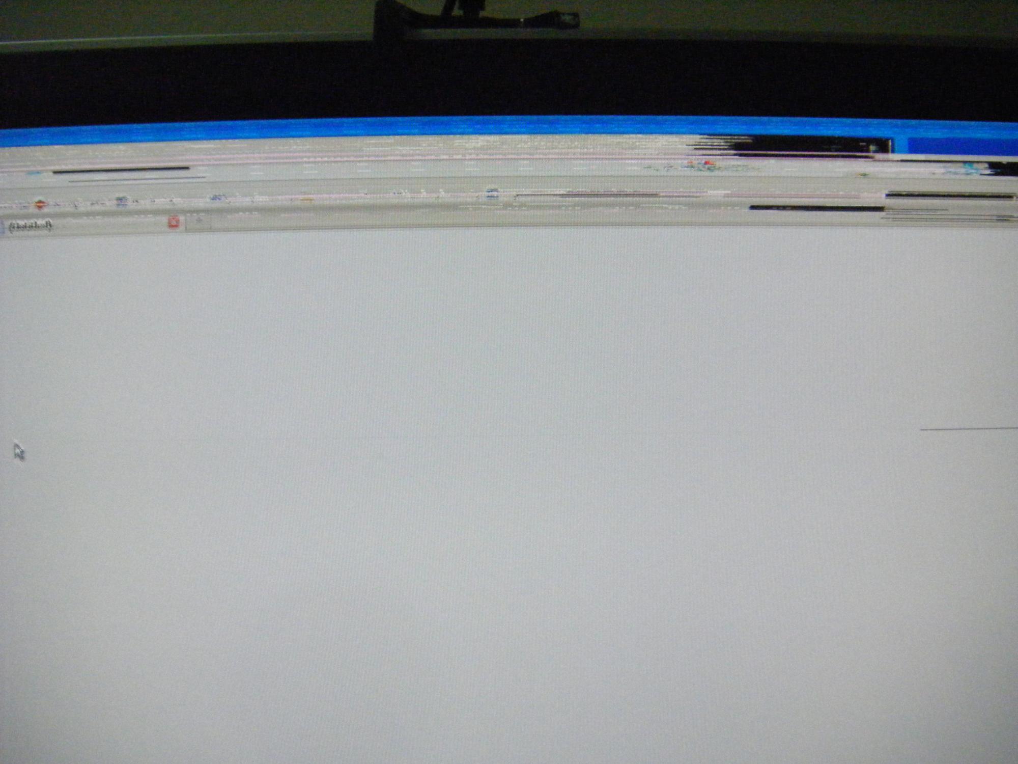

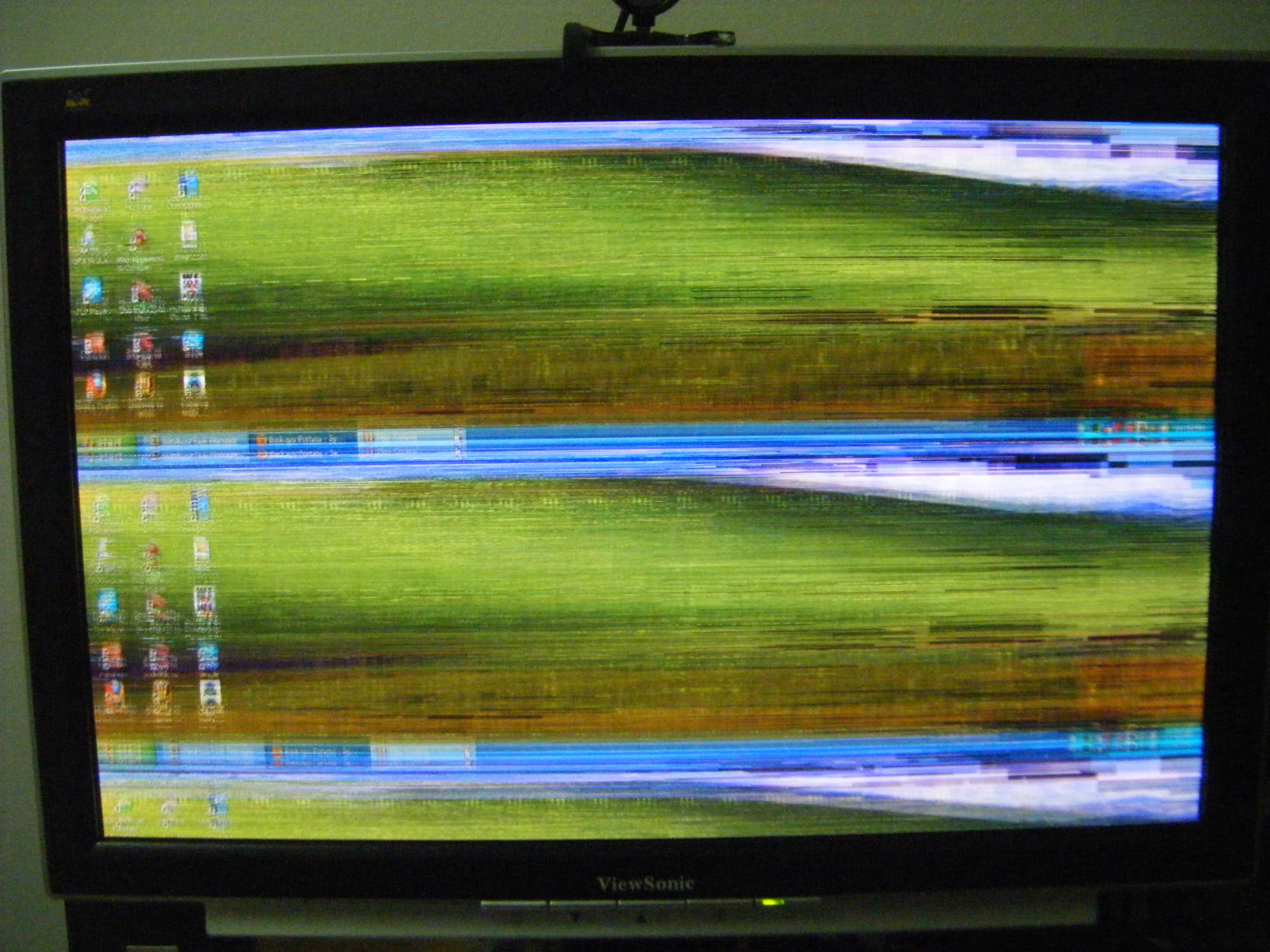

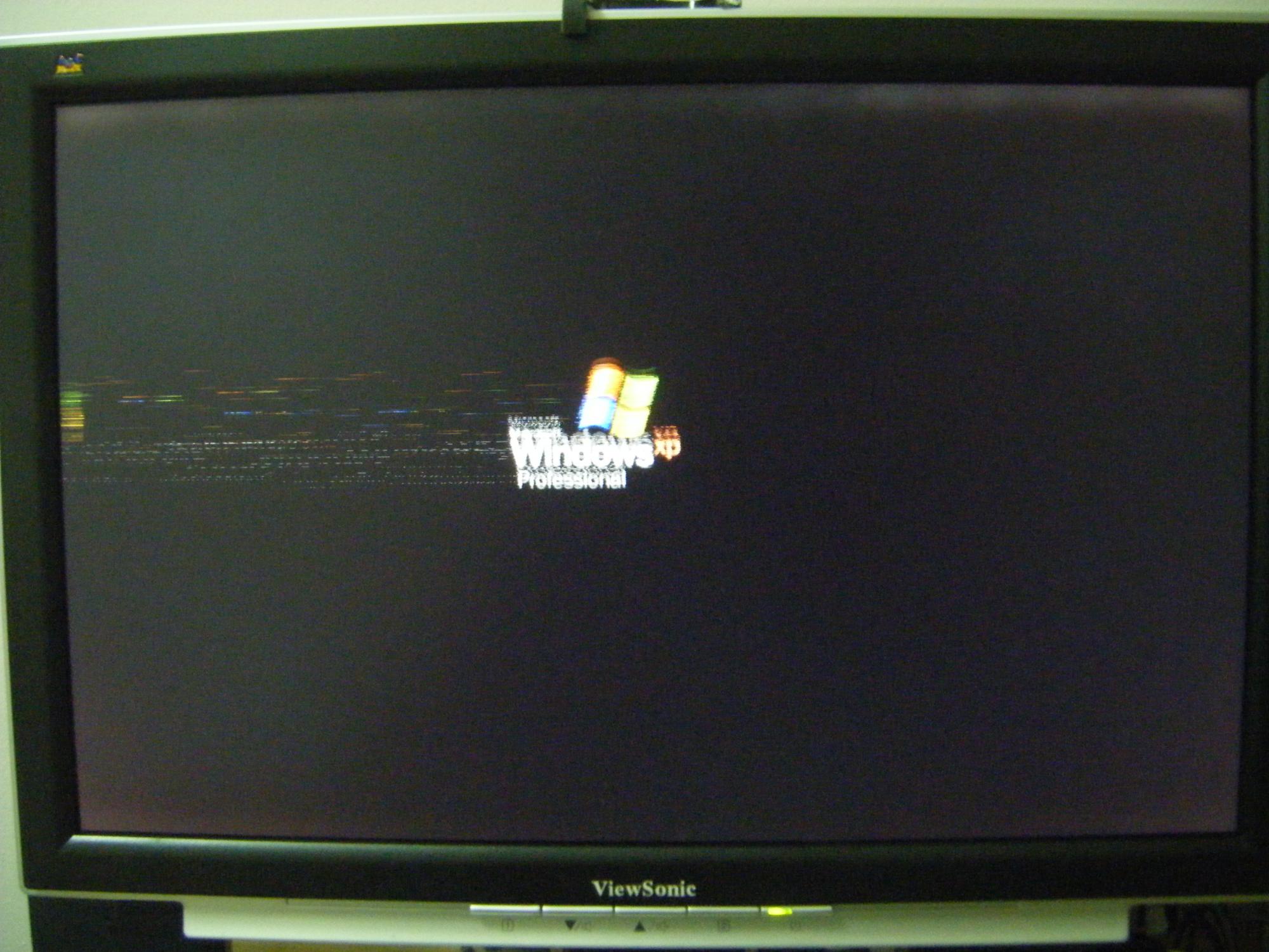

    Hello again, guys..
    I had recapped the power & inverter board of this Viewsonic vx2025wm however during trial/testing it it gave an occasional distorted/fuzzy image. See photos attached. As of now, there is no clear pattern when the defect will come & go.. Sometimes during idle, sometimes during surfing the internet. The duration of the distortion is also not fix (approx range 5-20sec).. As far as i remember all the panel cables , power, inverter, logic card wires are all 'seated' correctly..
    Have any of you guys have this experience before?.. Could it be the logic card problem? Or panel problem? Just to share the sticker on the back of the monitor shows manufacture date is 2006 but when i check using Everest software, it stated that manufacture year for the LCD is 2000?!?!?... ..
    many thanks, as usual, for all your inputs...

    Greetings! Post some photos of the power supply and logic card. If the output voltages of the power supply are good and steady, then:
    1) Make sure video cable from pc to monitor is good.
    2) Reseat ribbon cable(s) between LCD panel and logic card.
    3) Measure the output of the voltage regulators on the logic card.
    4) Caps on logic card may have dried out.

      Next time it starts spazzing out, bring up the monitor's menu. Is it distorted too?

            If it is distorted it indicates the problem originates in the video processor or the panel card. If it is NOT distorted the problem originates in the computer's video card, video cable, or the video processor.
            The symptoms suggest an intermittent connection.

              The menu IS distorted when the image gets fuzzy. However, the distortion is less frequent now.. hhhmm. Do you guys think, that if i continue using it, would i risk burning/corrupting the memory or video processor?

                    & the only intermittent connection i can think of is the LVDS cable/connection.
                    Upon closer inspection, observed that the gold LVDS connectors are a little dirty/stained. Brushed them & a did little light scrapping using the tip of the multimeter on them. Fixed them back & (...SO FAR..) it works great. No distorted/fuzzy image.. Hope it will hold-up..
