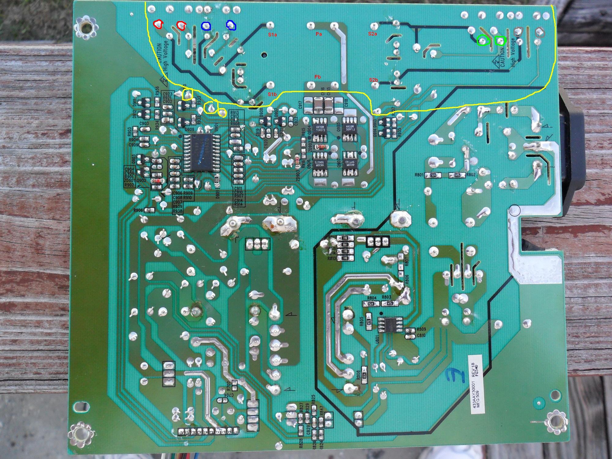

This inverter transformer uses a newer design. Early designs had one CCFL per transformer. One end of the secondary fed the CCFL, usually through a capacitor. The other end of the secondary was either tied to ground or to a current sensing circuit. Later designs coupled the output to two CCFLs by using two capacitors.
This design uses two CCFLs driven from opposite ends of the secondary windings. The return lines from the CCFLs either go to current sensing circuitry or to ground. There are usually a few capacitors to sense voltage, and to tune the circuit.
The best way I can illustrate the difference is the old way was like two flashlight batteries, each with a flashlight bulb connected to the top and bottom. In that design, each battery and bulb set is independent of the other.
The analogy for the newer design would be two batteries in series, and two light bulbs in series. and the light bulbs connected from the bottom of one battery to the top of the other. In this case, they are dependent on the other.
This means that disconnecting one bulb of the pair is not a valid test UNLESS some provision is made to pass current through the open socket. The best way would be to use a resistor. Radio Shack 271-1131 is a 5-pack of 100K ohm .5 watt resistors. They should work FOR A SHORT PERIOD, and are normally stocked in the stores.
This is going to be crude, but what I would suggest is soldering one resistor across each unused socket (I've circled the pins of each socket in matching colors.), then plugging a CCFL into one socket, turning on the monitor briefly and evaluating how bright the CCFL lights. For the first test, I would suggest trying all four CCFLs in turn in the same socket. For the second test, I would suggest testing one CCFL at a time in each socket, with the other sockets jumpered by a resistor. Yes, this will require unsoldering and resoldering resistors. Be careful, the resistors may get hot.

Re: Planar PL1700-BK - backlights go out
PlainBillComment
I'd say little chance of blowing the board. The Radio Shack resistors are underrated for this, they will get warm.
What I'm hoping is you will find one of the two sides will be noticeably dimmer for all CCFLs (bad transformer), OR one CCFL will be noticeably different (bad CCFL or wiring).
