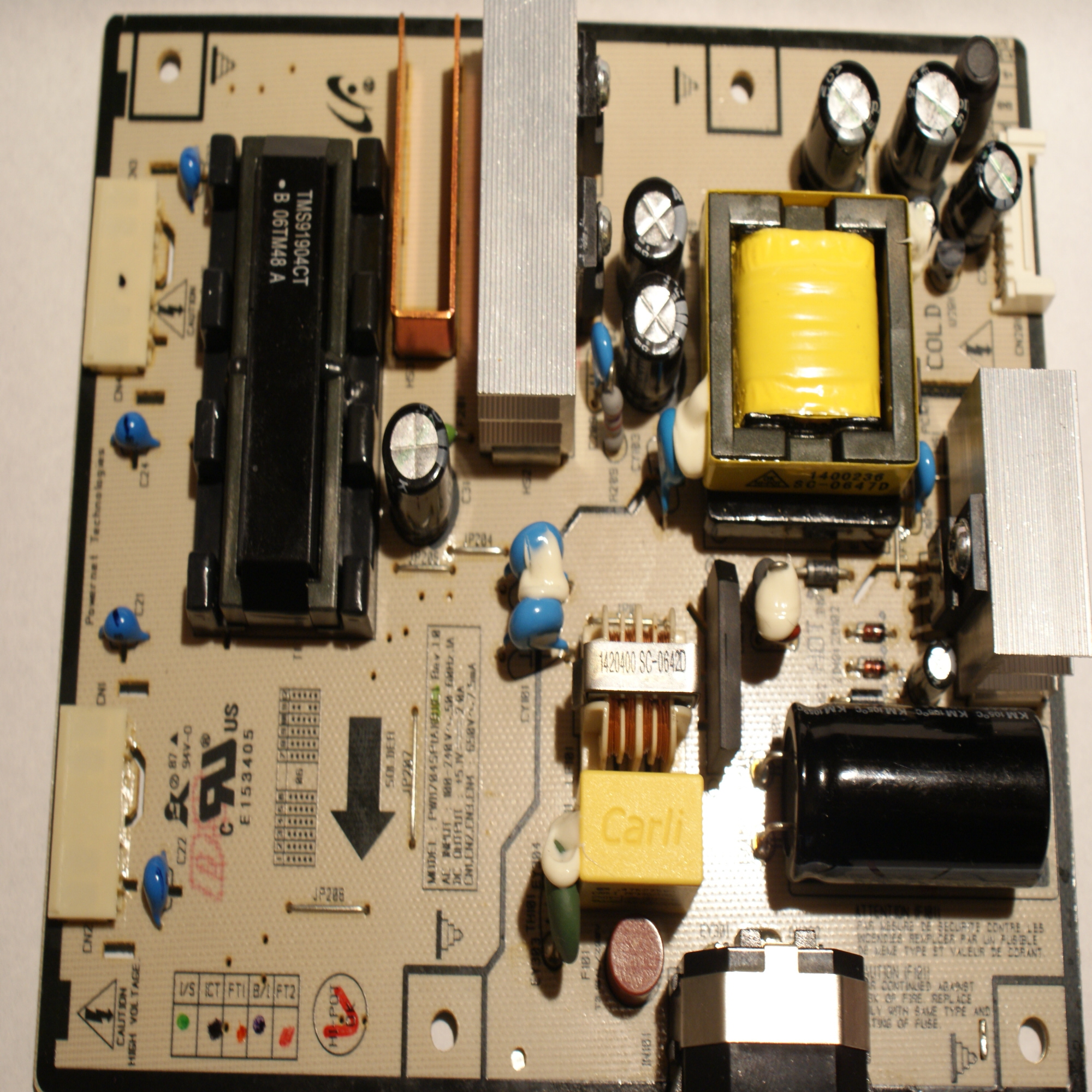

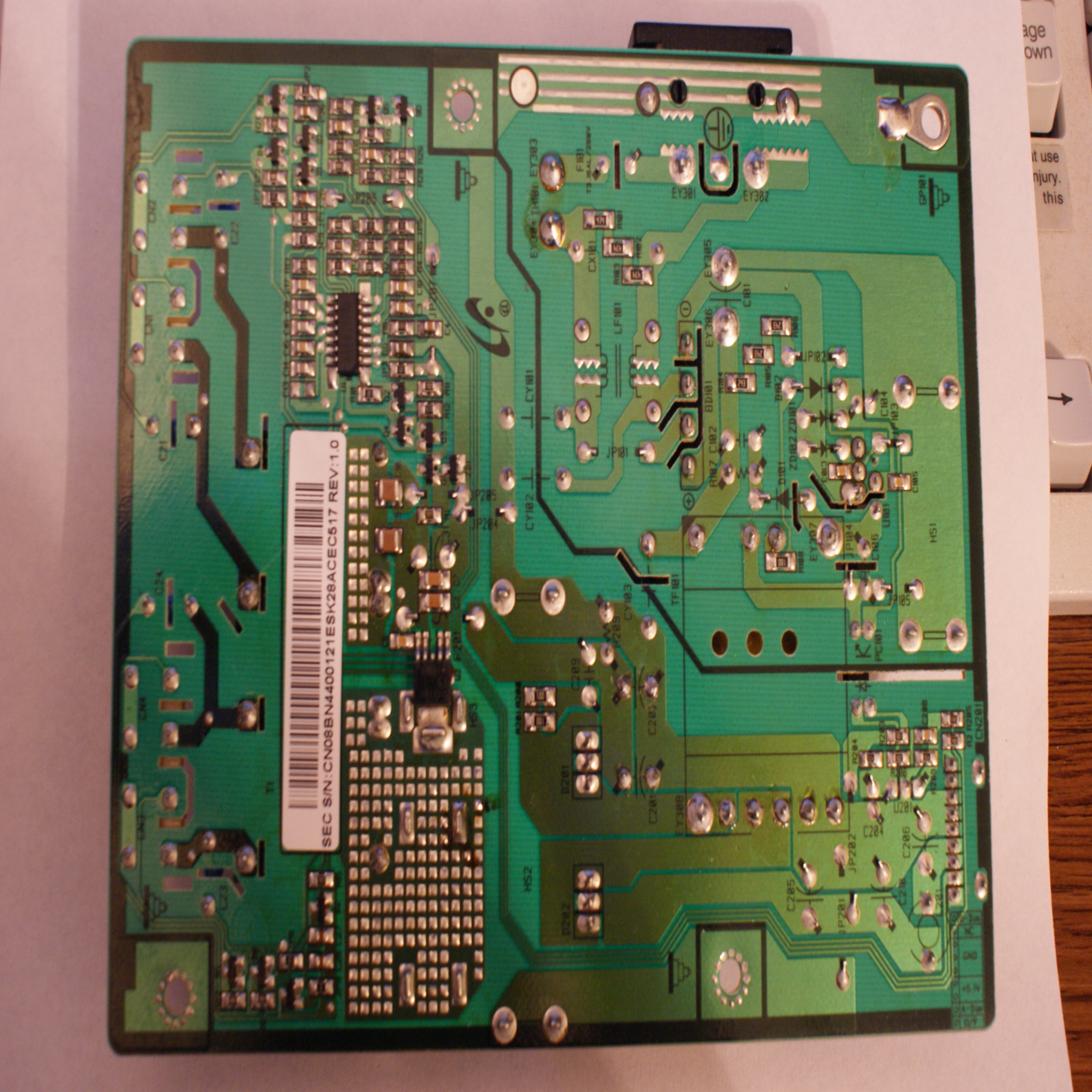

    Request help on a Samsung 932B. I received it as a non working unit. When I went to test it it worked, but then quit after about 5 minutes. I opened it up a discovered that one set of lamps flashes on for a fraction of a second while the other remains dark. I have a a pair of lamps(total 4 ccfl) that I then used to test with the same results no matter which lamps were plugged in , only one plug on the board would flash momentarily. I believe it may be a transformer problem but I am not sure. Thank you in advance. Sorry if photos are not great, help me get better.

    Interesting pictures. It's unusual to see a monitor with oval caps. :
    The symptoms indicate a defective inverter transformer or possibly bad solder joints. I've marked up the picture. Measure the resistance between the pins circled in red and between the pins circled in blue. It is not necessary to remove the transformer for this test.

      Thanks for the response PlainBill. I have read many of your posts on here and I think it is great of you to take so much of your time to share your extensive knowledge. I have re-soldered the transformer connections and measured the points indicated. I read open circuit on all points. I guess next time I will try to keep my picture ratio the same when I resize to avoid the funny oval caps

        That does not make any sense. I seem to have omitted a vital bit of information. Set the DMM to the 2K ohms range. If all pins still read open, try the 20K range. If you cannot get a reading between the two pins circled in red or the two circled in blue on any range that would indicate the transformer is defective. They are available on eBay.

          OK,the plot sickens. I put the test lamps back on thinking there is no way either should work and now one set lights up and stays on. This may be what I experienced on my very first test after bringing it home when it came on for five minutes then went dead. At that time I was not able to set up a connection to see if the display seemed unusually dim. Is there something I can test now that we have it half working? Maybe I am completely confused about the transformer but don't the readings I got of open circuit with the dmm set to the lowest range(400 ohm) indicate that none of the lamps should come on?

            That's the problem. The secondary of the transformers should measure about 1K ohm (in this case, about means somewhere between 700 ohms and 1500 ohms.)

              If I may interject, the OP may be doing the test incorrectly:

              What Plainbill means here is to read the resistance once across the two red pins, and once across the two blue pins and report the results. The instructions could be misinterpreted to mean measure across one of the red pins to one of the blue pins, etc.

                OK, upon further review it has been determined that the resistance across one pair is about 1K and the other is open. I have ordered the transformer(about 10 days from China). I will post when I get it installed. Thanks for staying with me on this.

                    Yet another big THANK YOU to PlainBill. I replaced the transformer and was rewarded with a beautiful bright display and one less monitor in the graveyard.

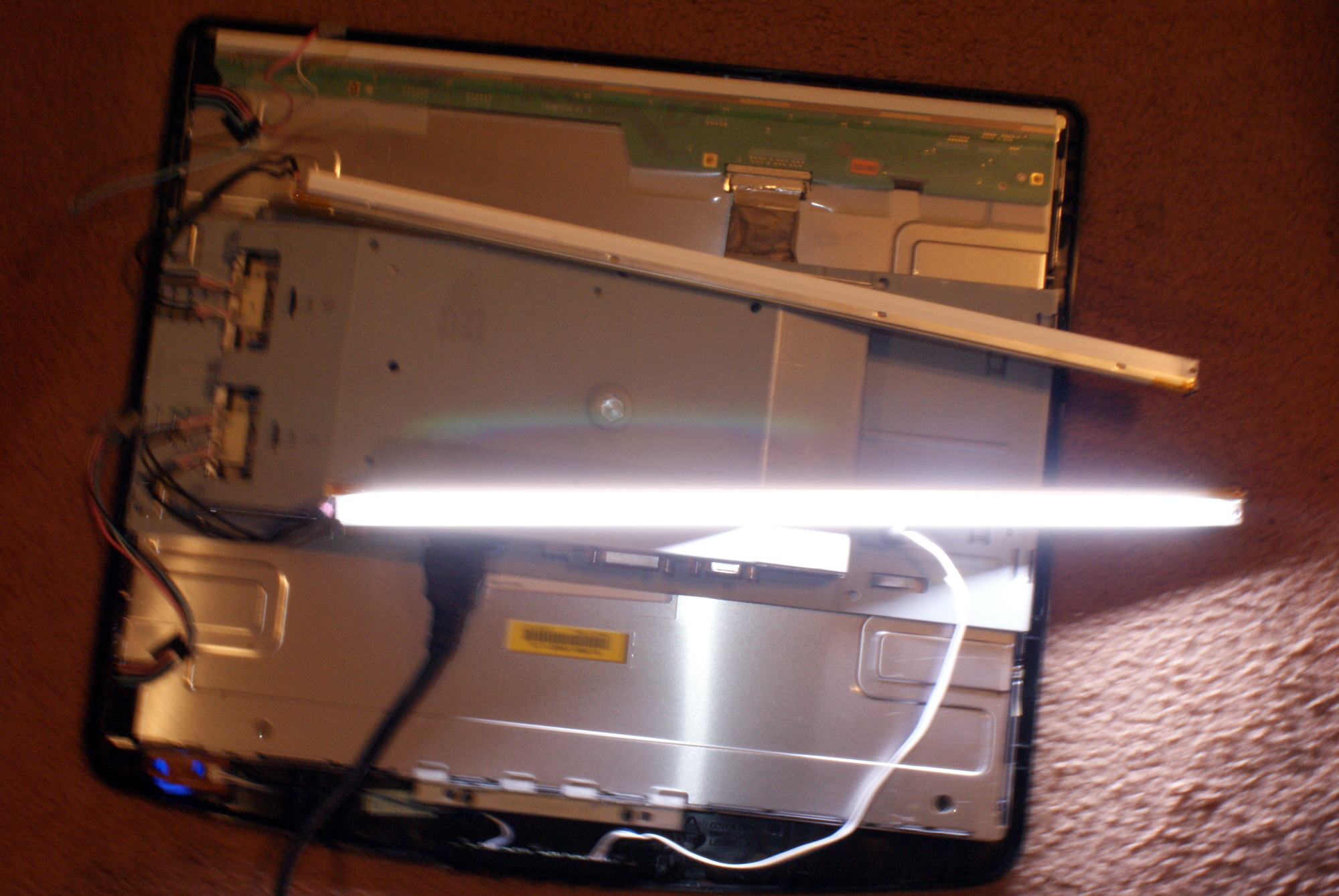

                                  Being a Lab Tech at heart, I couldn't give up on the troubleshooting. Reading other posts about the "flash light test" I did it and I have a picture, but the back light driver has gone South, I am thinking this because if a single BL went out, I would assume I would have a dim picture, ALL the back lights, I assume would mean the problem is in power supply itself, which is what all the posts point to. Thanks to all for the help, most educational.

                                    You have 4 CCFL tubes. It only takes one bad tube to activate the CCFL controller protection circuit, which shuts down the power to the backlight assembly and kills power to ALL tubes, not just the bad one. The question is: do you get a brief flash of light when you try powering on the screen? If yes, you could try substituting a known good CCFL tube one at a time to see if you can get the backlights to come and stay on. Also, check the wiring carefully for shorts.
                                      Like jetadm123 says there have been cases here where the problem was just the ccfl wiring gone bad. See below for examples ...
