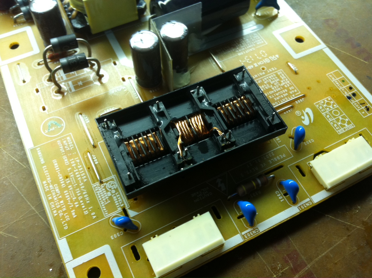

    Ok i have the same problem on my 932B panel...the display shows picture and than after one second backlight shuts down...
    So i have firstly changed all caps,all new and all are the higher value in voltage..
    the ones that was default on the inverter board,all were good...multimeter test
    but the problem remains...
    I have measured two blue point and red point on the inverter transformator..and both of the point were 1K ohm....so i presume its good

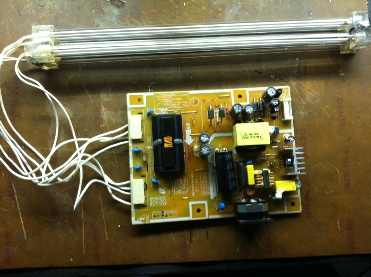

    I have lend from my friend the same monitor and try to figure out are on my panel ccfl tubes gone..but no..i mean i connect his inverter board and the panel works no problem...when i changed video motherboard it works too....
    so the only problem lays on my inverter board....
    I have come to conclusion that maybe the faulty sense circutry is cause to shut down backlight...
    I only think that or SEM2005 or STU309D are faulty....
    the ( U201) SEM2005 i cant found...Is there a substitute controler?
    the ( U202 ) STU309D i orderd so i wait and give it a try with replacing
    is there some other idea what to try
    PS: i didnt say but all other components on the board are all measured with multimeter and didnt finde any burnt or too different reading of value...i have compare values with friends working inverter board...
    Can i circumvent some pins on sem2005 error line to make it work on purpouse...so the sens will be shortened but it will leave backlight turned on

      What brand and series did you use for replacements? It matters in a SMPS application if you used general purpose caps or low ESR caps.
      A multimeter will NOT test for ESR (ohms). You can meausure uF, but not ESR with a multimeter.
      What is the exact reading? It should be 3% of each other.

        The caps i used arent low esr...and they are jamicon brand...maybe not good brand? The original caps from the inverter board wasnt low esr either....
        Ok ill easy replace caps to low esr...do you think that it will correct fault?
        yes to mention i have resolder all posible solder points pins etc...
        Ok i know that multimeter test is not good method to try caps...i can try to measure caps on lcr meter...but if a put new esr than its pointless
        red and blue point value is blue 1,03 kOhm and red 1,06 kOhm

          SMPS applications require low ESR caps. Manufacturers make all sorts of different caps: general purpose, low ESR, etc.
          I don't know if Jamicon makes low ESR caps or not.
          If the caps are on the inverter are the originals, replace them with somethinig like Panasonic FR, FM, or FC (in that order) caps.
          What is 1,03 kohm? Is that 1030 or 1003 ohms?

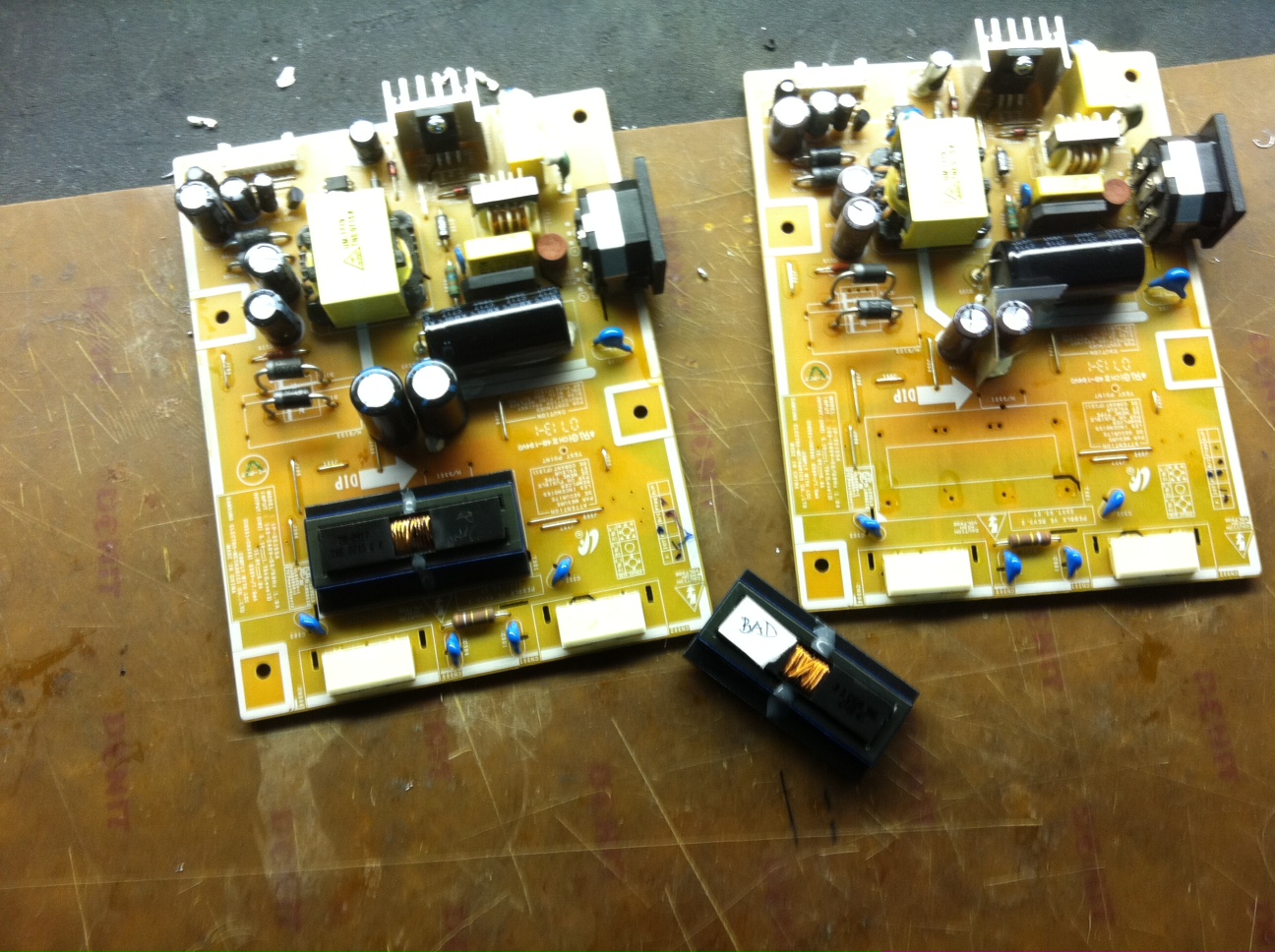

            its 1030 ohm....
            i have tried with another mm...and on friends working inverter board
            both values are 1010 ohm
            and on mine faulty inverter board are 1030 and 1050 ohm....
            will try to change/resolder transformator from working to non working board to see em i geting somewhere
            Djadjo
              Re: Samsung Syncmaster 932B
              I found out that the trafo went bad...one side is lighting the ccfl..and other dont...and then the feedback sens shuts down the whole inverter...
              when i put other but ok trafo...the inverter board works no probl...
              looking at ebay the trafo costs around 12usd...and whole inverter board could be found for 20usd....hm

                If 1010 ohms is the "correct" value, that implies
                1010 x 1.03 = 1040 ohms.
                1050 ohms would just be enough to make it "bad".
                Good job in tracking down the problem.

                  When i measured trafo removed from board one side of secundary was 1kilo ohm and one was 1100 ohm wich was obviusly gone bad...Thanks Retiredcaps for
                  sugestions...I have gone too deep with understanding of malfunction so i have resoldered all ic-s with good ones but the problem was only in trafo...tnx again
