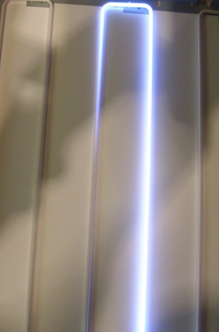

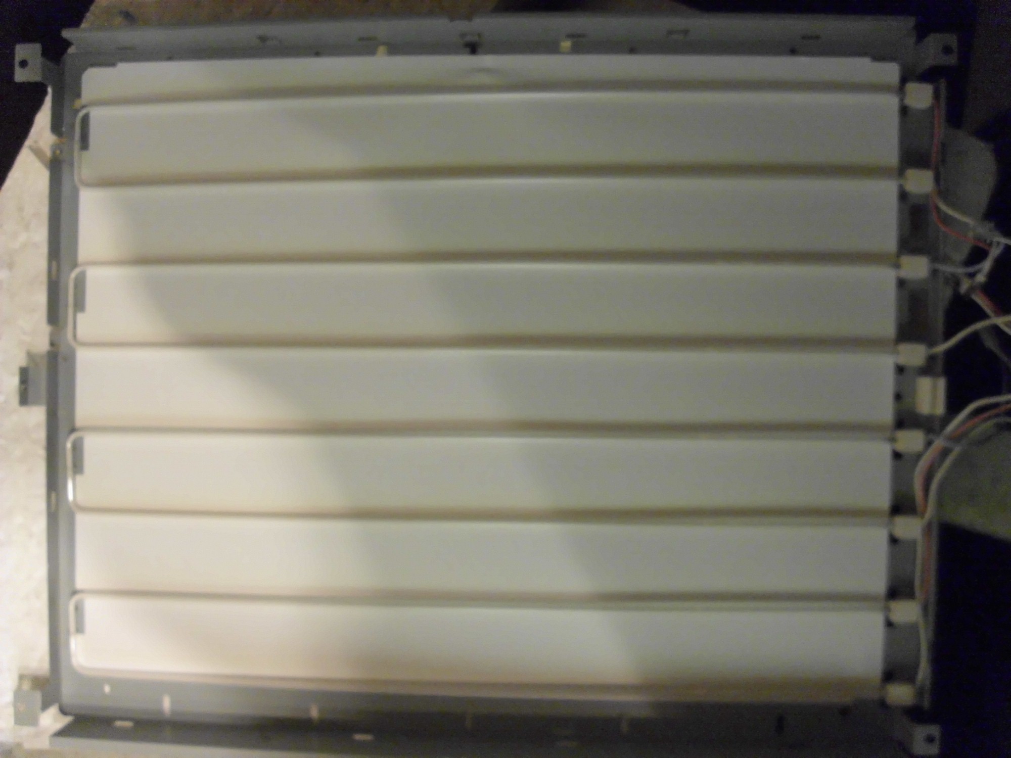

With a typical monitor, there are two backlights, one at the top and one at the bottom of the screen. These mini fluorescent tubes shine into a piece of plexiglass that's etched to refract the light towards the LCD screen.
Playing around with the working monitor, I found that disconnecting one of the backlights, would shut down, as one driver has an open circuit.
I then carefully pulled apart the working monitor and removed one of the working tubes and wiring assembly. This is finicky work, as you have to be really careful not to stress the very thin PC board ribbon cables going between the LCD panel and the LCD driver PC board.
Once I opened the LCD panel that was shutting down, I found the problem: One of the backlight tubes was broken, and once apart, I could smell the ozone created by the arcing HV, as the break was close to one end of the tube, and it appeared that the HV was arcing to the chassis/ground.
It appears that the length of the fluorescent tube is not important. It was a 19" widescreen panel that I pulled apart to get my 'test' light tube. I have since used it as a test light for other 15" to 22" panels, and very quickly I can determine whether the top or bottom tube is defective by simply disconnecting each internal light and connecting my known working tube to it.
In one case I've found Hv arcing from the wiring to the chassis/ground, but in most cases so far the light tube itself is either defective or broken.
Only 45 more monitors to go through....
