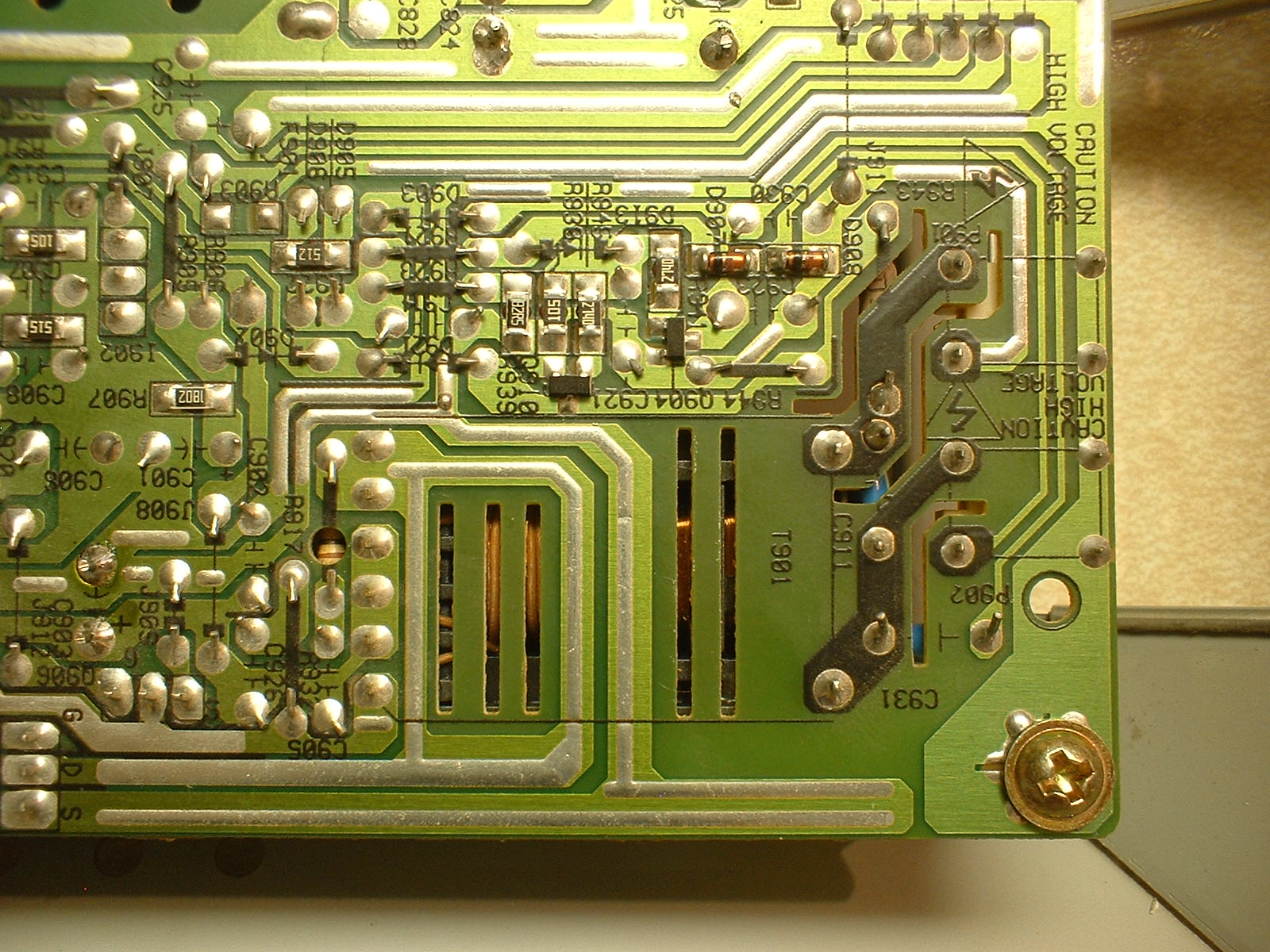

                I still see bulged caps in your first picture. I hope that photo is a pre-cap. The way you have it in looks correct. What did you recap with? I hope you looked up the spec sheets for the "EB" and "PF" caps before you got the replacements. Also check your ceramic littlefuse if it's good. I changed mine eventhough I'm pretty sure the old one was ok. It only added a few cents to the order.
                • junktv
                  • Nov 2010
                  • 3065
                  Re: Viewsonic VE710b
                  Ya that is an old pic i didn't take one of the part side after. No i didn't i guess i should. I used rubycon mcz for the 1500uf/16v and 3 470uf/16v and zl for the 470uf/25v and zlk for the 1000uf/10v. The rest i left in. The fuse didn't look burned so i figured it was good. Plus the monitor kinda worked when i took it apart.

                    Umm, you picked the wrong caps.
                    Rubycon MCZ is definitely not suitable for this application. MCZ is for ultra-low ESR motherboard VRM applications. List me the old cap series and I'll point you in the right direction. My monitor's been fine for several days now. Good picture too for a panel that's not one of the big names.
                    • junktv
                      • Nov 2010
                      • 3065
                      #30
                      All were EB elites and 105C that i took out. I can't find the 470uf 25v data though. The data sheet also says "Extremely low impedance downsize and high ripple current.Suitable for main board."
                      470uf 16v 8x12mm
                      1500uf 16v 13x17mm
                      470uf 25v 10x12mm
                      1000uf 10v 8x15mm
                      I thought it was good to have a higher ripple and lower number on esr?
                          It is but don't go psycho on lowering ESR.
                          -Sometimes- ESR can be too low.
                          The EB Series is rated roughly equivalent to Rubycon MBZ Series.
                          - Crap brands don't always have crap specs too.
                          - You should use MBZ or better here.
                          Rubycon MBZ, MCZ // Panasonic FJ, FL // Sanyo[Suncon] WG // NCC NRSK // Samxon GD, GC // Nichicon HM, HN [with date code 2005 or newer]
                          Panasonic FM that are longer [physically larger] than the original caps might get 'get you there' for the specs in some cases.
                          So what happens if the wrong series are used? Do they just go bad faster or do damage other components?
                          Either or both.
                          "Extremely low impedance"
                          There are no standard definitions for terms like "Extremely Low", "Extra Low", "Very Low", or even just "Low" so those terms only mean what the manufacturer wants them to mean. [That day. .]
                          Probably a custom order cap. [Not super uncommon.]
                          When you can't find one use the data from the nearest one in the table with the same can size. ESR and Ripple follow [are related to] the can size and not uF or volts.
                          - Nearest 10x12mm shows 1540 mA and .026 ohms.
                          [Same as MBZ for the can size but MBZ doesn't go to 25v.]
                          A good replacement might be the Panasonic FM in 10x16mm.
                          It is rated for 1790 mA at .026 ohms.

                                            On opening up the monitor and looking at the PCB the usual suspects showed their heads so I have already replaced all the electrolytic capacitors.
                                            The other issue that was reported with this monitor was the fact it took ages to start displaying anything after pressing the power button.
                                            What component(s)...
