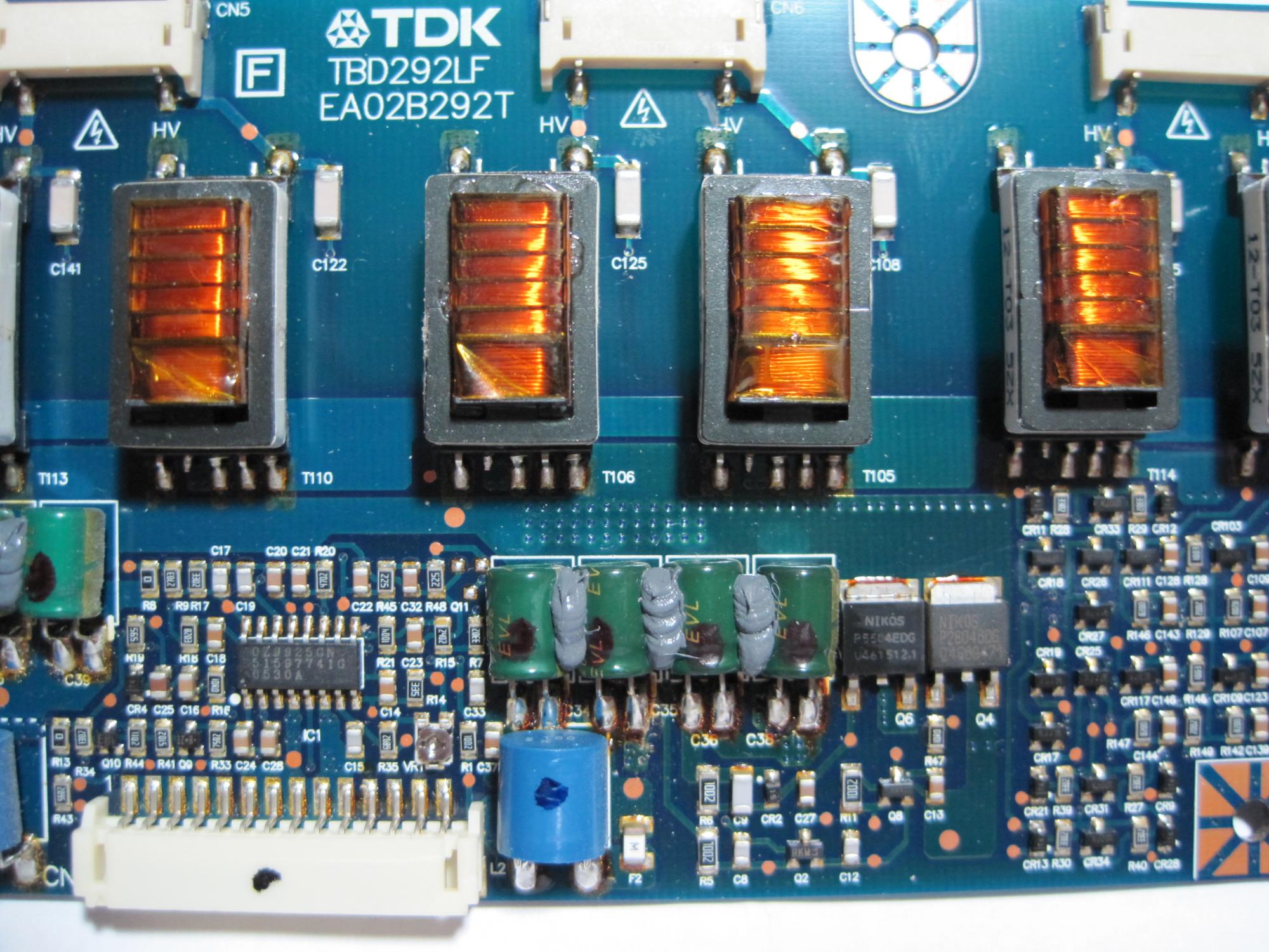

                    Now that the monitor is open I can see the three circuit boards....the main board...the power board and the inverter board. I do not see any caps exhibiting bulging or leaking. It does look like the caps on the inverter board board have been replaced because the soldering looks like hand soldering rather then machine soldering.
                    Any suggestions as to where to go next?

                      on the new caps is the solder touching each other?

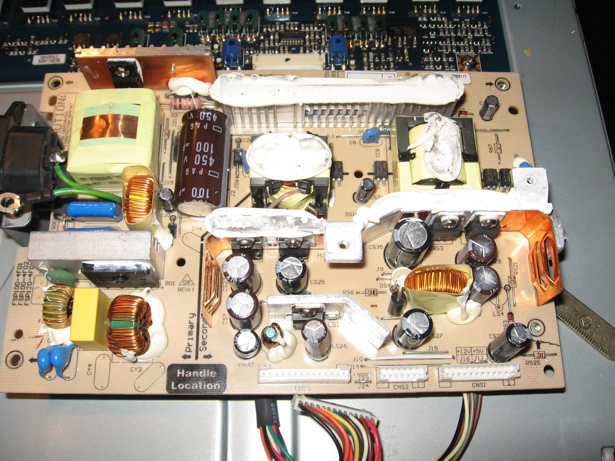

                        Take a picture of the power board with the metal plate off of it. There's lots of stuff being hidden under there.

                          Q3 and Q4 on inverter board look like they have got hot

                            nope....even though it looks close, my meter says they are not touching.

                              Q4 & Q4 on the inverter board look good...no evidence of ever getting hot

                                I would change the ten caps they have been off but they dont look new

                                  Here are two pictures of the Power Board with the cover removed

                                    You have the 'Two seconds to black' problem. Possible causes bad CCFLs, bad wiring to the CCFLs, bad caps, bad transformer, bad drivers, etc.
                                    Tentatively we will assume the caps are fine. I would like good sharp pictures of the inverter, top and bottom. Also, what is the part number of the IC directly above the connector?
                                    PlainBill
                                    • Mike_S456
                                      • May 2010
                                      • 22
                                      Re: Can't seem to open Acer AL2416W case
                                      The IC directly above the connector has 3 lines of numbers stamped on it
                                      First line: 0Z9925GN
                                      Second Line: 51597741G
                                      Third line: 0530A
                                      I did not take any pictures of the back side of the inverter board because the board is a surface mount board. It only has circuitry on the back, no components or thru holes
